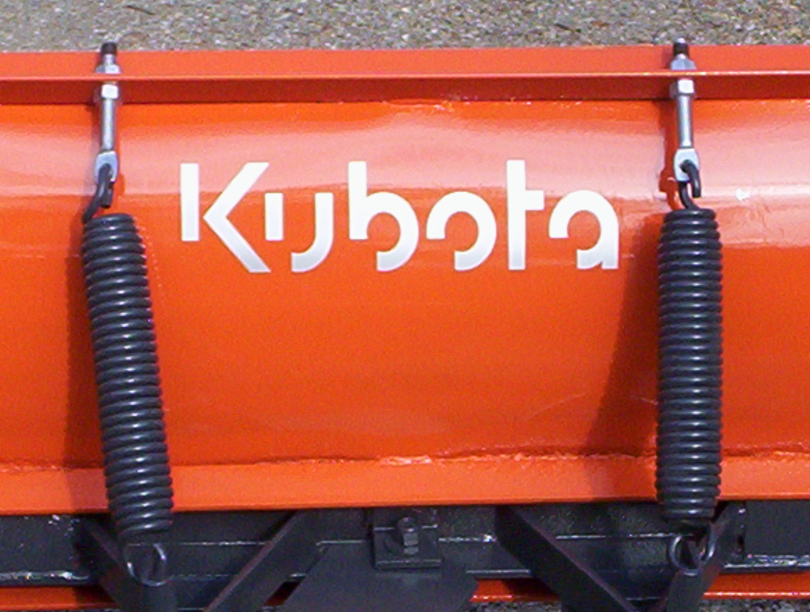

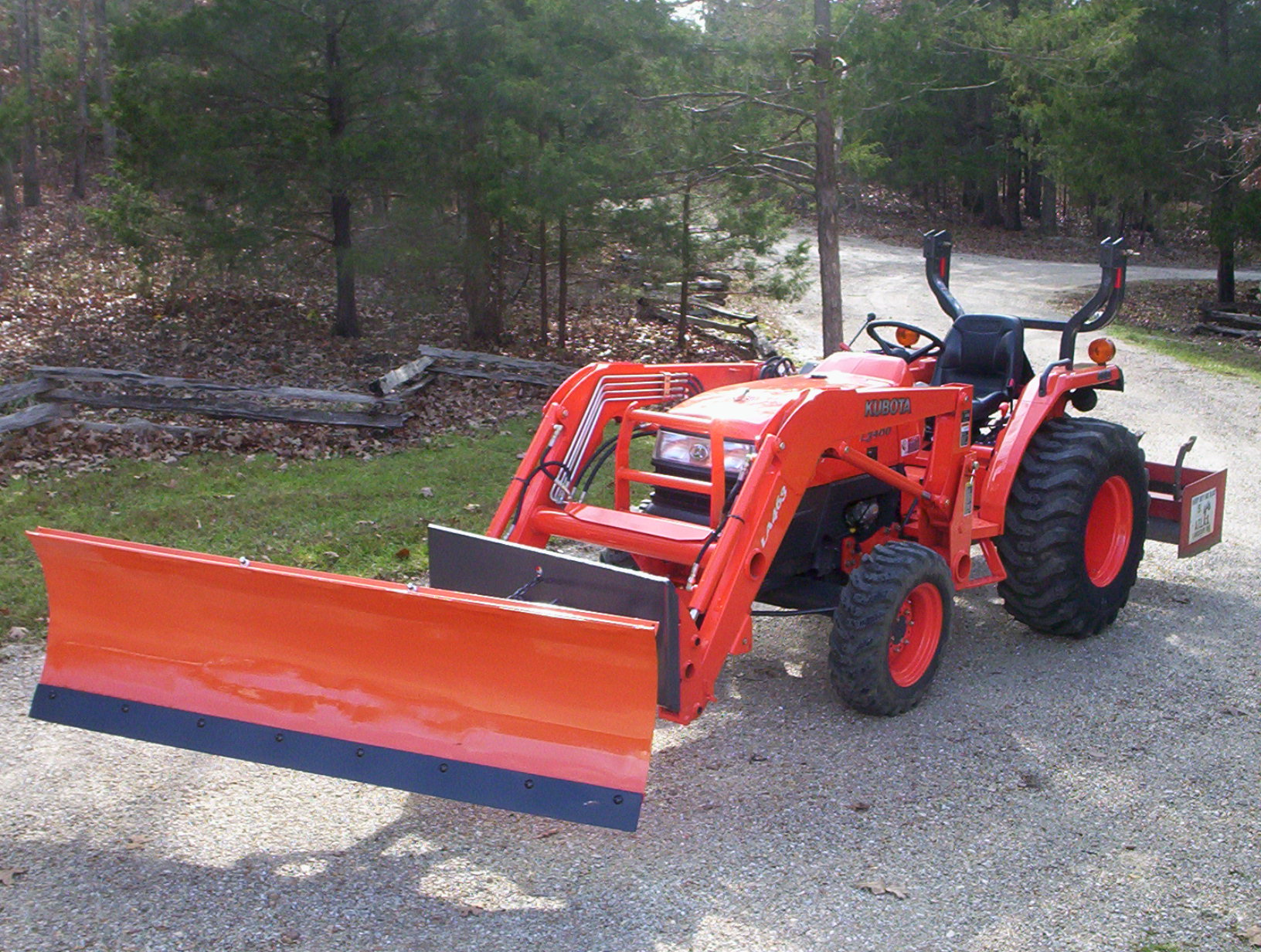

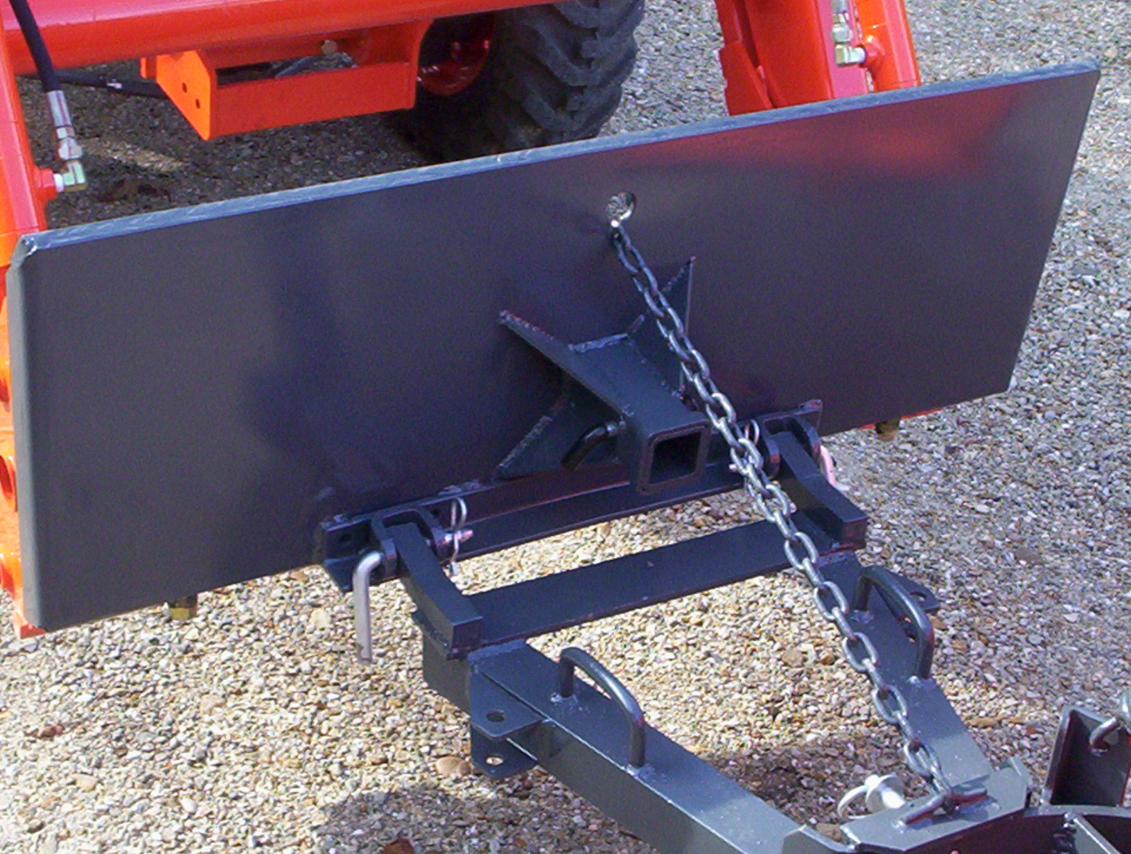

Heres my L3400 with a old Meyer 6 1/2' blade. I bought the plate off ebay and welded on the plow mounts along with a receiver hitch. Very handy. Plan on adding power angle to it sometime in the summer, when its warm!:D

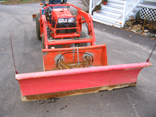

Nice set up...I didn't want the hassle of having to swap between the bucket and the blade so I just welded to plow attachment inside my bucket. Plow the snow. drop the blade and then stack the piles up if needed...
waiting for my rear remotes to arrive to add power angle as well..
