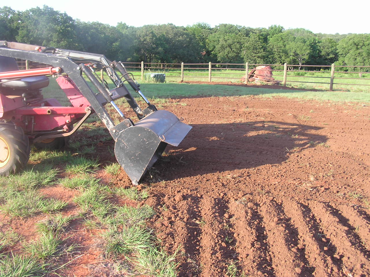

I backed dragged with the loader in float and the 42" bucket.

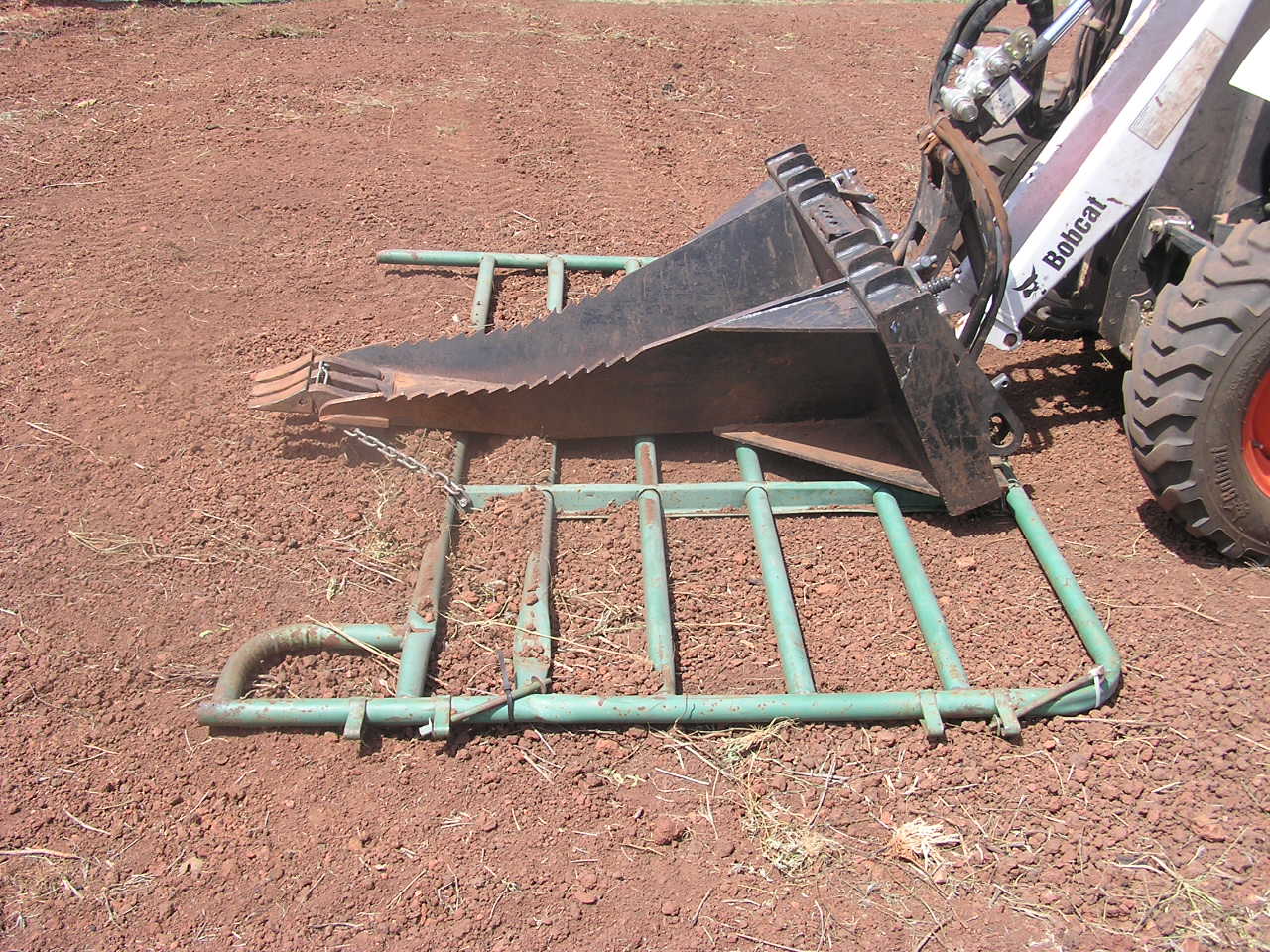

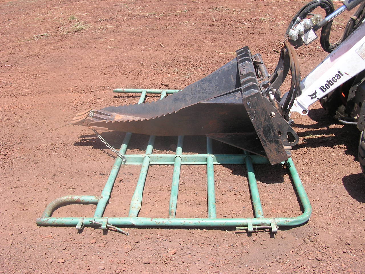

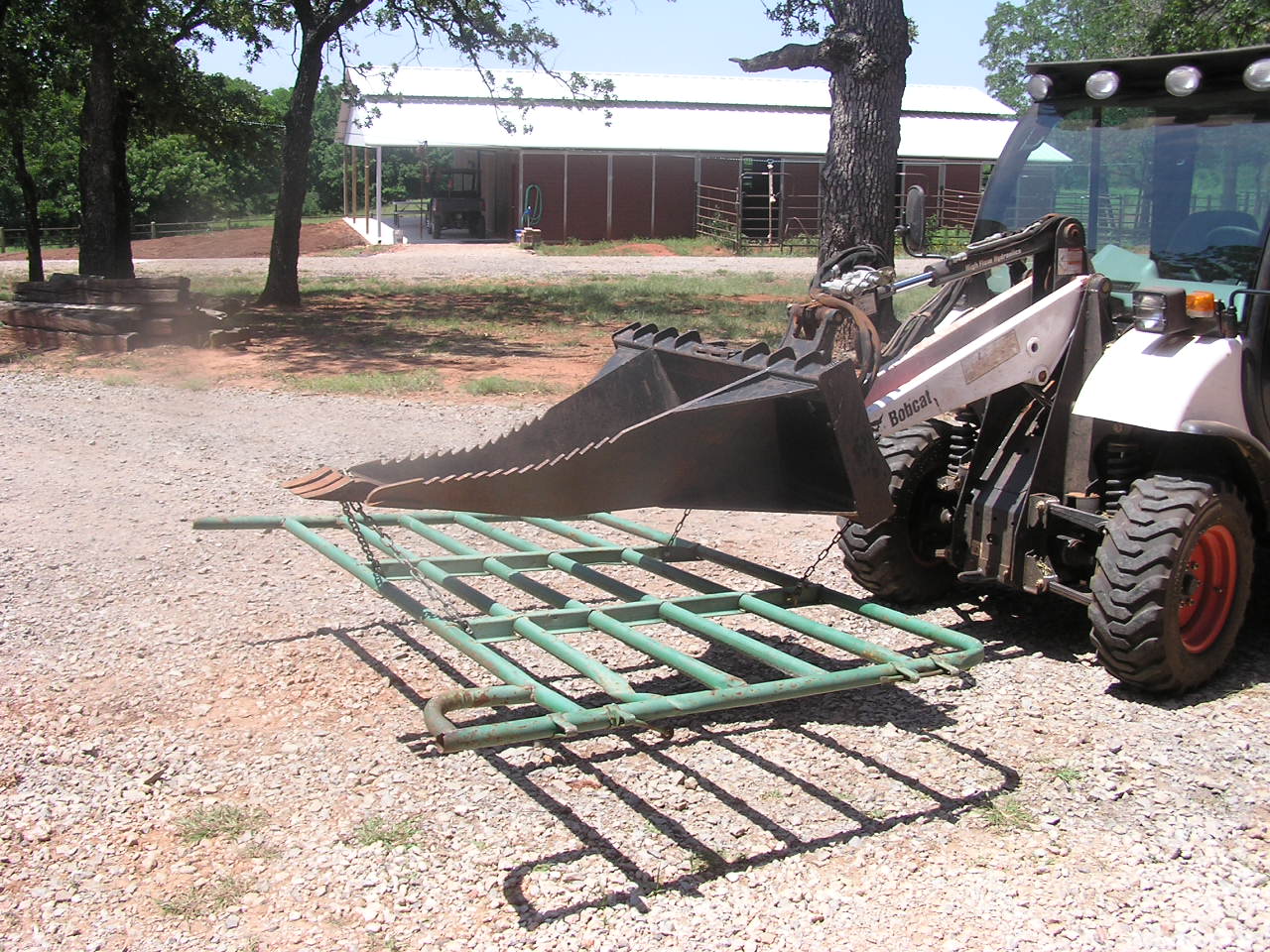

I have been thinking a lot of using a chain link fence piece to do the final smoothing. Also thinking about using a 2x12x12' to rid the lawn of low spots. Maybe attach it to the FEL to back drag a 12' area to make it really flat. We'll see what works. Thanks again.
That reminded me of my pulled from the scrap pile land plane. :)
