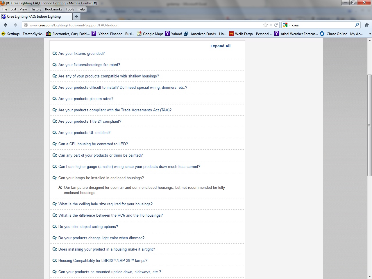

i have glass enclosed fixtures in many rooms. most are 2 lamp units. The glass totally encloses fixture.
The lamps in question state "DO NOT USE in an enclosed fixture" or something to that effect. I mean what the heck.
heres the info from cree website...bout 1/2 way down page
