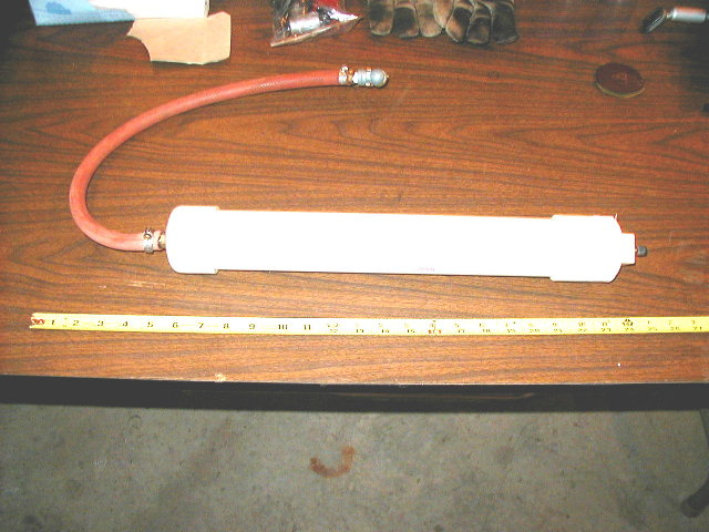

Nah..... just salty water.... like swimming in the ocean...
I think it was the concentration that got me!!! Yecchhh!
Glad I checked it though..one rear tire is loaded, the other not. I've called the dealer I bought the machine from...they'll take care of it, but I got to get the wheel to them...
However, they use windshield washer fluid, not CaCl.
So, reckon I'll do one of three things:
1) Pull both wheels off...down to the dealer..get 'em filled.
2) Call a company to come fill them (not too many in York County, PA...surprisingly!!)
3) Fill them with windshield washer fluid/water myself.
I'd like to do (3). Since a few of y'all have done this..Bird!! Ya listening???), is it a job that can be reasonably well done by one guy (maybe assistance from wifey)?

   / How to tell if wheels are loaded #17
Roy, there's been a lot of discussion about the little air/water adapter valve you can buy for less than $10 to hook a water hose to your valve stem, to just use a garden hose to put water in. I put two gallons of antifreeze in each of my rear tires with the gadget shown in the picture, then put the water in, but I was using home made tools for both. For windshield washer fluid, I think I'd probably buy the air/water adapter and use it with one of those little drill powered pumps. And yes, I think it's an easy enough one person job, but of course, I've worked on tires off and on all my life./w3tcompact/icons/wink.gif
