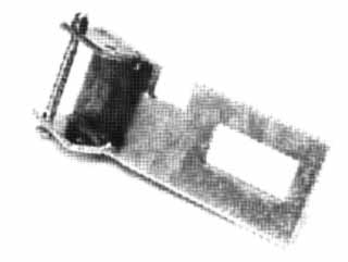

Get a drawbar lock..........cost $20.00.
Keeps the drawbar from pivoting.

That would be great!!!! I was at Agri-supply today and didn't see anything that resembeled that. Where could I get one from? thanks again.

The drawbar locks work great but all the ones i've seen will not fit on the shorter BX lift arms because the check chain connecting point is in the way. Thats why I did the angle iron trick. It also does not get in the way so It pretty much stays on mine unless i need to hook something on the 3-pt. Their are some homemade 3-pt reciever ideas if you search under customisation

Do a search on "Drawbar Lock" on the web. <A target="_blank" HREF=http://www.unionfarmequip.com/store/linkage/drawbars.html>Union Farm Equipment</A> is one place to order from...$19.62. But as has been mentioned, may not work on the shorter arms of the BX 22.
