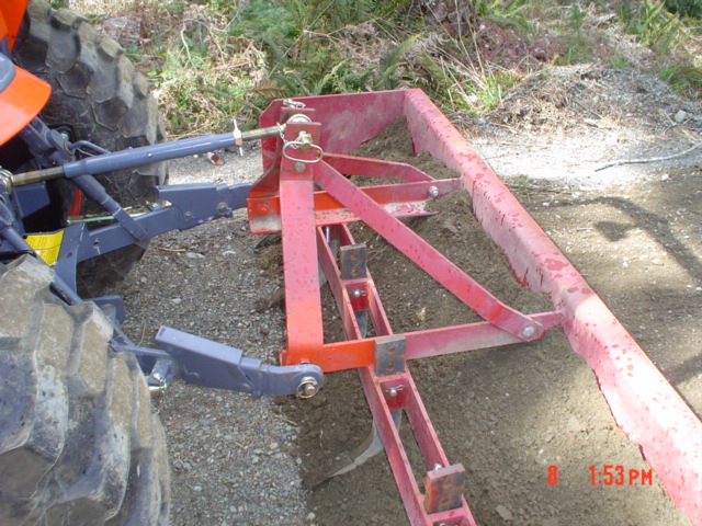

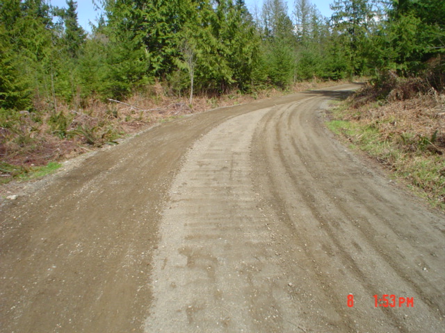

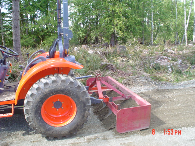

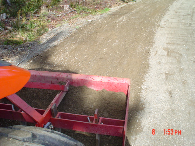

I have had my tractor and boxblade for 3 years now. I maintain our private road that is about 3/4 mile long. Most of it is the natural soil/gravel. As others have suggested just spend some time playing with it. The box blade is a 6 ft and the tractor is 35 HP. :)

Just filling in the low spots with loose material is not going to do a whole lot of good long term if you don't loosen up the surrounding material.
+1 to that. Same with potholes... just filling them won't last.
Also, I've had better luck with our road by planning for drainage... either a crown or some slope or both. If you grade the road level and flat, it lets water accumulate in even the slightest low spots, which eventually become potholes. Getting rainwater to drain gradually minimizes the ruts and potholes, but it still needs attention 2-3 times a year.

The road does get slick and pretty sticky after a rain. I stay off it for a day to 2 after a rain.
