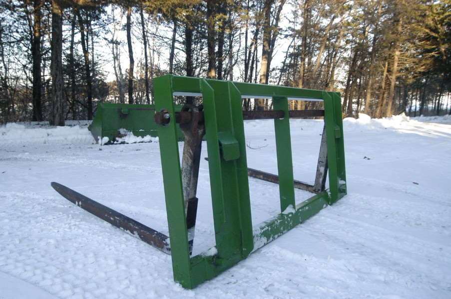

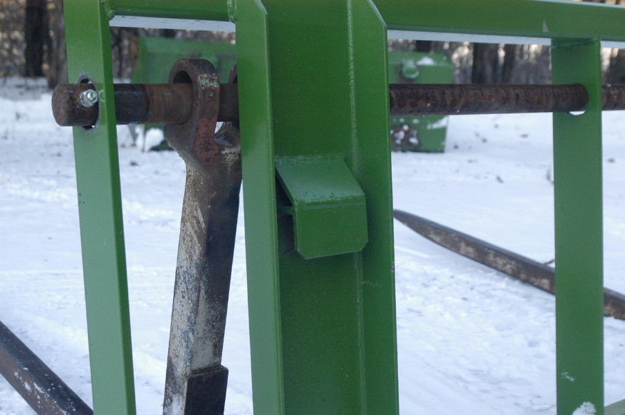

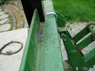

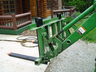

Yes, it can be that easy, or you can make your own easy enough with CAT3 pins and angle iron like the pics below. Post a picture of the JDQA up against the rear of the forks and I can be more specific.
