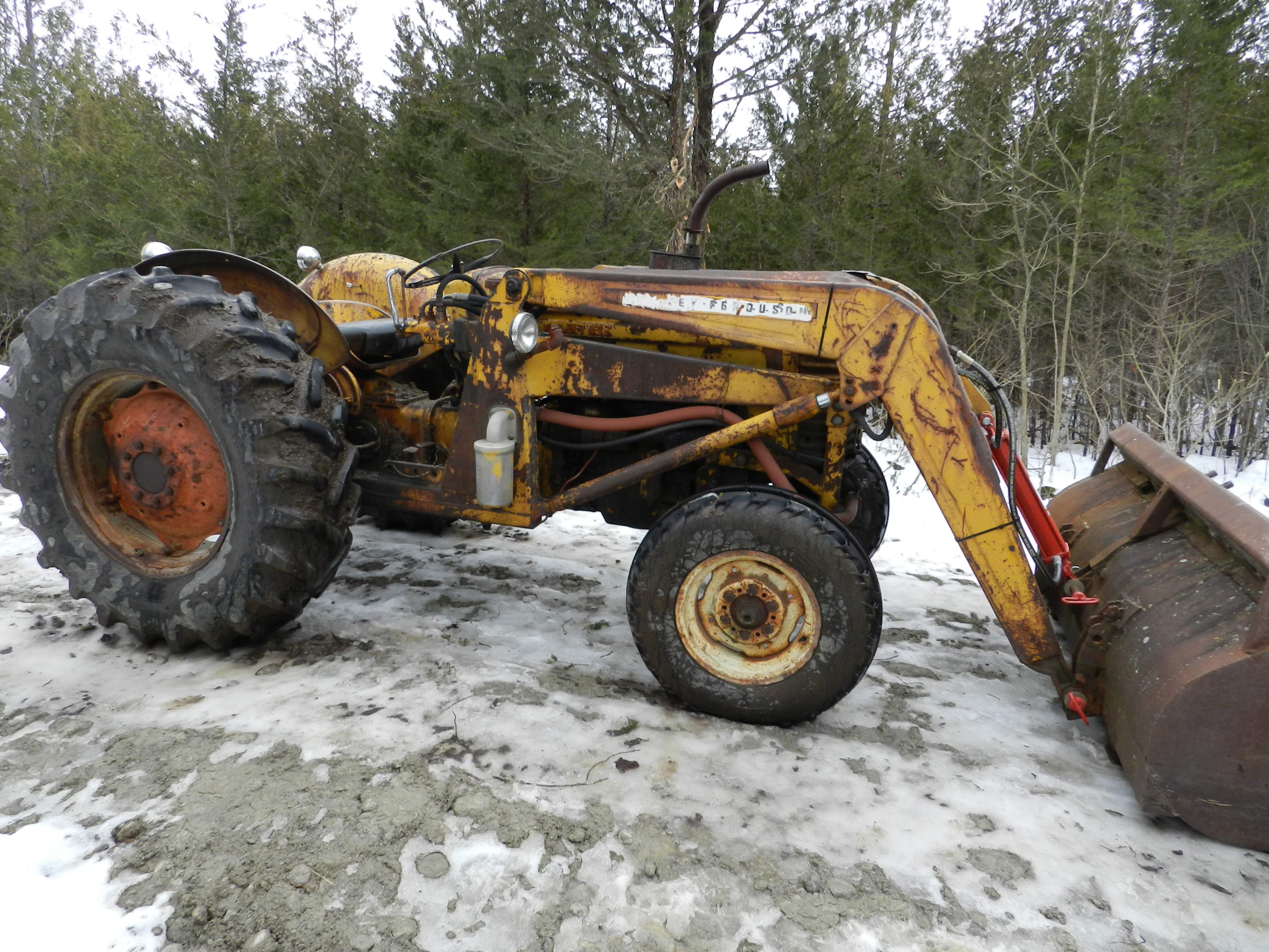

Hi all, I have a MF65 industrial with a front mount hydraulic pump for my FEL. Is there a way I can either use some sort of diverter or a valve with power beyond to use the hydraulic pressure for rear remotes? This pump would be a lot quicker for lets say a log splitter, than the internal lift pump and taping off it.
Any help is appreciated.

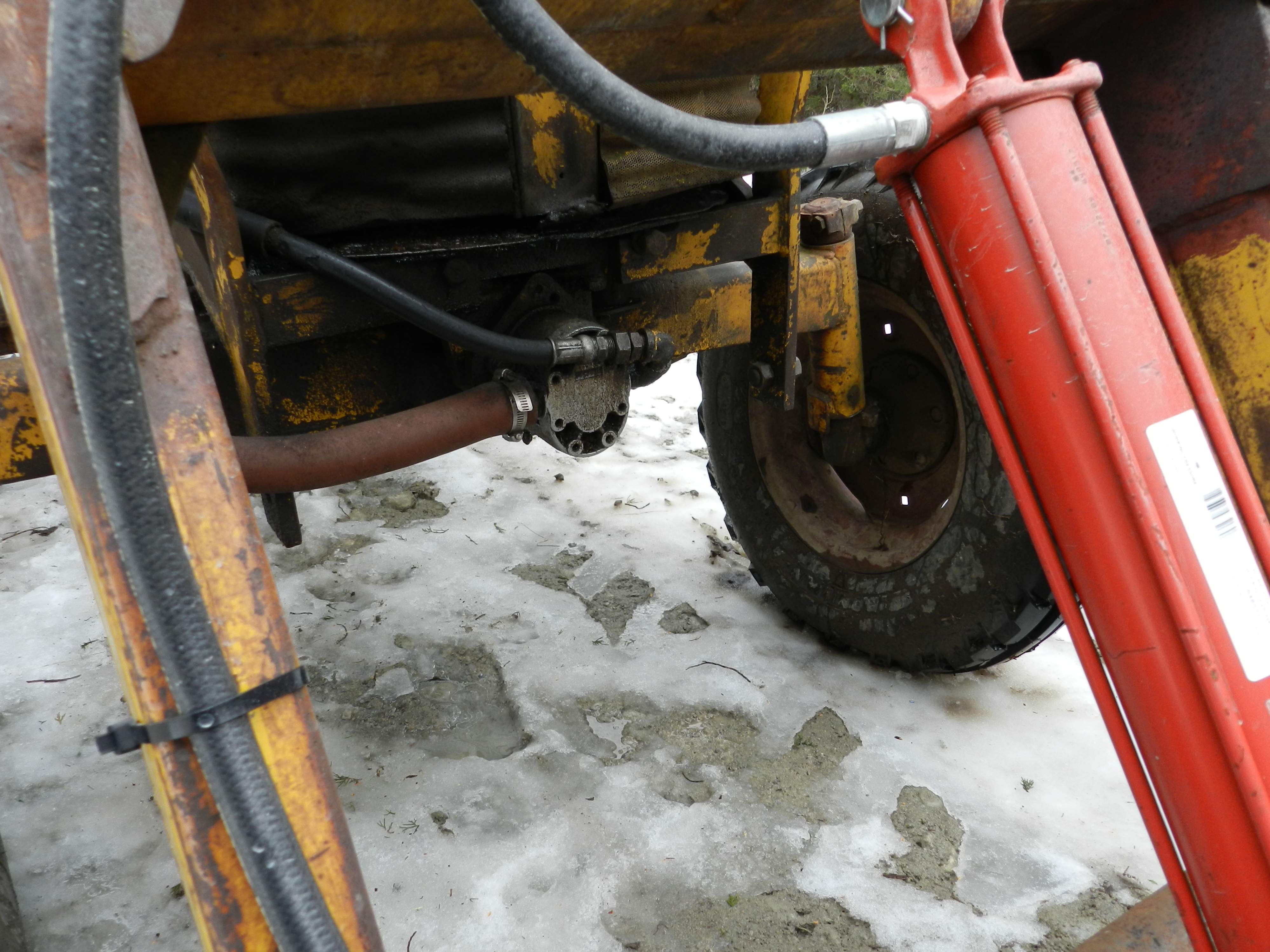

Yes the front pump at this moment just operates the FEL, the lift arms have their own pump. Right now the front pump feeds loader controls, which have double acting cylinders on the lift and dump. when fluid returns to the controls it goes into reservoir then the pump grabs fluid from there. The reservoir is in the right hand side loader arm. So if i understand correctly (new at this) if i put a double acting (so i can go forward and reverse) control valve with detent (so i could if i want continuously run something) and power beyond which would then feed the FEL. This would work and I wouldn't lose any loader capacity or function?

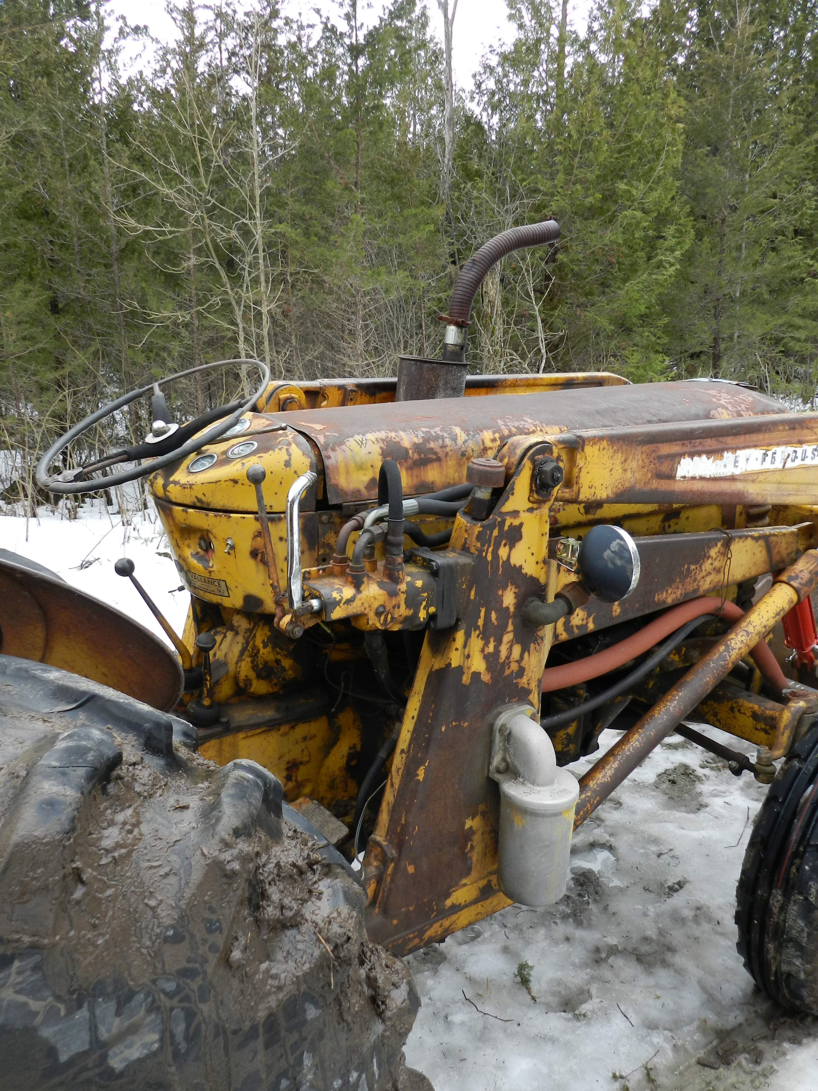

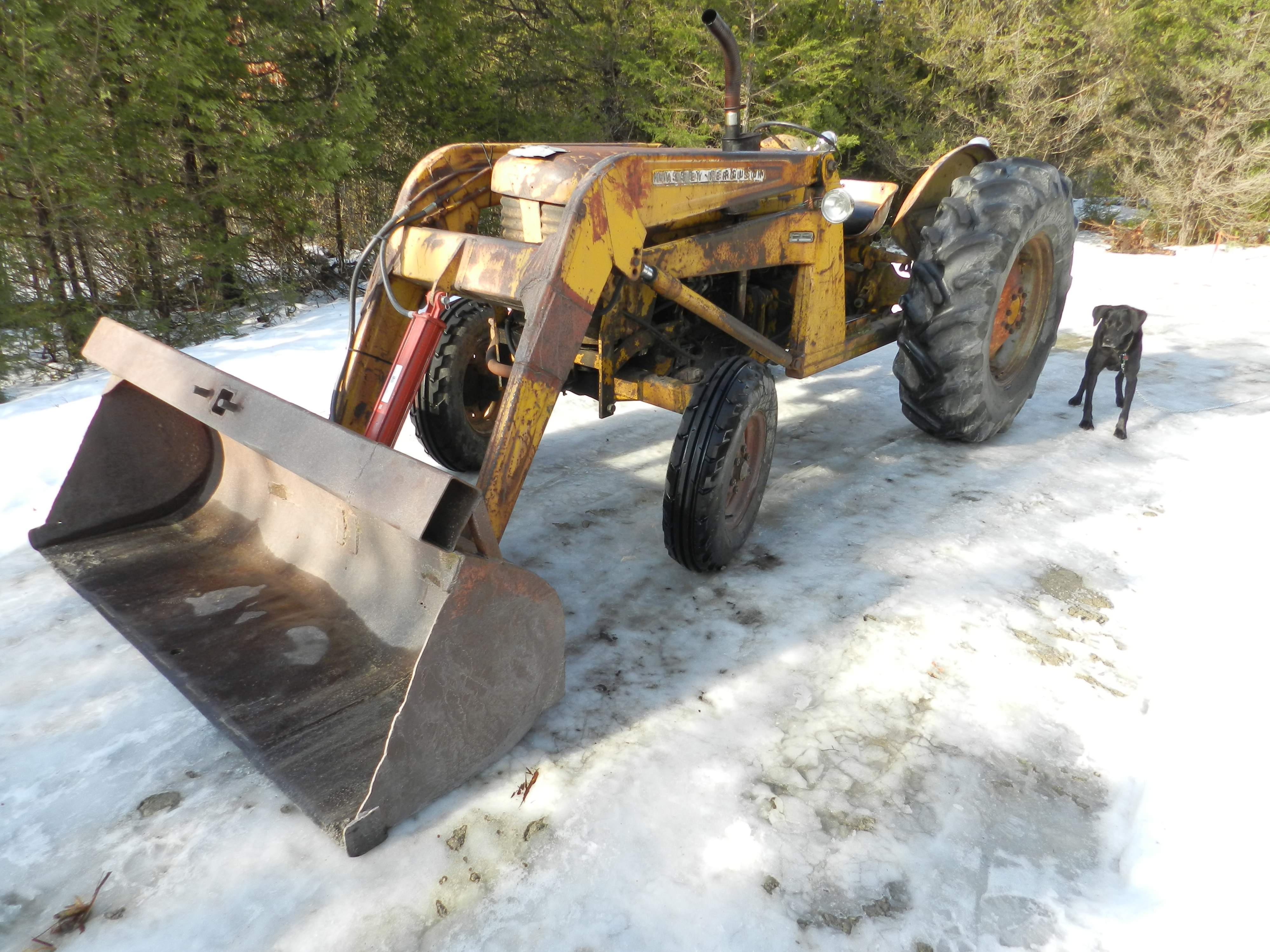

Any chance you could post a few more pictures of your tractor? It looks a lot like the "Industrial 35" that Dad used ot have (had a 50HP perkins under the hood, the same front axle and a similar loader, frame looked the same but his had 2 bucket cylinders)

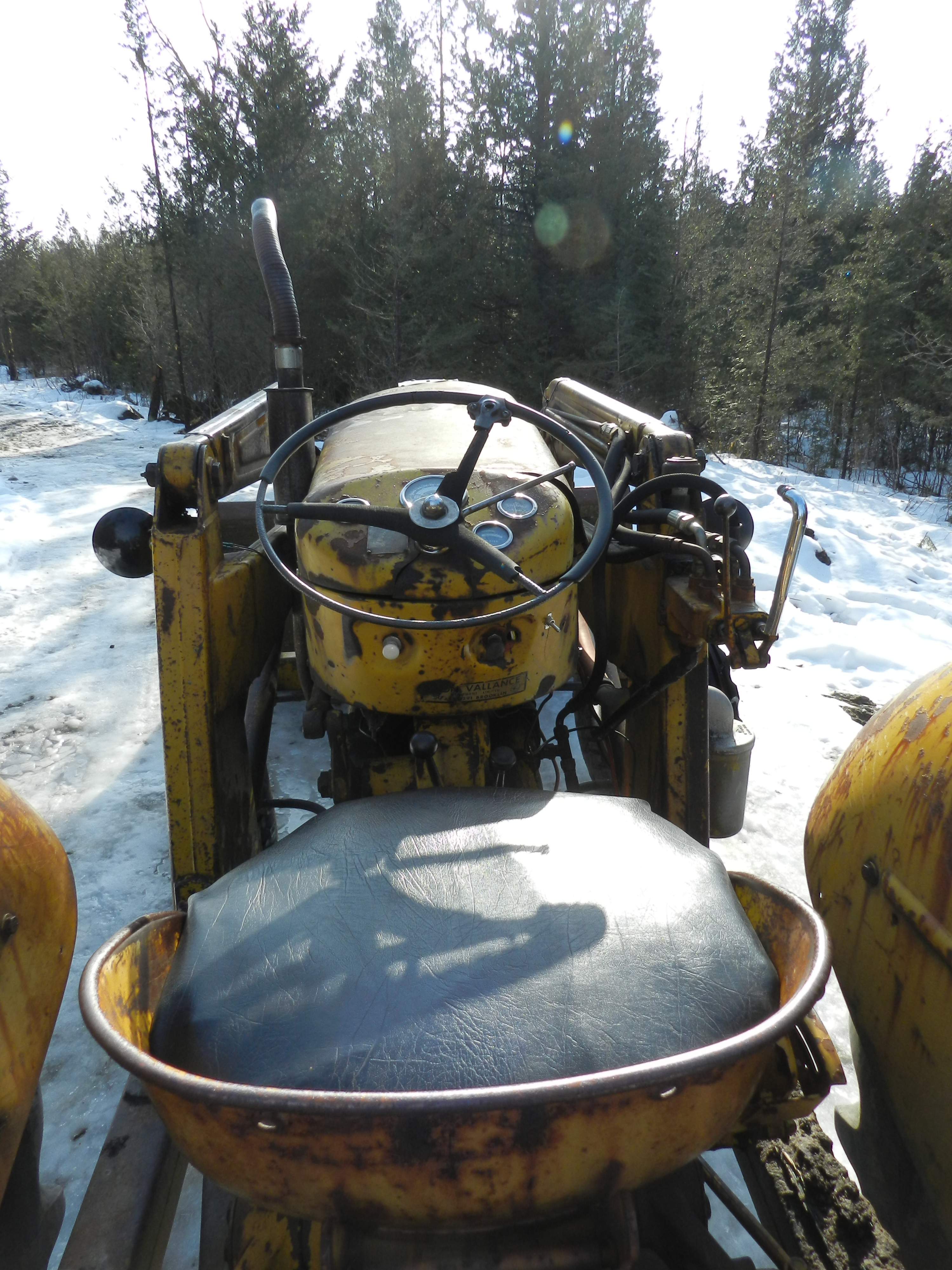

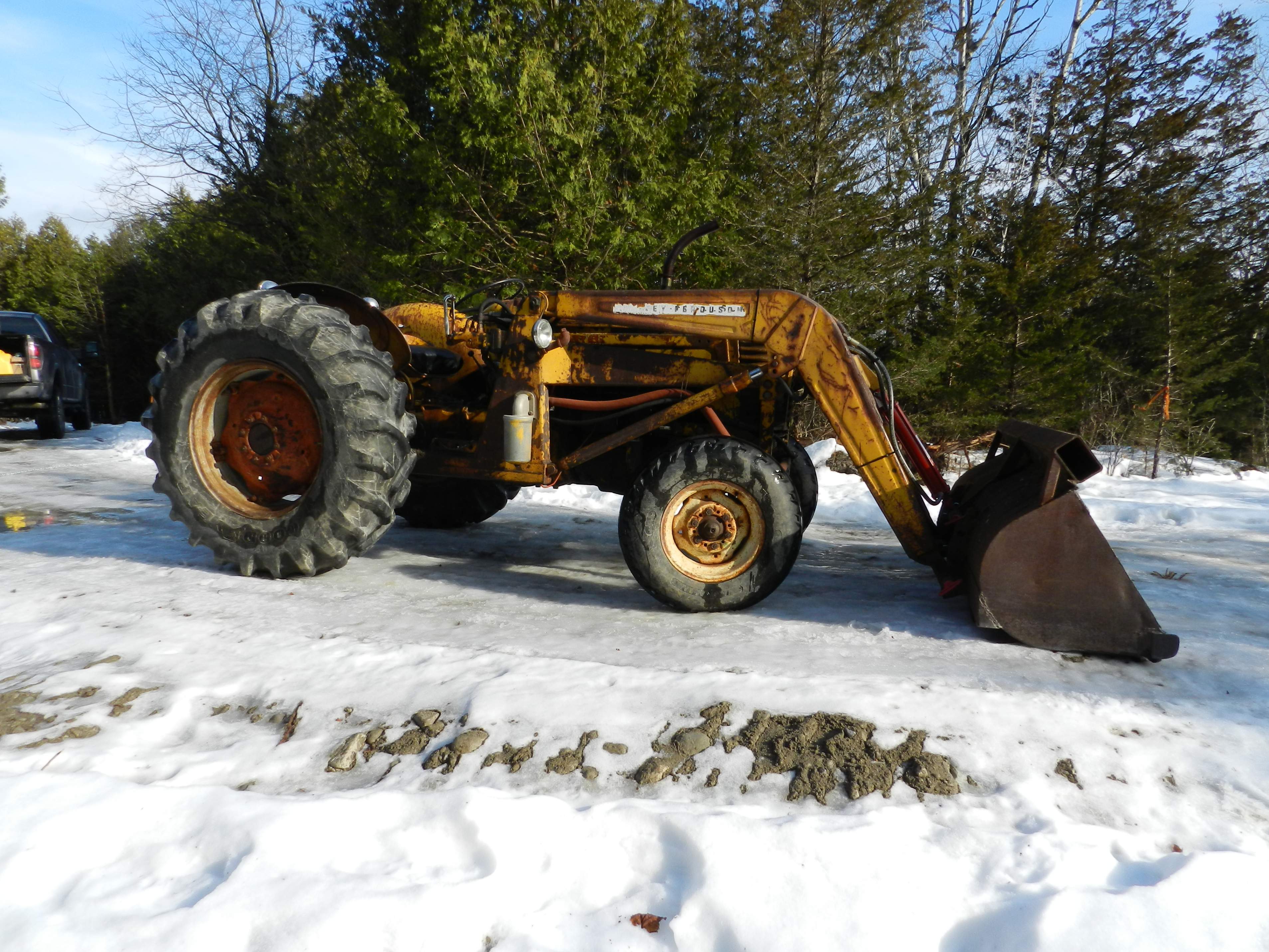

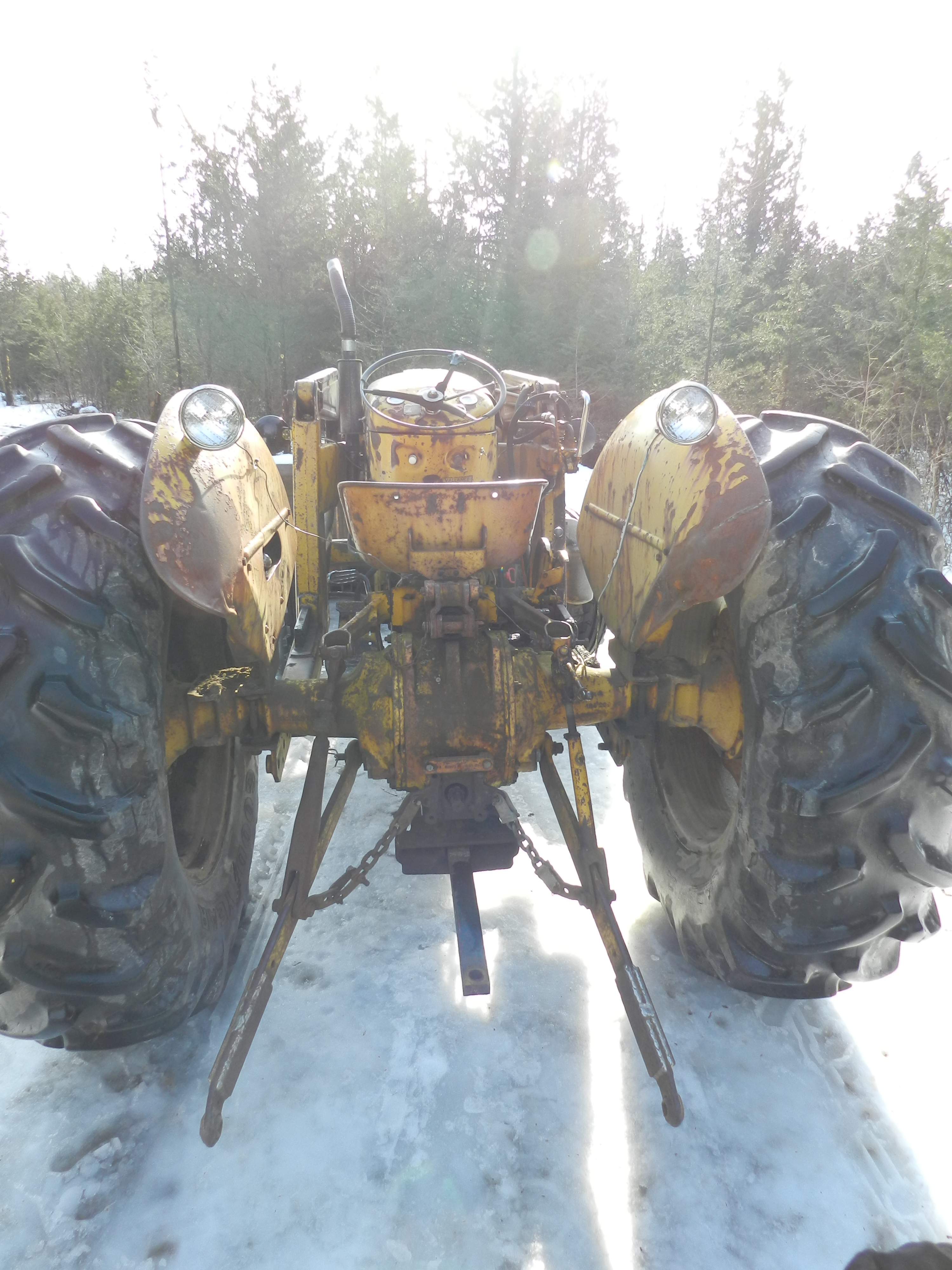

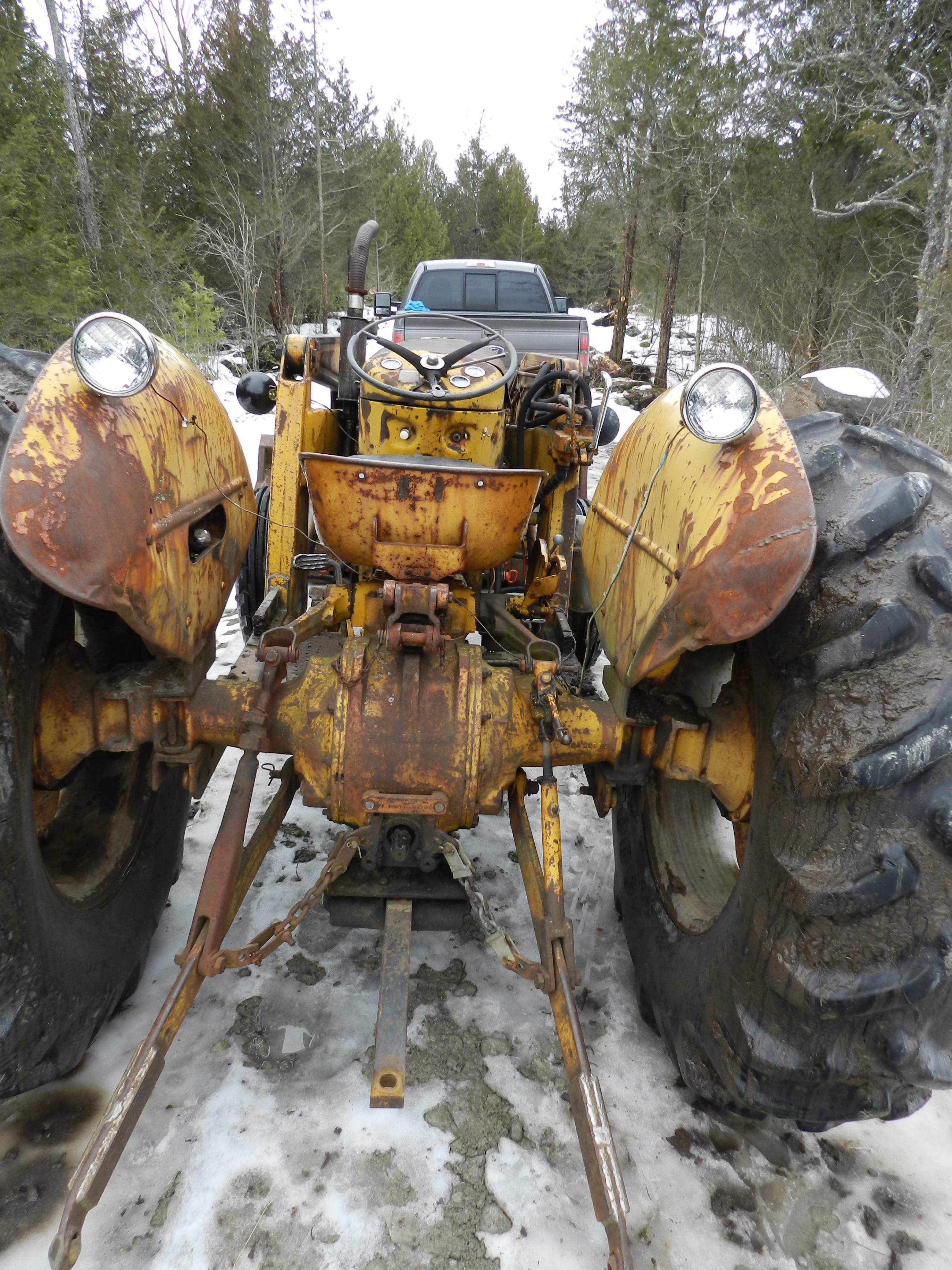

aczlan, here are some more pictures. from what I understand it's a 1959 MF65 Industrial... It used to have dual bucket cylinders and someone in the past has scabed on the single. I'm pretty sure it has the Perkins 203.4 Diesel engine. But very hard to find any info on the net, cause it's to early to be a 3165.

If his loader is like Dad's was (and I think it is), the tank is in the right loader tower (the one that the valve is mounted to). The tank goes from the back axle to the top of the loader tower and IIRC, the "tank" port on the valve goes directly inside the tank, down to the filter on the side of the tower (with a pipe inside the tank) and dumps back into the tank, so no external tank line to tee into. Hence my suggestion of welding a new fitting onto the tank/loader tower.
