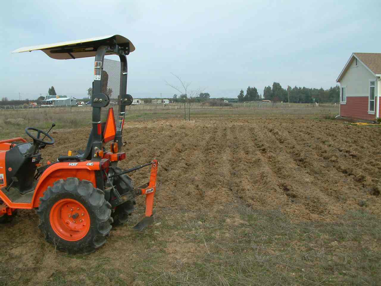

Do it the easy way and save a lot of time and wear and tear on your FEL. Get yourself a $150 middle buster plow (aka potato plow) from Tractor Supply. Plow the ground and scoop the loose soil with your 4-in-1 bucket. FEL buckets are made to scoop loose material, not for digging.

Best is ripping with the scraper, then going back and scooping it.
