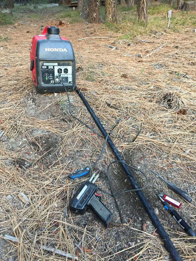

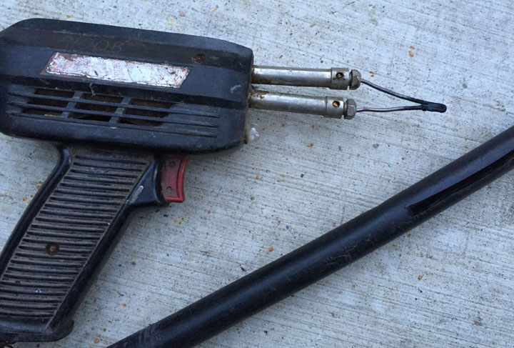

Got it welded with a 110v solder gun. I don't know what the wattage is but it was just ---->barely<---- hot enough. Had half a mind to drive to town and buy a 220v soldergun !
Had a little pencil torch for preheat but as I thought the flame starts the plastic on fire, pretty much couldn't make use of it. I was worried that any plastic was overheated (burned) would be weak, so didn't use the torch. I had to pre-melt ahead with the soldergun then go back and fill it, all with just barely enough heat to melt the filler before the preheat solidified. And the wind was blowing.
414863d1425440363-how-weld-hdpe-black-plastic-img_0224-jpg
I used a small piece of 12ga copper housewire for the "tip". And cut filler rod from another chunk of pipe, as suggested.

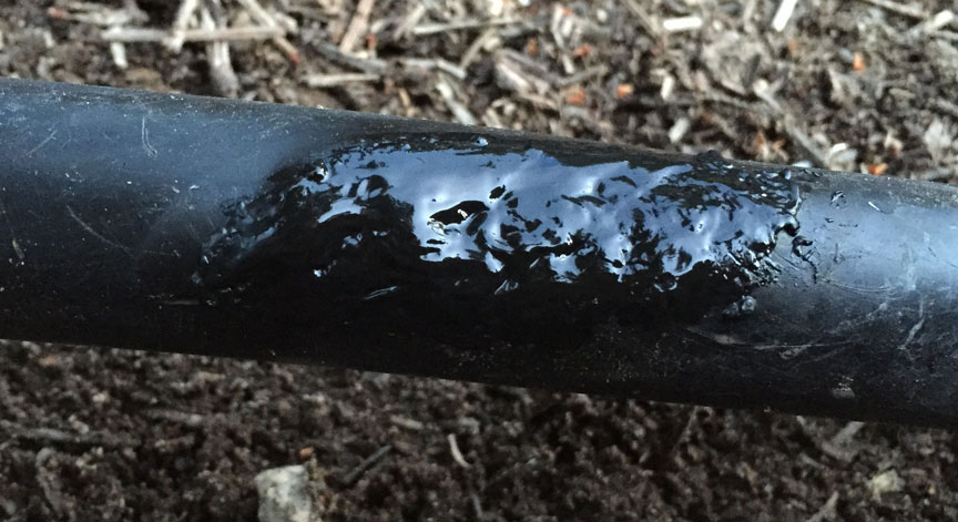

It was pretty lumpy. I smoothed it out with the pencil torch.

I think I should wrap it continuously with wire, a solid coil around the repair, so pressure won't split it open. It was pretty quick, took way more time to research it than to do it. But it's not done until I wrap it, so there's a little more time. Pretty sure this is gonna work. But I can't say I'd do a repair like this for a customer….this is just goofin' around.
