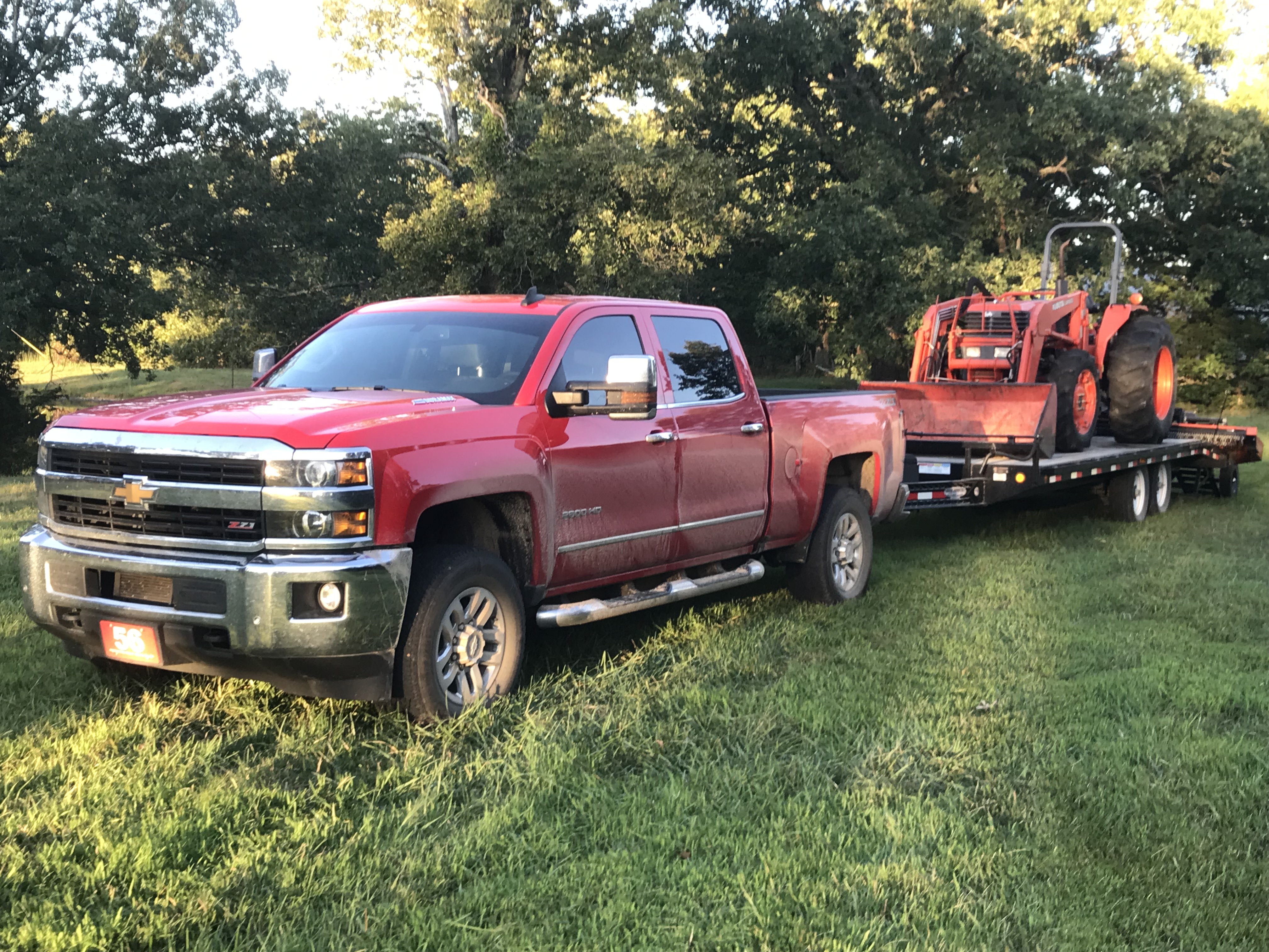

UPDATE: Well, two 40 mile trips back and forth to the dealer with a 10-foot wide load, not entertaining on small roads with oncoming traffic... my cutter's gearbox has been replaced under warranty.
After I finally talked to Titan Implement, I don't think the delay was their fault... because they had shipped a gearbox one week after my failure... and I 'think' the dealer was not there to sign for it... so an 85-pound gearbox is lost in UPS space somewhere.
Titan graciously sent another gearbox and gave ME the tracking number so I watched it like a hawk... and badgered the dealer when it arrived. He's a very small town tractor repair shop (and Titan Implement dealer) and he doesn't have a lot of help.
The dealer WAS kind enough to loan me his trailer for the transport.
Titan has a 5-year guarantee on the gearboxes, but they only grant the dealer one-hour for labor. The dealer said it took him 4-5 hours at his shop. I wouldn't have had good enough tools and big enough impact wrench for the job.
Sooooo - I mowed for about 3 hours with it, through heavy stuff. It works perfectly. After I shut it down I went back and felt the gearboxes and they all felt the same... I'd say they were less than 140 because I could hold my hand on them.
