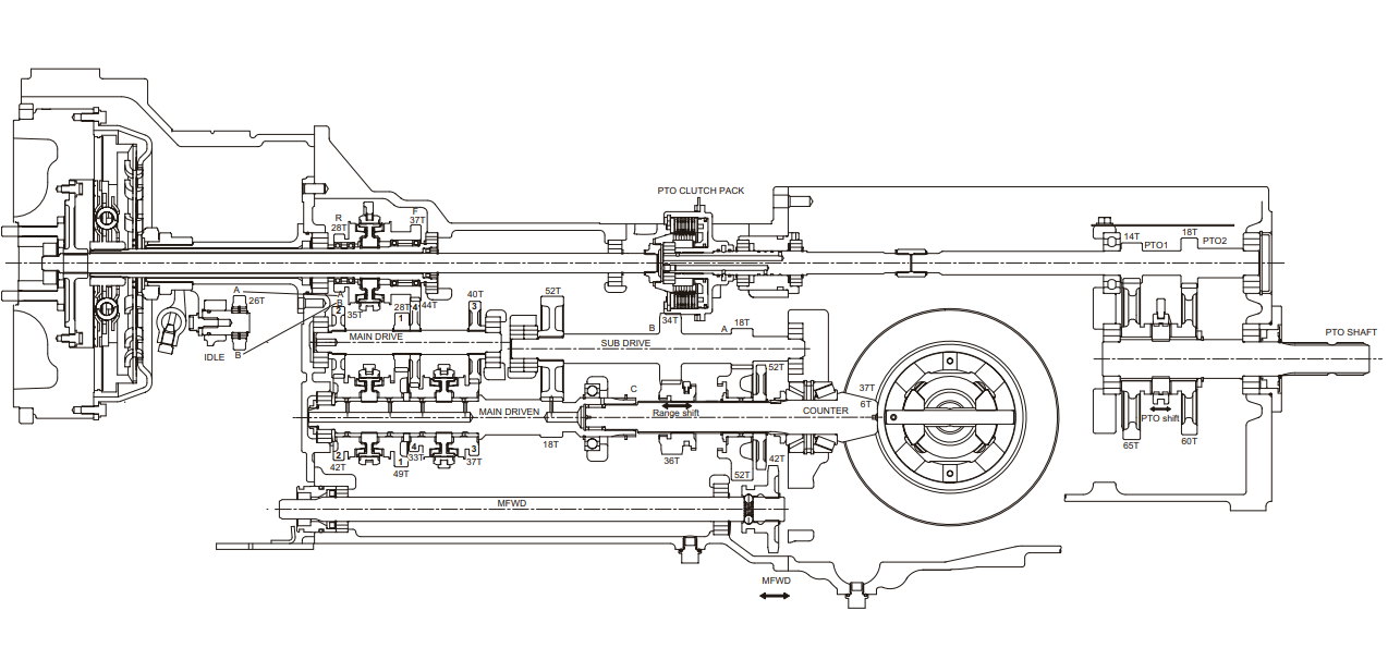

How does this PTO engagement mechanism work? I assume somehow the PTO ultimately is engaged by a gear to spin at 540rpm, but how do the dashboard switches actuate the PTO?
   / how well does TYM HST cruise & auto throttle work for bush hogging vs shuttle shift? #26
There is clutch pack for the PTO. A solenoid on a control valve mounted on the side of the transmission controls this clutch pack by sending hydraulic pressure to clamp the clutch or when turned off, releases the pressure. By turning the switch on, it's energizing the solenoid and therefore turning on the PTO.
There is also a spring actuated PTO brake built in the clutch pack. So when the PTO is off, the brake is engaged. Hence why having a lever to switch between PTO gears is a must on these. This way you can put it in Neutral and then you're able to rotate the PTO shaft by hand when hooking up implements.
Here is a diagram from the service manual for my tractor. Maybe it helps visualizing the layout.
#27
Seems a bit complicated in comparison to clutching and engaging the PTO via a single mechanical lever.
