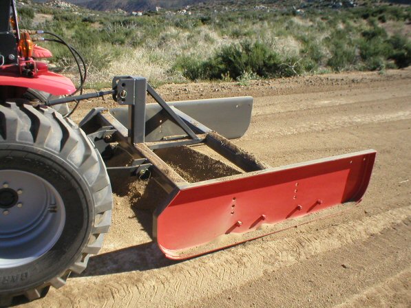

If you want to maintain your driveway, maybe consider one of these. These road grader blades work very well for maintaining a road.
Land Pride Grading Scrapers OR Products
