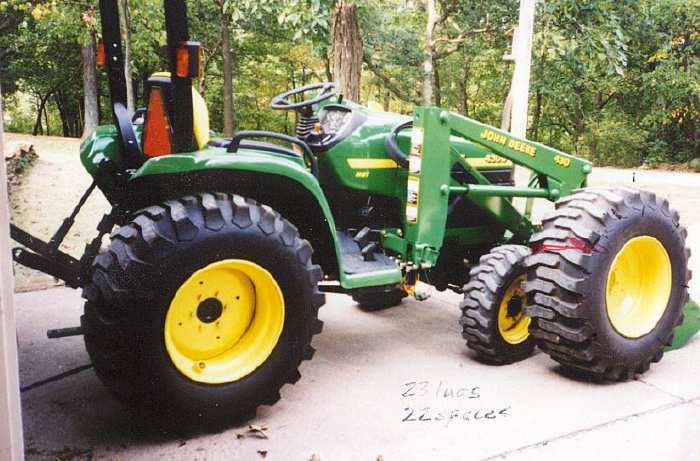

Hmm. How heavy are unloaded tire/wheels (14.9x24)?
   / How wide to set rear tires. #17
I agree being careful, but I did mine (while loaded) and they stand up (if R4's) pretty well on their own. This was taken just before I removed the right rear and rolled it around to the left side.

I've got Ag tires. I bet they won't stand up.

Re: positioning tires safely with a minimum of tools. Assuming the tires are going to be swapped in order to keep the tread direction correct, start with a good stable jack under one side. Remove the tire/rim and flip the center section if required. Once the center is tight, drop that side down on some stout blocking that is unlikely to fall over. Jack up the other side, swap the tire, center, etc. Let that one down then go back to the first side to finish the job.
