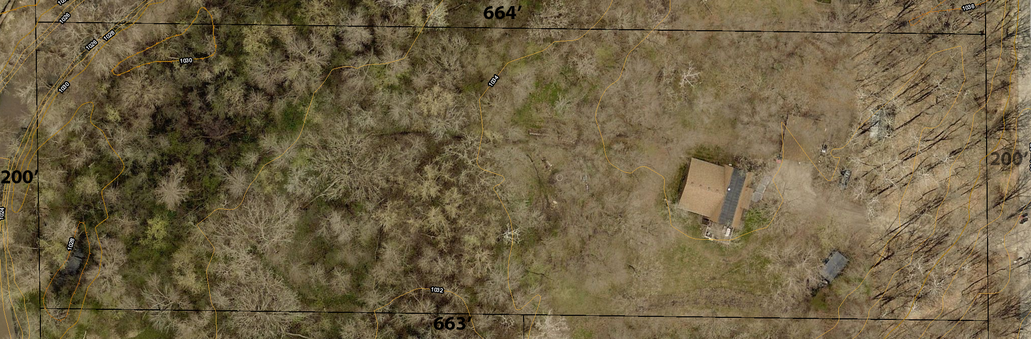

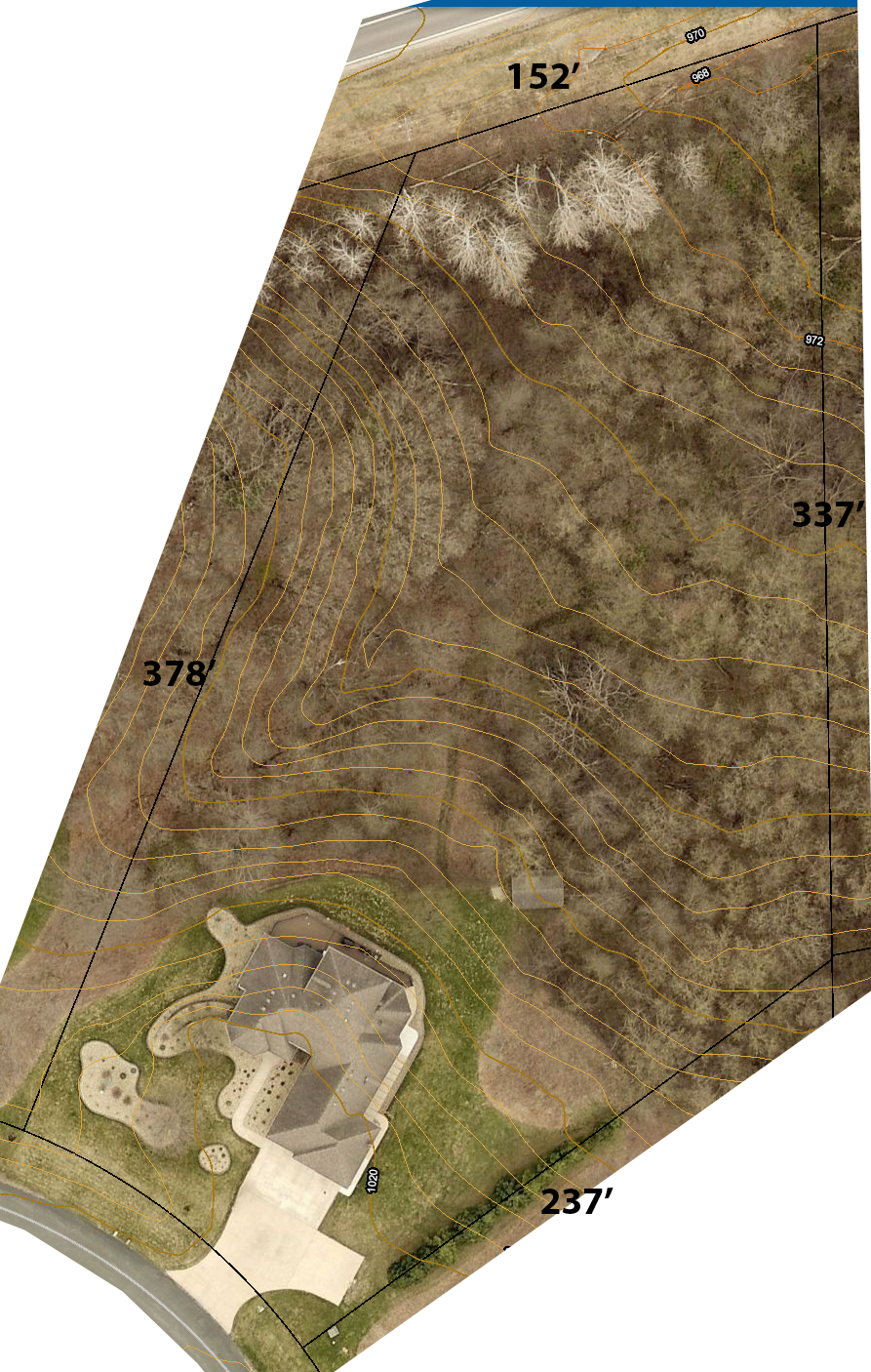

Hello! I've been lurking on TBN and other sites on and off for the psat few months, as I've been trying to decide how to approach the equipment I need to maintain my land. I can run myself (and have - a major "feature" of my decision process involves 'analysis paralysis') in circles over and over, or I can try and break out and solicit outside feedback. Well, here I am. I'm asking all you fine folks for your thoughts and opinions, to see how you would approach my situation.
I'm looking after two different lots; I've got a 2 acre lot myself (0.3 acres of grass at up to 15% grade; 1.5 acres of forest at up to a 22% grade, although the steepest trail is only 19% in parts) and I have a 3 acre lot that I help maintain as well (0.55 acres of grass; ~0.25 acres of light trees and grass; ~2 acres of forest; only significant grade is the gravel driveway at about a 9% grade).
What am I trying to accomplish?
At a minimum:
- lawn care for at least the first lot (mowing, annual aeration, etc)
- snow removal at least the first lot, but ideally both (just the fel+bucket, or snowthrower?)
- rehab then maintain existing paths through both forests (rotary cutter?)
It would be great if:
- help with forest maintenance/logging - trees die, the ability to lift/move trunks, haul wood, chip small branches, etc - thinking a lot about a grapple and a 3 point hitch chipper, for example
- move mulch/dirt/rock/firewood/x/y/z from drop point (typically driveway) to where needed (hello, fel)
- handle regrading of the gravel driveway in the second lot
- handle graveling additional section(s) as needed
- blaze new paths through forest
- pick up the occasional light pallet and move it
- lift/move/redistribute earth to terrace a new section on the hill in the first lot
How do I do it today?
- push mower
- aging, failing riding lawn mower
- no snow removal equipment yet (just moved back to the state of my birth; didn't need it for the past decade)
- no chipping today, burning brush, but would prefer to get more than that out of it (mulched tree stuff for forest paths, etc)
- hauling everything around by hand in a wheelbarrow
- shovels, rakes, etc - a bunch of human power
Sure, I can repair or replace the rider, source a snowthrower, and continue as is... but I'm wondering if there isn't a case for 'work smarter, not harder' here with a tractor and the appropriate implements.
So I've been debating tractors - subcompacts in particular, although I'll confess to having peeked at the compacts as well. I've been trying to figure out how to right size (or if it's even appropriate or is overkill) for what I'd like to accomplish. I'm also somewhat concerned about the grades present (in the first property, mainly - attaching a topo map of both), about the ability of a mmm vs some sort of 3point finish mower to handle same; the need for a snowthrower as opposed to just using the bucket (or a snow bucket, or a blade) on the fel.
I've been leaning more towards the Kubota stuff (the BX2380, or the B2301 maybe?) but I've looked at the LS MT125 and just started taking a peek at the NH WM25S... at least until I start thinking in the other direction and just repair/replacing the rider and sourcing a snowthrower.
So, now, I ask for your thoughts. How would you approach the work here?

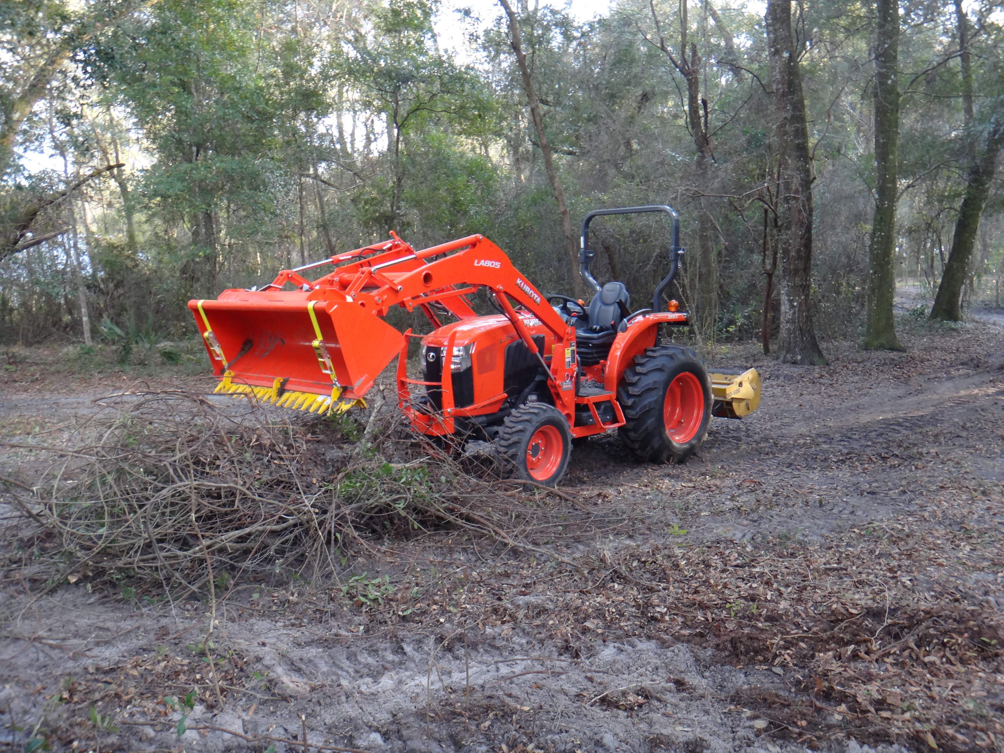

Other tractor applications:

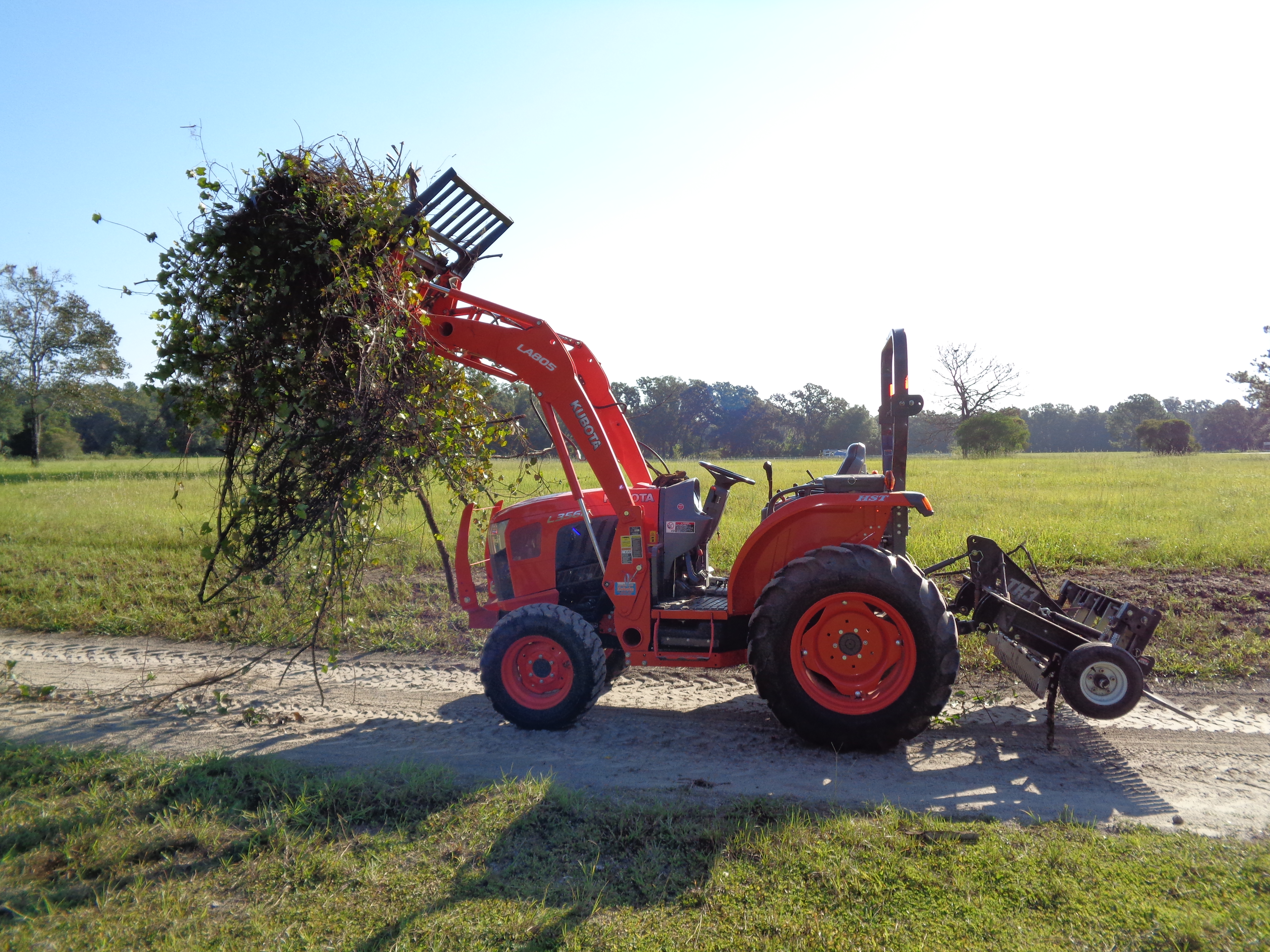

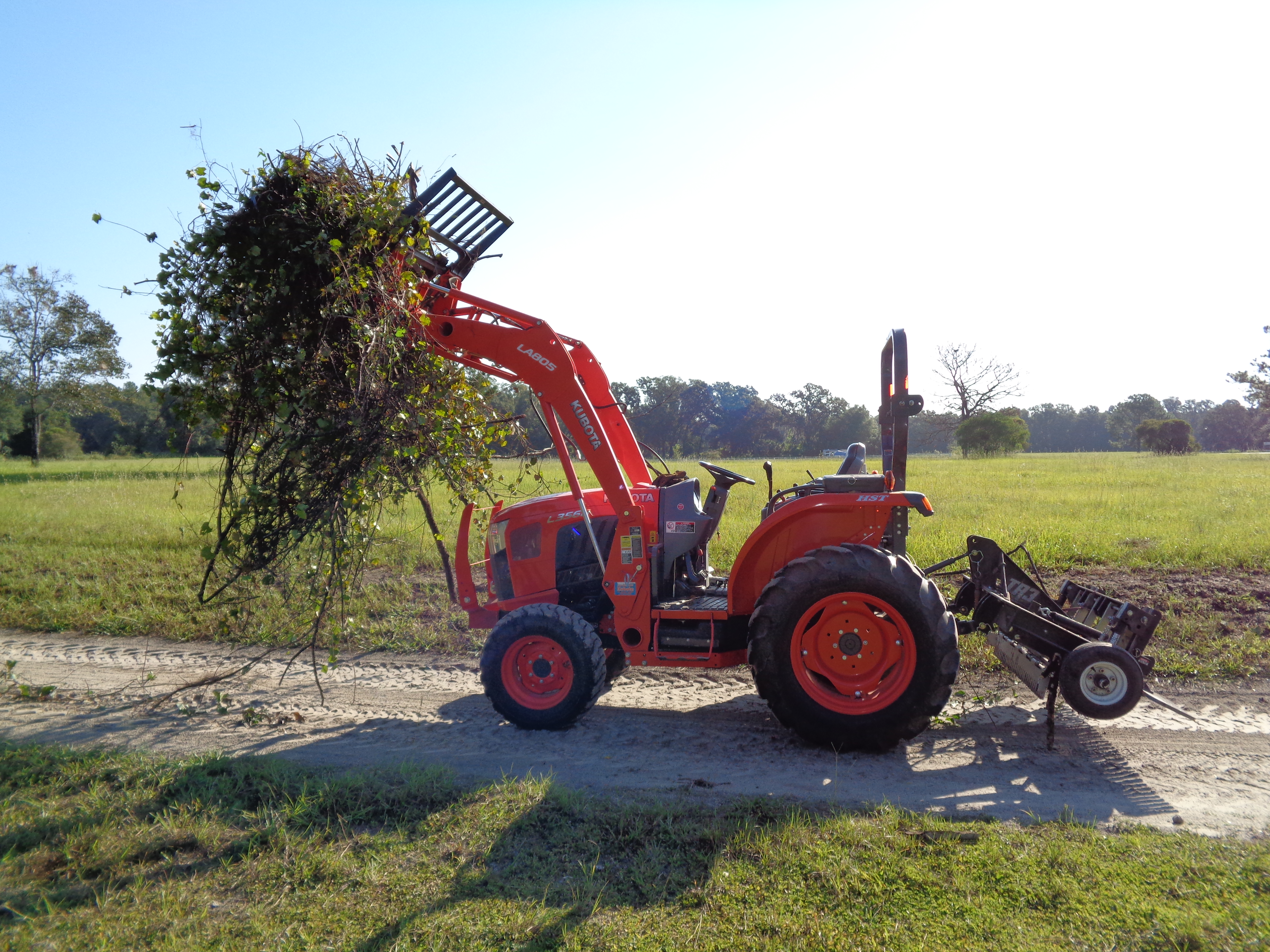

Yes, a fairly heavy Rotary Cutter and a Ratchet Rake bucket attachment.
VIDEO: ratchet rake brush clearing - YouTube
DIRECT VENDER: Ratchet Rake, LLC - All Terrain Rake, Snow Edge, Tractor attachment, Bucket attachment, Loader, Skid loader, Kubota, Skid steer, Landscape rake, Brush remover, York Rake, Harley Rake, Rock Rake, Tractor rake attachment, Construction attachment, New Holland, Bobcat, Fire safety, Home fire safety, Fire prevention, John Deere, skid steer attachment, tractor implement

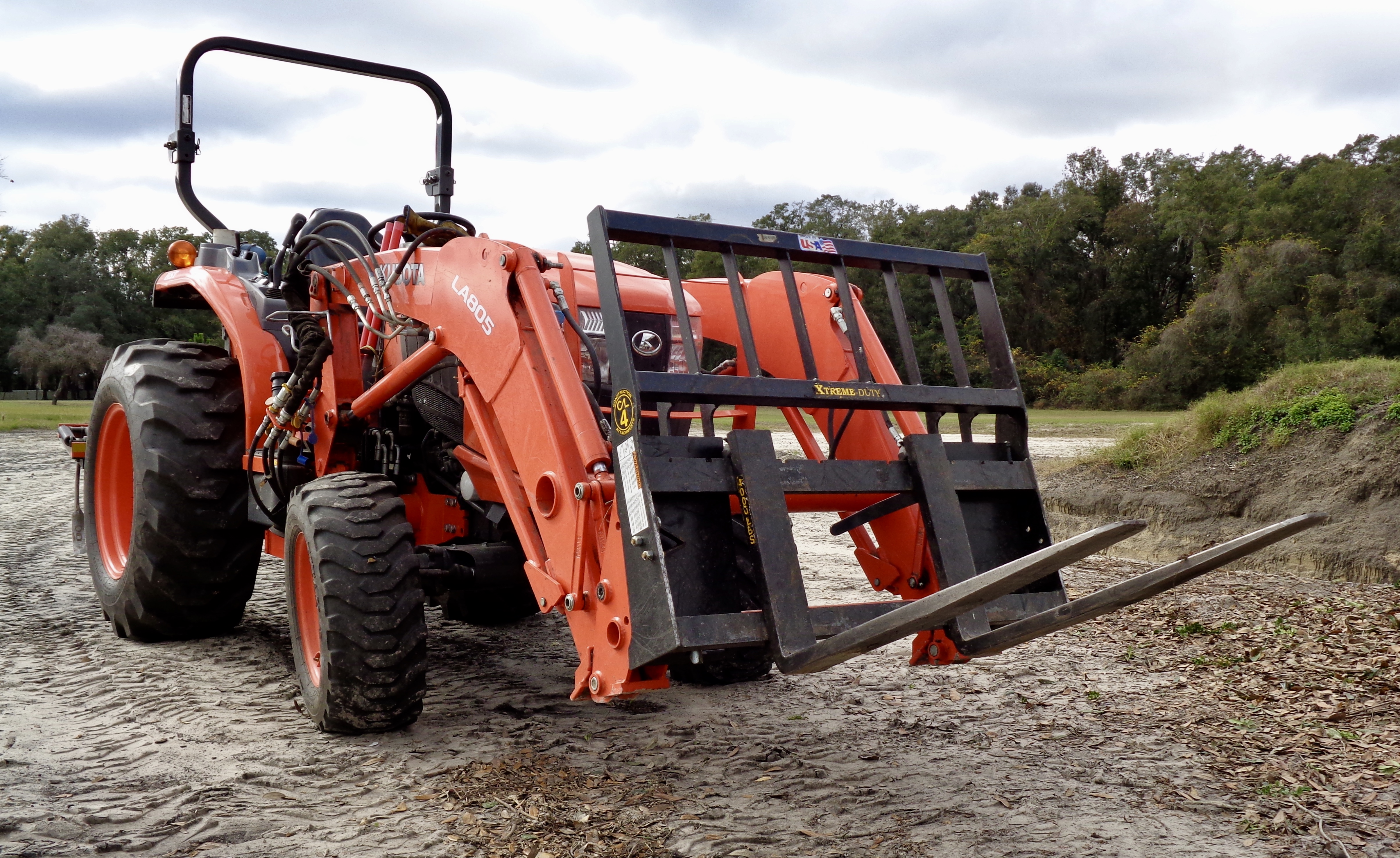

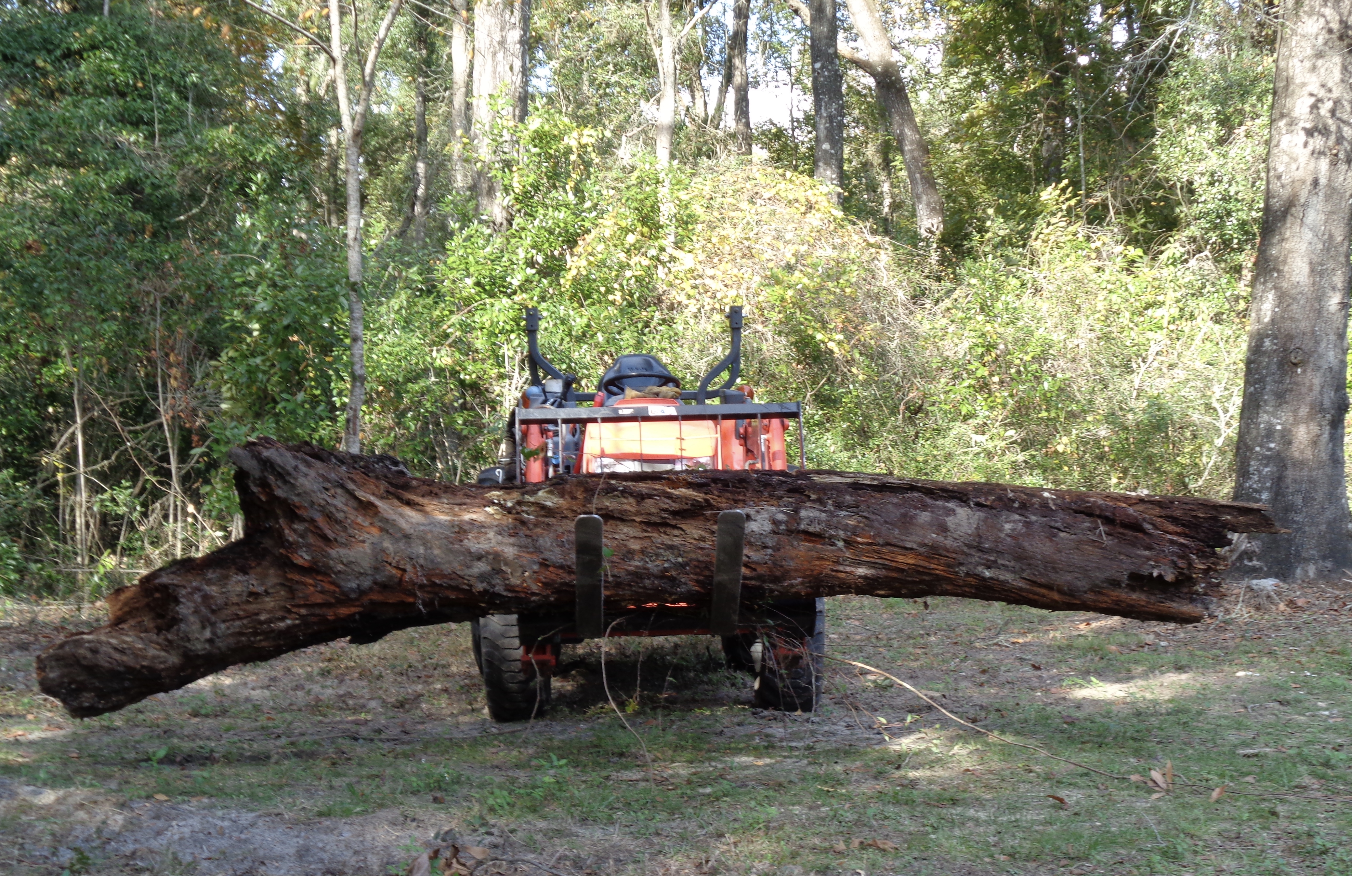

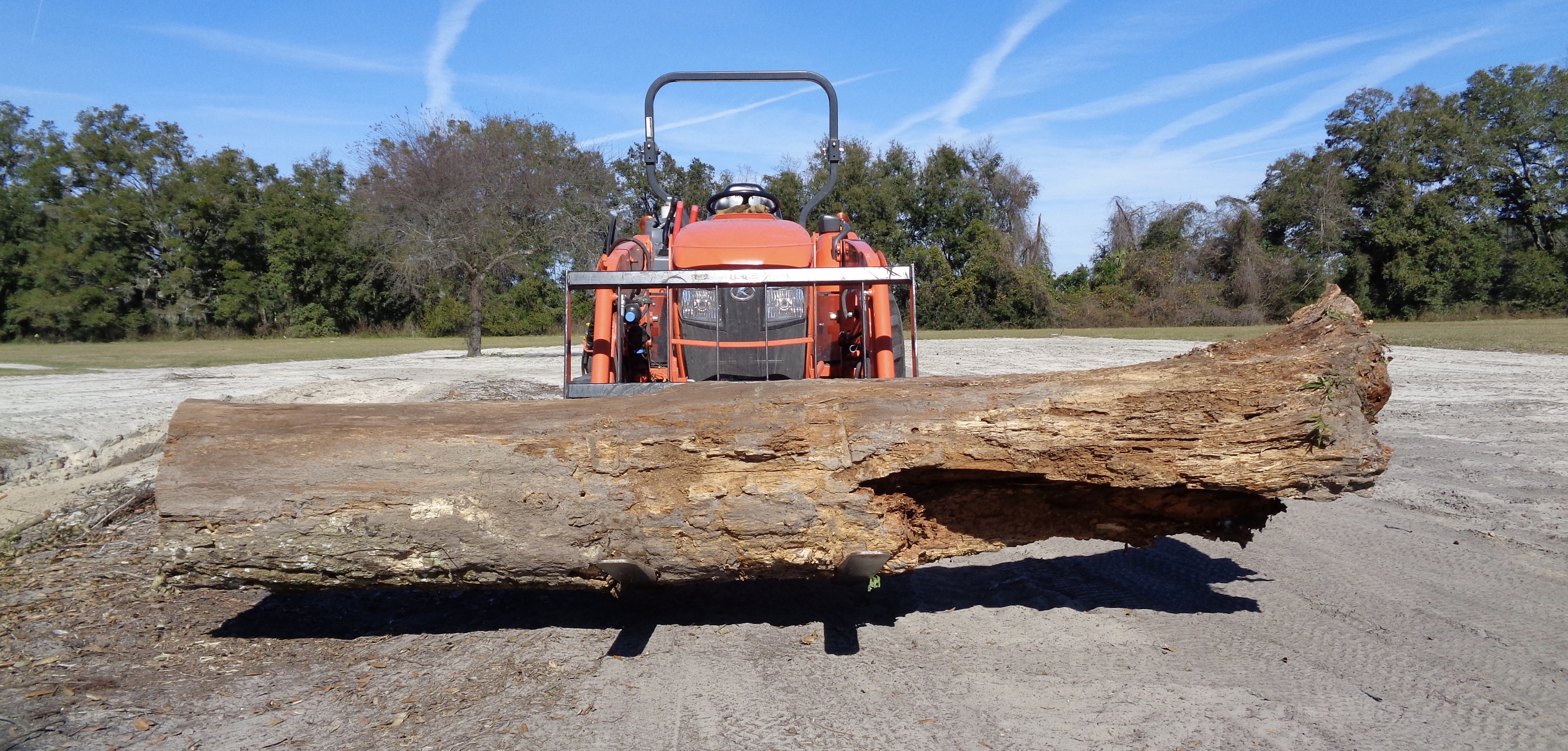

With less than five acres of concern a grapple is overkill in price and will be underused. Allocate grapple money to upgrade from a subcompact tractor to a compact tractor.
Consider 38" (short) SSQA Pallet Forks.
You can tow large trees using chain from the tree to the tractor rear/center drawbar.

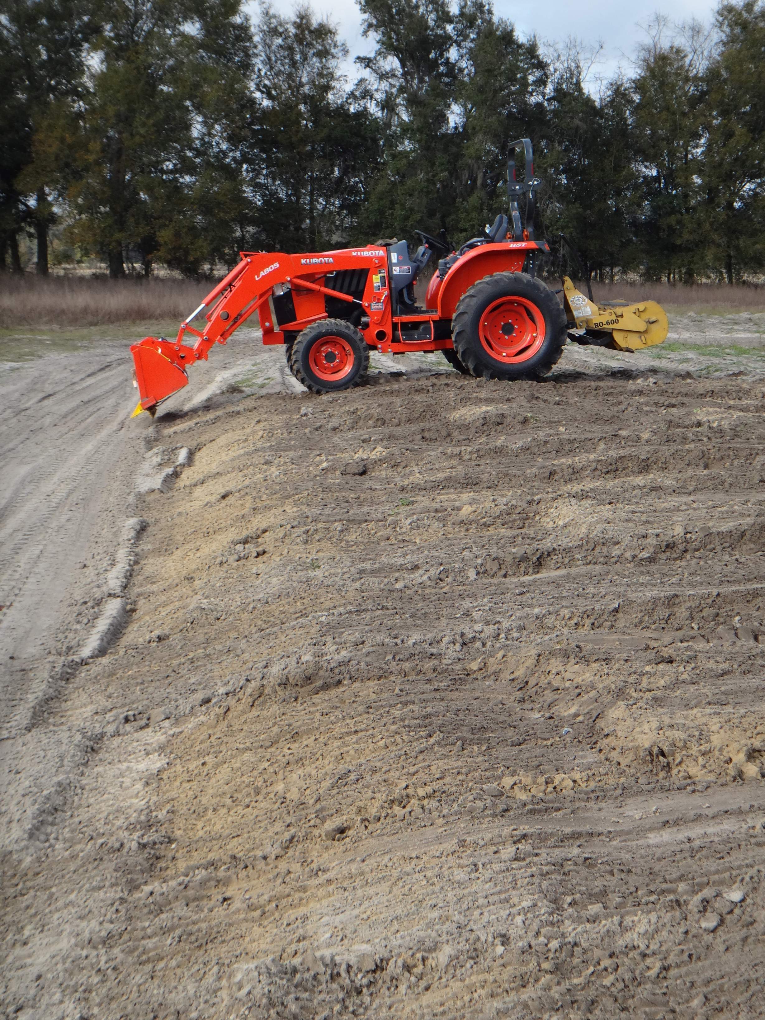

- lift/move/redistribute earth to terrace a new section on the hill in the first lot.
- move mulch/dirt/rock/firewood/x/y/z from drop point (typically driveway) to where needed.
FEL bucket.

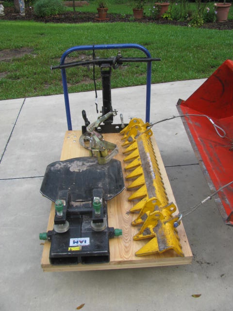

Implements being:
- quickhitch for 3pt?
This seems like a simple question, but it is slightly complicated to answer.
As you now know, the Three Point Hitch is a universal standard. With an economy tractor you have to back the tractor to the implement very precisely in order to insert the two LOWER LINK attachment pins. Many use an iron 'spud bar' to jockey the implement a tiny amount to make holes align, rather then moving the tractor repeatedly. So attaching implements to a 1,700 pound bare weight subcompact tractor, which will use light implements, is relatively easy.
Deluxe tractors have LOWER LINKS which telescope/adjust about 2-1/2", so the tractor does not have to be as precisely positioned. Deluxe tractors have telescoping LOWER LINK stabilizers too, which make implement connection easier. Implements for a 4,000 pound bare weight tractor weigh 500 pounds to 1,200 pounds; heavy implements are difficult to move manually.
VIDEO: Kubota Standard L Series L843 Telescopic Stabilizer kit (overview and install) - YouTube
Economy tractors often have an optional "quick hitch" attached to the LOWER LINKS. This allows LOWER LINKS to pass under pins, then raise, capturing LOWER LINK pins in a slot. Almost every implement manufacturer produces rear "Quick Hitches" as well as implements. The TOP LINK is not modified by the Quick Hitch. (The most popular Quick Hitch not associated with tractor brand affiliated implement producer is Pat's Quick Hitch, produced by Greenwell Manufacturing in Kentucky.)
When I was younger and less experienced with tractors I owned two economy tractors around 2,000 pounds bare tractor weight. Each had individual quirks connecting implements. At first I found connecting implements confounding, especially in hot Florida weather and I grudged the time and sweat involved. With experience connecting implements became easier. (I use my tractor 250 - 300 engine hours per year.)

Implements being:
- passing on the grapple for now, drag stuff with chains or chunk and put into a carryall
Drag with chains or carry on SSQA Pallet Forks. PHOTOS
Using Pallet Forks you can usually push two tines under debris, then pick debris up.
Do not use your back to lift debris into a carryall.
- ratchet rake bucket attachment (and possibly the towed version as well?)
Bucket attachment only. Buy the Ratchet Rake first. You may get along fine using the Ratchet Rake for grading for some time, while you ponder Box Blade and LPGS options.
Ratchet Rake // Today
6/09/2016​
This post concerns Ratchet Rakes Vs. light Box Blades, such as the 60" Land Pride BB1260/346 pounds/69 pounds per foot.
I searched for the weight of Kubota L3301 bucket but could not find a number. I presume L3301 bucket weighs approximately 240 pounds, extrapolating from other kubota specs. 68" Ratchet Rake weighs 88 pounds. Adding 240 + 88 = 328 pounds, pretty close to 346 pounds of BB1260 Box Blade.
In addition, the (operator controlled) weight of the FEL frame bears on the Ratchet Rake. Likewise, weight of the Three Point Hitch bears on the Box Blade. FEL frames weigh much more than ( 3X? 4X?) Three Point Hitch components. So, including some FEL weight, I guesstimate that ground contact pressure on Ratchet Rake and BB1260 would be at least equal, perhaps greater pressure on the Ratchet Rake.
Further in Ratchet Rake's favor you have articulation of bucket/RR combination in two planes from the operator's station and 1-1/2" serrated teeth on the Ratchet Rake.
Box Blade can be raised and lowered hydraulically from the operator's station. Box Blade angle of attack is adjustable via the Three Point Hitch Top Link, but not from the operator's station. Standard Box Blade does not have rippers, standard is a smooth cutting edge.
Ratchet Rake is capable of tearing up sod with its serrated teeth, the initial operation in much grading. The Ratchet Rake will not pull as large a load as a Box Blade but it may pull 35% of capacity of BB1260 per pass, with faster cycles. Ratchet Rake is more intuitive in operation than a Box Blade, which requires considerable experience to operate efficiently.
This is why I feel the Ratchet Rake is superior to light Box Blades for LIGHT grading.
I own both a Ratchet Rake and a Rollover Box Blade.
When I have heavy grading to do, I mount my 60"/625 pound (125 pounds per foot) Bush Hog (brand) Rollover Box Blade on the tractor's Three Point Hitch AND the Ratchet Rake on my FEL bucket.
