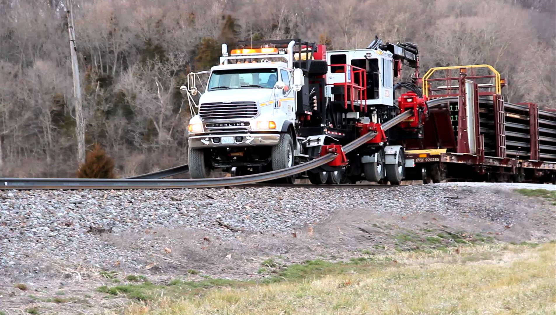

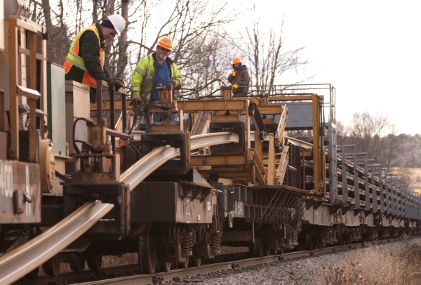

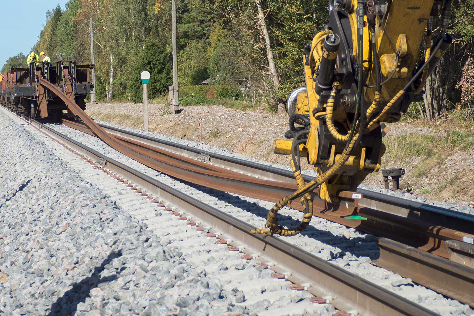

Most people only have hands-on experience with short pieces of rail. Longer rails are more flexible than most people think. In use, they seldom span more than 2 feet.
continuouswelded.jpg railflex.jpg track-panels-stacked.jpg railbend.jpg railtruck.jpg
If you have enough rails, you can build a strong bridge. :)

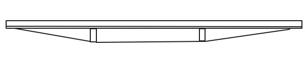

Here is how I would use the rails for a light duty bridge. Keep it narrow so someone in the future doesn't try to drive a large truck or tractor over it.
Maybe 4x8 cross beams and 1/4x2 straps.

What is the real span over this creek? I see you have 20 ft rails but is that the real span?
I think you will put a lot of effort making these rails work for you. Treated 6" round for posts, treated 2x12's 1 ft on center for spans. If you google rail road truss bridges, you can see it's a real simple concept and real strong.

i would heed previous advice on deflection of rail. It is designed to be evenly support the full length (note the flex shown in the pictures. I guarantee as soon as that narrow light weight bridge is complete you will kick your self for not making it wider when you need to drive something bigger or heavier over it. I always plan on 10' wide on bridges I have built. I use 16' RR ties with wide dimension vertical for stringers, 3-4 at least then plank over. That makes a bridge span 14-15' long setting on a well supported sill logs/walls. I have driven a 1 ton dually with 8-10 K # of gravel in it with no deflection. Never pays to build to minimum, use creep always comes along. Last project I did was about $600 worth of materials.

I've got two sections of railroad track-- about 20 feet long each-- spanning a small stream, resting on two very large rocks at each end. Next step is to add some planking but not sure just how the best way might be to do that. Pretty hard driving nails or screws into that iron! :D
I'm thinking the final bridge should be around five feet wide. The heaviest load on it would be our John Deere 748 garden tractor. Any suggestions?
[ If your actual free span is 10' or less, I think it could work for you.
If your free span is greater than 10' you need a new plan, with a much deeper web dimension than railroad rails.[/I]
