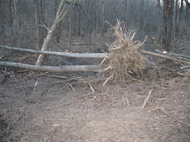

Your TC40 will move this tree with ease.
I would place your FEL under the tree to lift slightly then I would use a chainsaw
to cut above the stump next you could move the tree in direction that easy to tend to (makes great firewood) then I would use the FEL on the stump it looks to be rotted away you shouldn't have any trouble with it --you could always use your backhoe--I have the same one as you..if you have a toothbar it makes life a lot easier--I now use the toothbar more than the backhoe for your type of situation.
here's a picture: this is how I like to take trees out these days

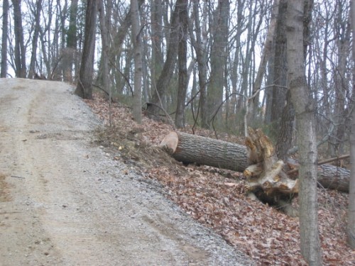

Here is the fix - I cut the tree, then pushed the stump over the hill with the loader. I could only find one attached root and sawed it. I did manage to get my saw wedged between the trunk and a smaller tree that had fallen. I ended up spending as much time getting the saw free as I spent on the rest of the job.
I used the TC40DA to haul a bucket full of good clay base, then drove back and forth to pack it down. Those R4s did a nice job. Should get a new top coat of gravel this week.
I stopped counting at 65 rings on the tree. My guess it was close to a 100 years old. The next task is to figure out how to get the firewood up the hillside.
Thanks for all the suggestions.

Quick simple and to the point, good idea. Just a word of caution if you had not build the road so close to the tree, It (tree) would probably still be standing.
My late father-in-law built the drive in the late 50s. So a couple of the trees have grown into the road. I've got a couple of more to deal with. I did hate to see it go.

i see a portable saw mill being called in the near future for that NICE oak trunk
