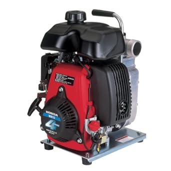

Also got lucky and picked up pump below, Honda WX15, for $40 at yard sale and when I looked it up I was surprised, it retails for $500, all it needed was about a hour of TLC to clean scum and corrosion out of carburetor...

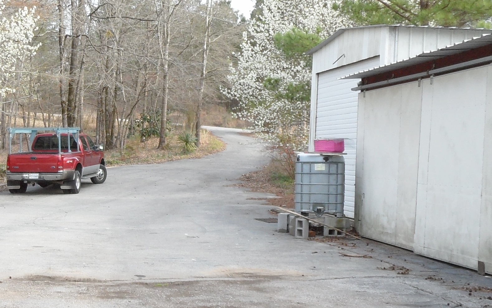

I've had a tote outside a shed in Mississippi for
probably 8 years. Water runs off the roof, pours into the old pink cooler, which acts as a funnel to get the water into the hole on top of the tote. For filtration I've a piece of window screen, for algae and bacteria I occasionally throw in some chlorine. I set it up mainly to provide easy water for my little sawmill and rinsing stuff outside. When I "lost" running water to my restroom I started using the water for flushing the toilet (probably occurs about 60 times a year) carrying water in a 5 gallon bucket. But that became tiresome

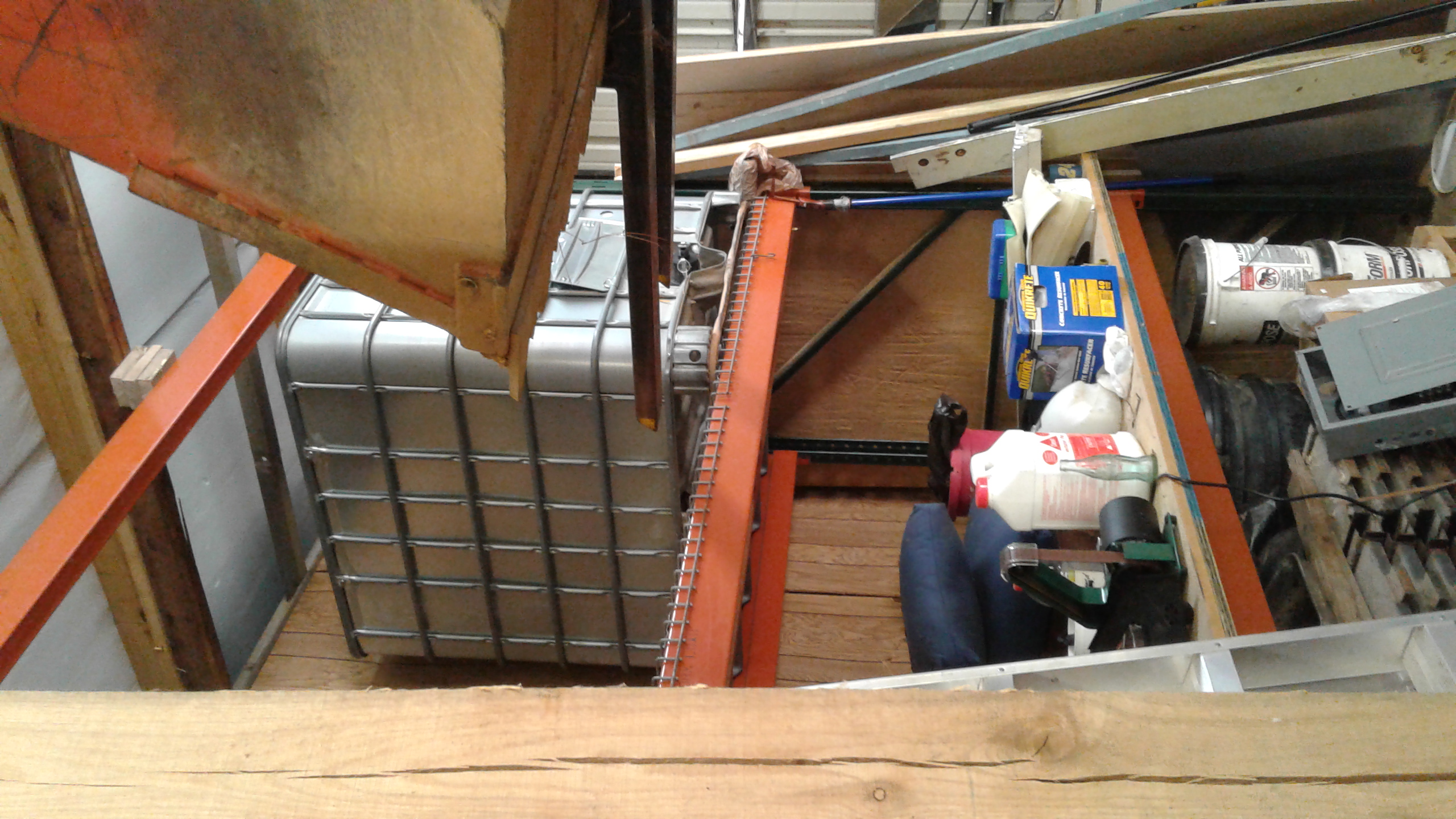

20170917_112201.jpg so a few years ago I put another tote about 6' up in my pallet rack. That provides plenty of head.
SO - assuming your 40' storage container is NOT on end, but has a roof about 8' above ground level that should give plenty of water pressure for manual washing.
