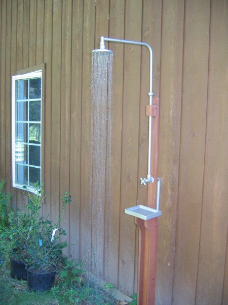

As shown in this picture, the garage (and our house) is sided in vertical cedar siding. The garage was stick built with the 2x4s inserted as nailers for the siding. I'll check but I think the OSB is 3/4"

As shown in this picture, the garage (and our house) is sided in vertical cedar siding. The garage was stick built .
*The 2x4s were inserted as nailers for the siding.
I assume you are refering to the horizontal 2x4s but why would they be necessary when the siding is already nailed to the vertical 2x4s?:confused:
I'm still puzzled as to why the vertical 2x4s were installed faceing the wrong way:confused:

Please explain what is the "wrong way" for the vertical 2x4s. I am mystified by this, they appear to be correctly installed to me.
Way back when, the horizontal 2x4s would have been called "fireblocks", and one of their purposes would have been to prevent the rapid spread of fire if the wall were finished out and not insulated.
