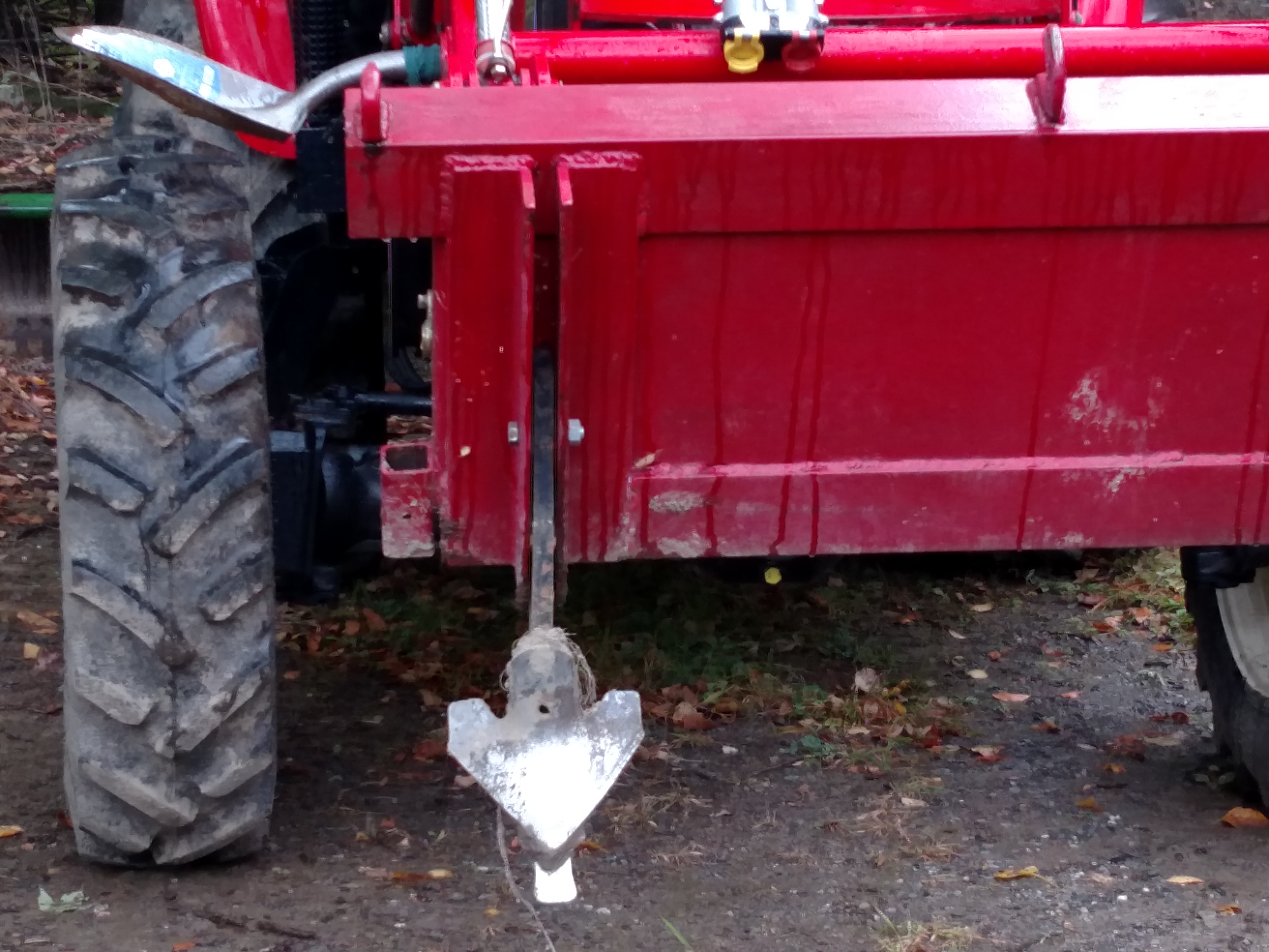

Your speed bumps if set at an angle to divert the water will work.
My driveway is too steep to try and crown and if you put enough side slope on a driveway to shed water you will spin off it in the winter.
I put small trenches in mine.
This is a box blade shank with a cultivator shoe welded on it mounted on a SSQA plate.
I put diagonal cuts in going down the driveway to catch and divert the water, they do have to be redone frequently.
With a back blade you could tilt and angle to clean out your ditches,
then angle and pull to move your material back into the driveway,
after you get it roughed in, turn the blade 180 and leave it angled
and pull it (backwards) to slick up and smooth your driveway.
With the moldboard and cutting edge in a convex mode it will not dig in,
it will slid over and level and smooth.
Luck
