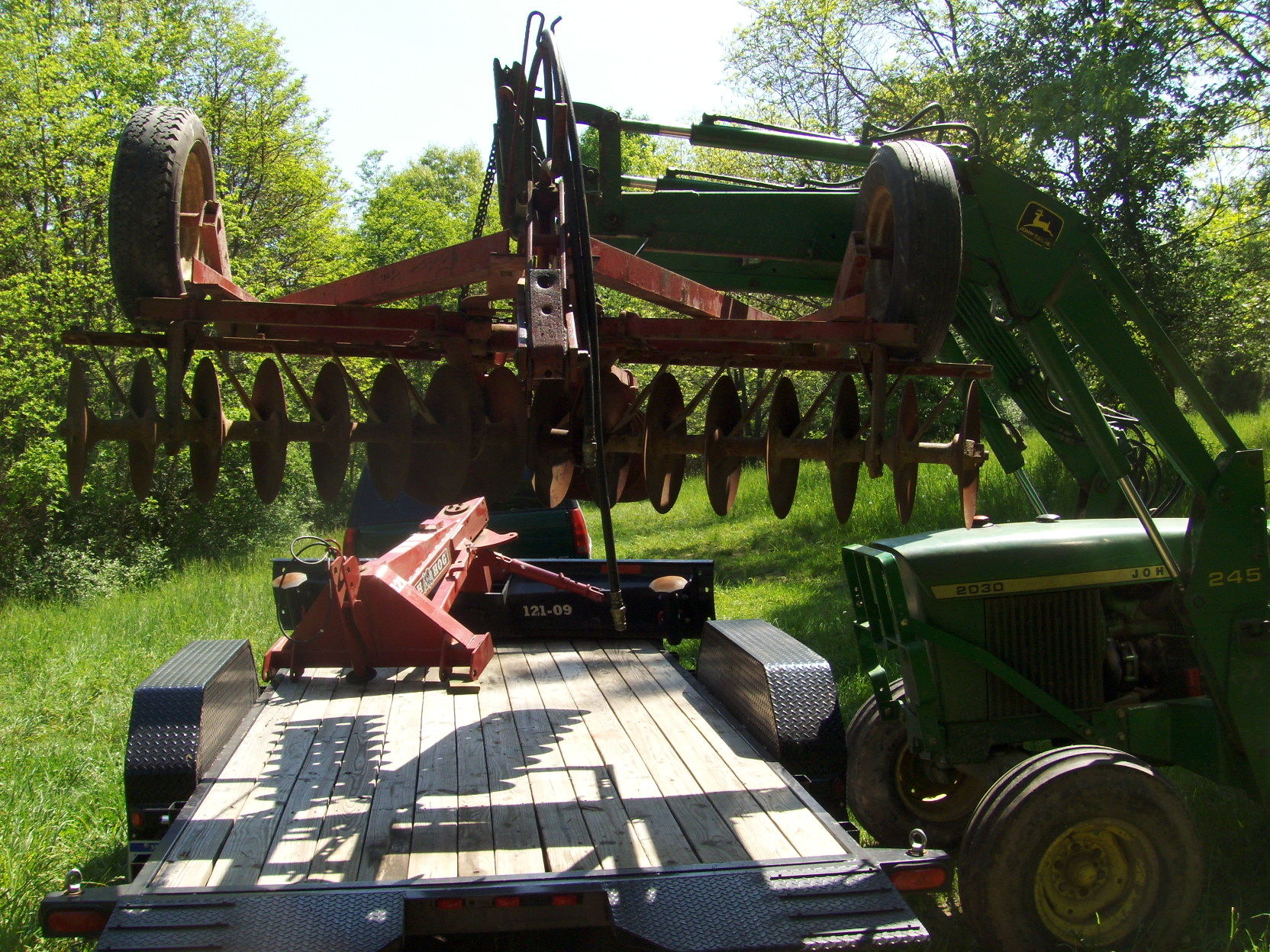

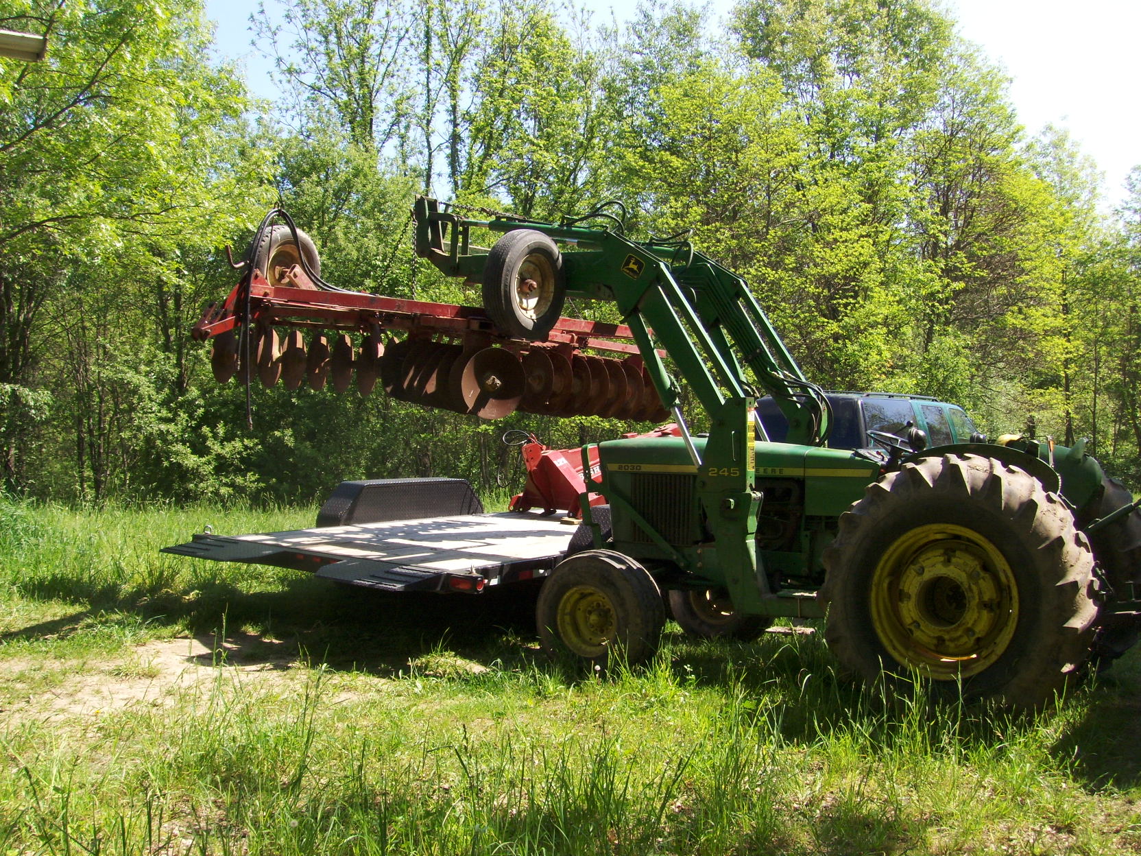

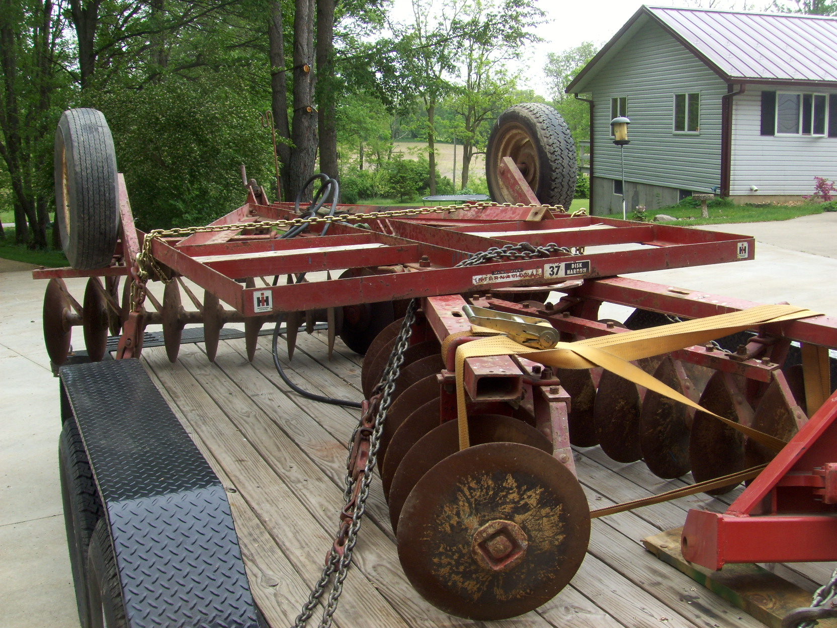

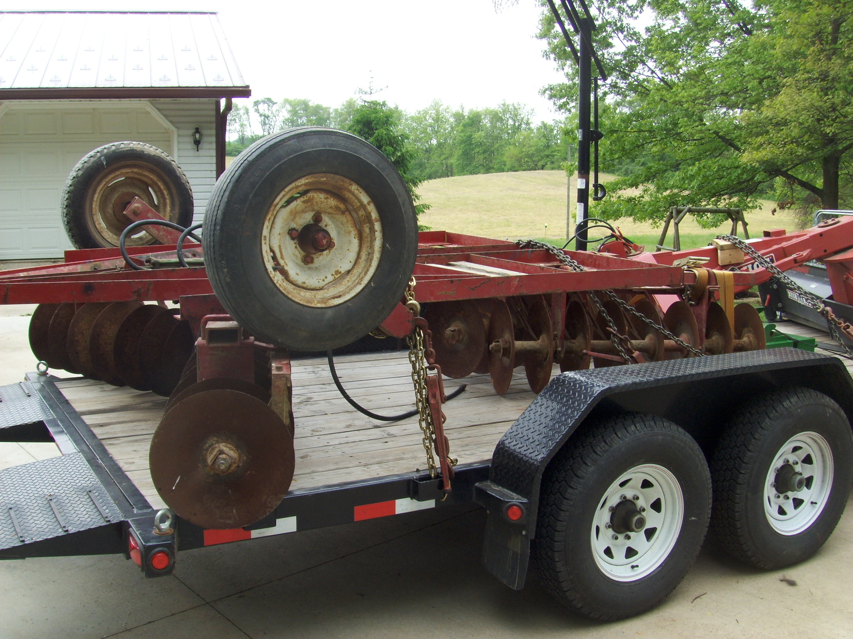

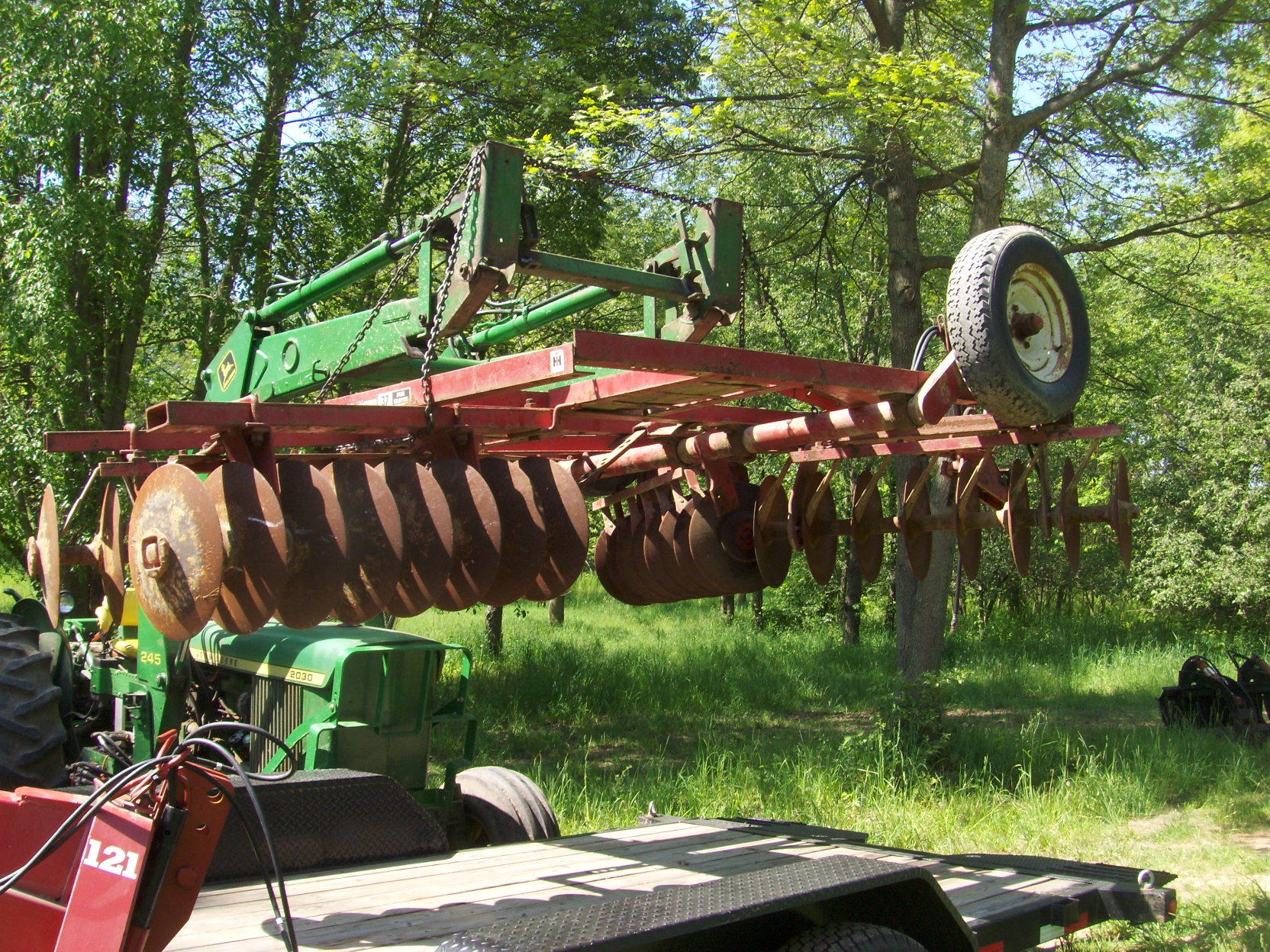

I also bought this model disc. It was a 10' too. I used my 18' trailer. I took it apart to the point I could swing the rear gangs back and the front gangs forward so it was narrower than 8' to transport. I don't recall exactly what had to come apart, I think it was at the outer edges where you set the gang angles. HARDEST part was loading it. They only had a skid steer and it could not quite pick it up. We had two guys hanging off the back of the skid steer and then had to back the trailer under the lifted, teetering, disc. I used my JD 2030 to unload it with no problems. It was taken apart near dark and only lost one hairpin clip (3 guys taking it apart)
Also picked up a Bush Hog 9' rear blade. It was about a 180 mile trip.
Hope this helps. It can be done.

Forgot to say we disconnected the hydraulic cylinder and swung the transport wheels over and toward the tongue of the disc.
