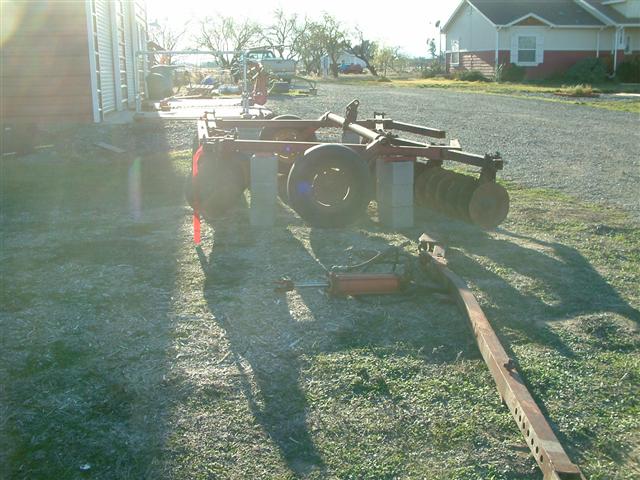

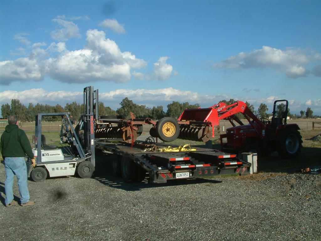

I bought a 13-ft Minneapolis Moline KS-1300 disc from my tractor dealer a few years ago. He delivered it using his big gooseneck trailer. He removed the hitch and loaded the disc sideways onto the trailer. He brought his forklift on another trailer. Use that and my Mahindra 5525 with bucket forks to unload that thing.
He only had to go about 25 miles. Paid $600 including delivery.

Vote #3 for sideways with the tongue off of it. Brought home a 16' disc and a 14' cultipacker that way on the same trailer. Used the 450B to unload the disc though! I might suggest some 2x8's under the discs so you dont decorate your trailer deck with gouge marks.
