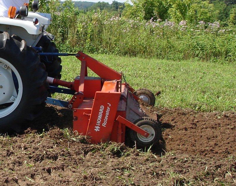

I have a 60" Howard Rotovator J. I bought if new around 1982 and it has probably about 100 hours on it. Never had a single problem. I just keep it lubed. It is built like a tank.

I have this same rotovator in your pic which is on the back of a Kubota B6000. I'm having a hard time finding the right kind of shear pin which engages the blades. I have no manual and I was told recently that there is a set screw I need that stabilizes it further. I keep shearing off the pin and then it gets stuck in the hole, deforming with the force. Any ideas? Works great when it's working~:D

Welcome to the forum.
My unit does not have a shear pin. It has a slip clutch. According to the manual it can have either. The shear pins shown are near the rear of the PTO shaft. There are two of them. The manual specs. them as 1/4" X 20 X 1 1/2" Grade 2 shear bolt.
My blades are bolted to a square flange. There are 7 square flanges welded to the main shaft and each flange has 4 blades bolted on. There are no shear pins associated with the blades.
I do not see any set screws in the manual. If you could post a picture or two showing where the shear bolts are that would help to see if it is the same setup as my manual shows. My manual is dated 1979. I bought mine new around 1982 and have not yet had problems with it. I only use it about 5 or 6 hours per year.

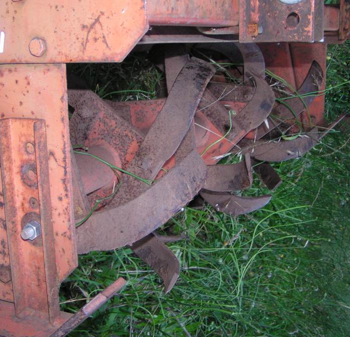

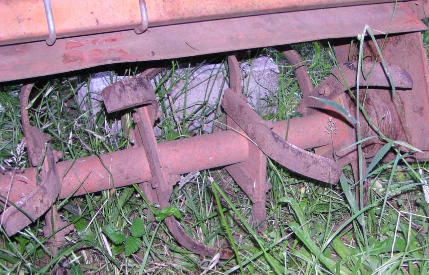

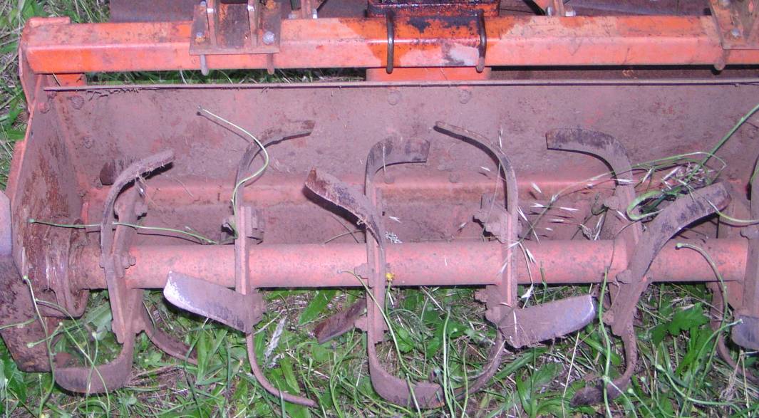

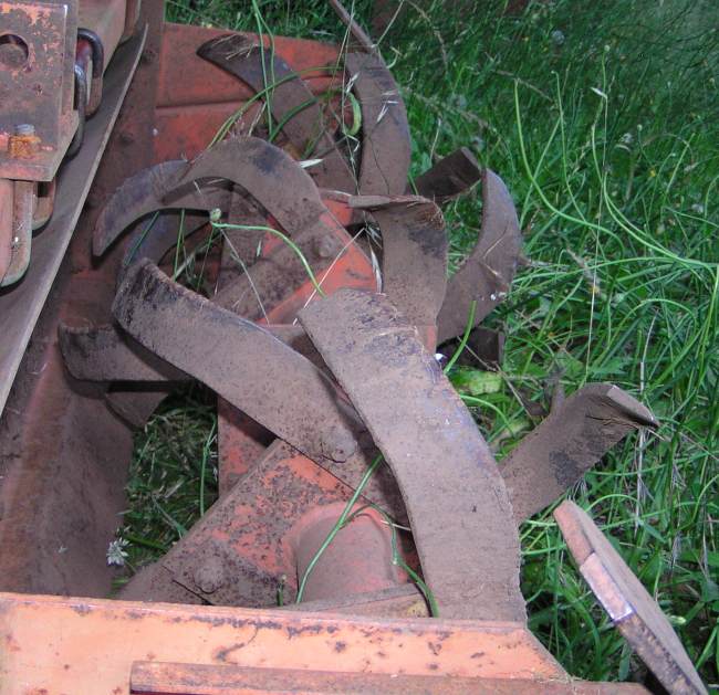

I have a Howard Rotavantor J and I removed all the tines and I can not remember how to install new ones. I have purchased them but not sure how they go back on. Can anyone help?

Here are a couple of photos.
My blade turns in the forward direction (as if to push the tractor forward as it is tilling).
Right/Left hand blades are alternated.-
Curved blade bolted so blade is mounted on side opposite from curved section.
Let me know if you need more info. I have no manuals with my tiller.
