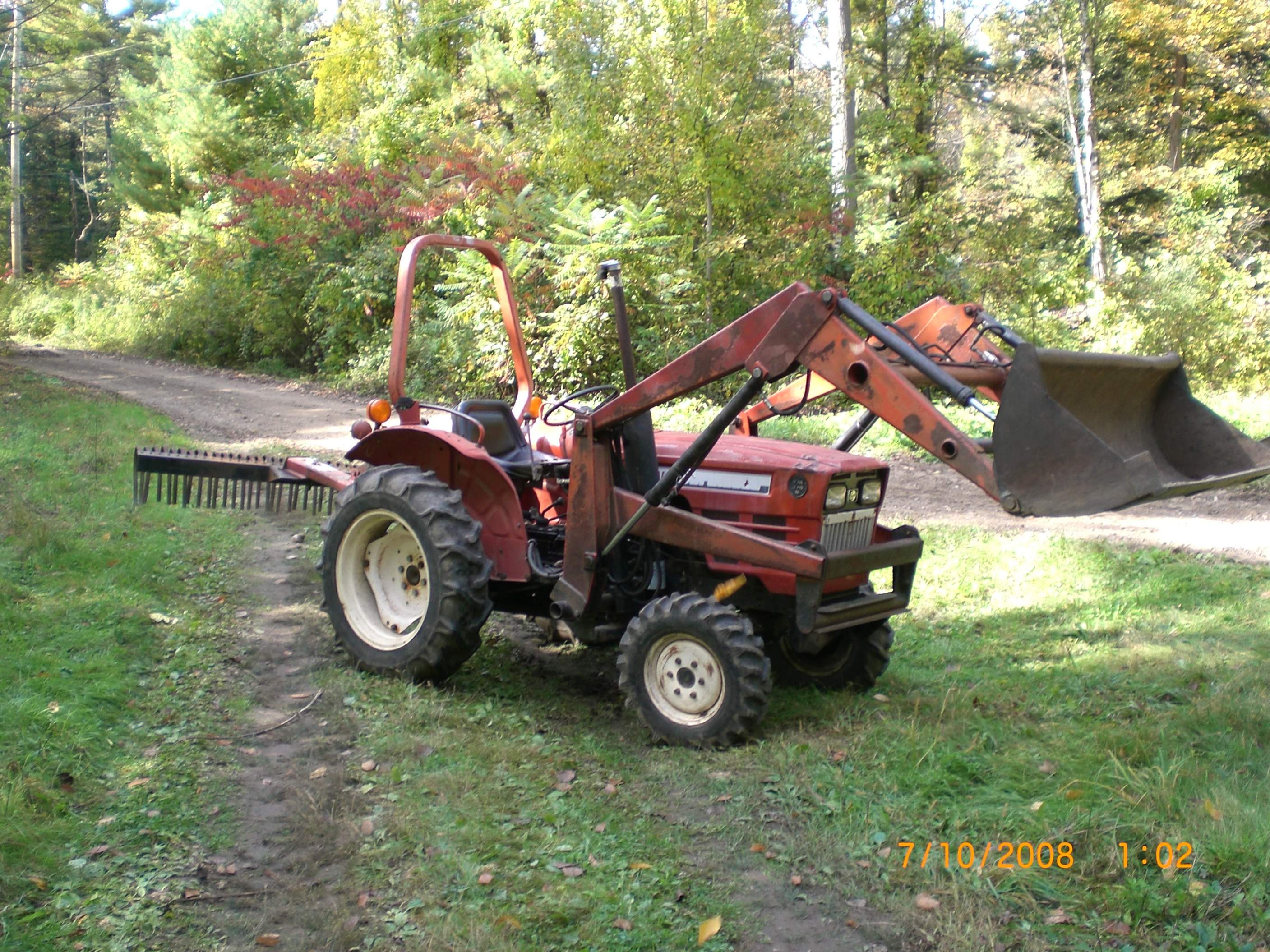

flip your frt wheels around the correct way, it will help steering.
   / howdy everyone!
#9
I didnt know my wheels were on the wrong way? I just got it like this... are these wheels supposed to be bolted on a different way?
   / howdy everyone! #10
Look at my previous pic. Flip them around so the "dish" is in.
