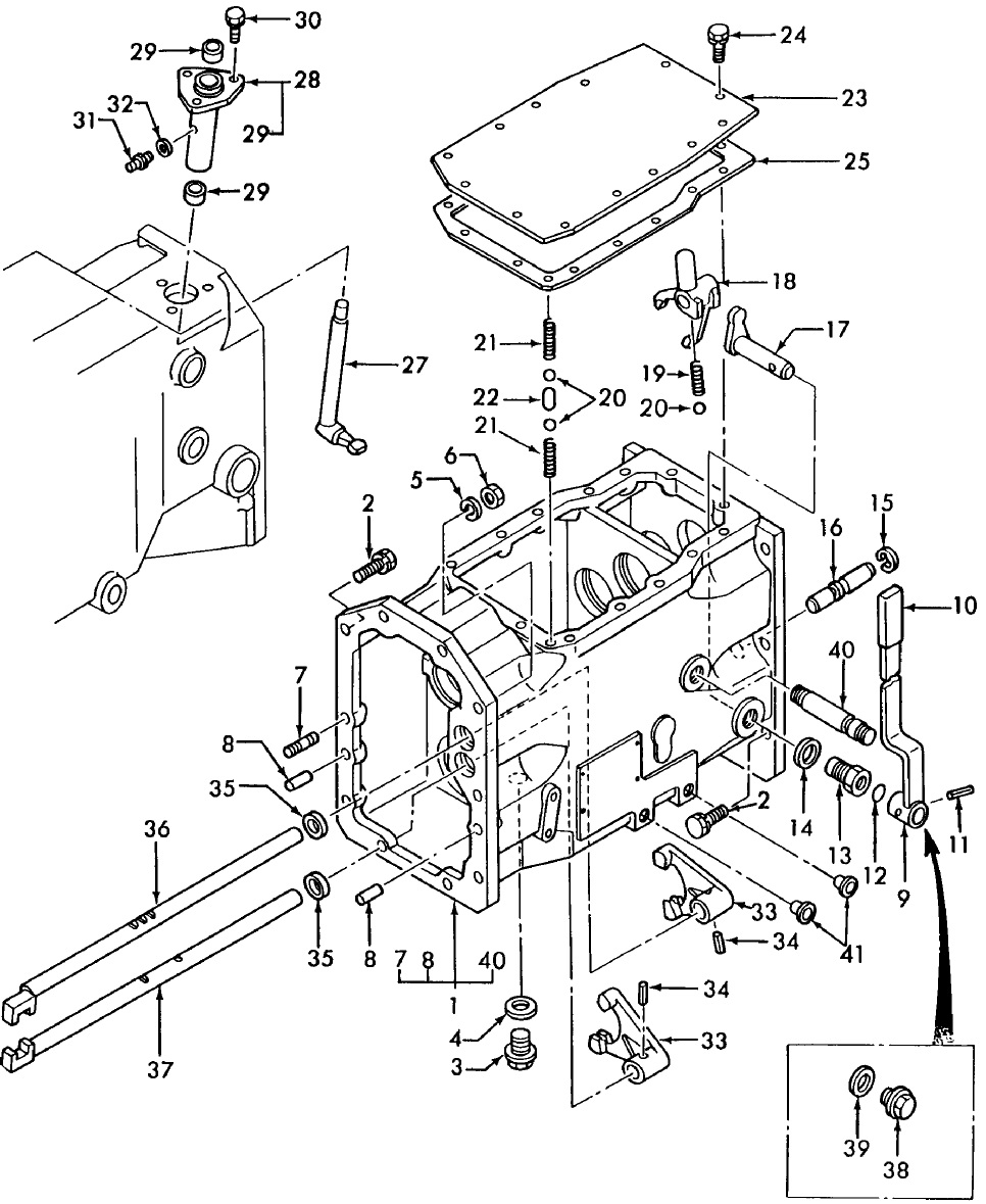

Jinman...there is a slide lever in the left side middle of tranny, it moves real easy but I can't tell that it engages anything...the driveshaft for the front always turns no matter what I do...is it not supposed to in 2wd?? Also there is a foot lever on the same side rear that I have no idea of either...:-/

Ok...but that's just it...I am not sure which lever engages the 4wd....this tractor was in a fire so there are no labels, colors or panels...I've figured out the pto lift, pto engage, 3 speed movements in forward and reverse...and thanks for the diff lock!!! That's exactly what that is...:)...oh!! And the mid pto too!! I've figured out which one that is....soooo I think the 4wd lever is on the left hand side floorboard...it moves back and forth real easy but still not sure if that's the engagement...is yours there??

My tractor is much larger and is a "deluxe" model, so the levers are quite different, but I've copied a parts diagram that clearly shows your FWD lever. In the illustration below, it is item #10. It attaches to a shaft, item #17 and drives the shifter fork, item #18. This should help you locate/identify your correct lever even if it is burned.

go to partspring.com they have break down of tractors and parts that will help in iding controlls.
