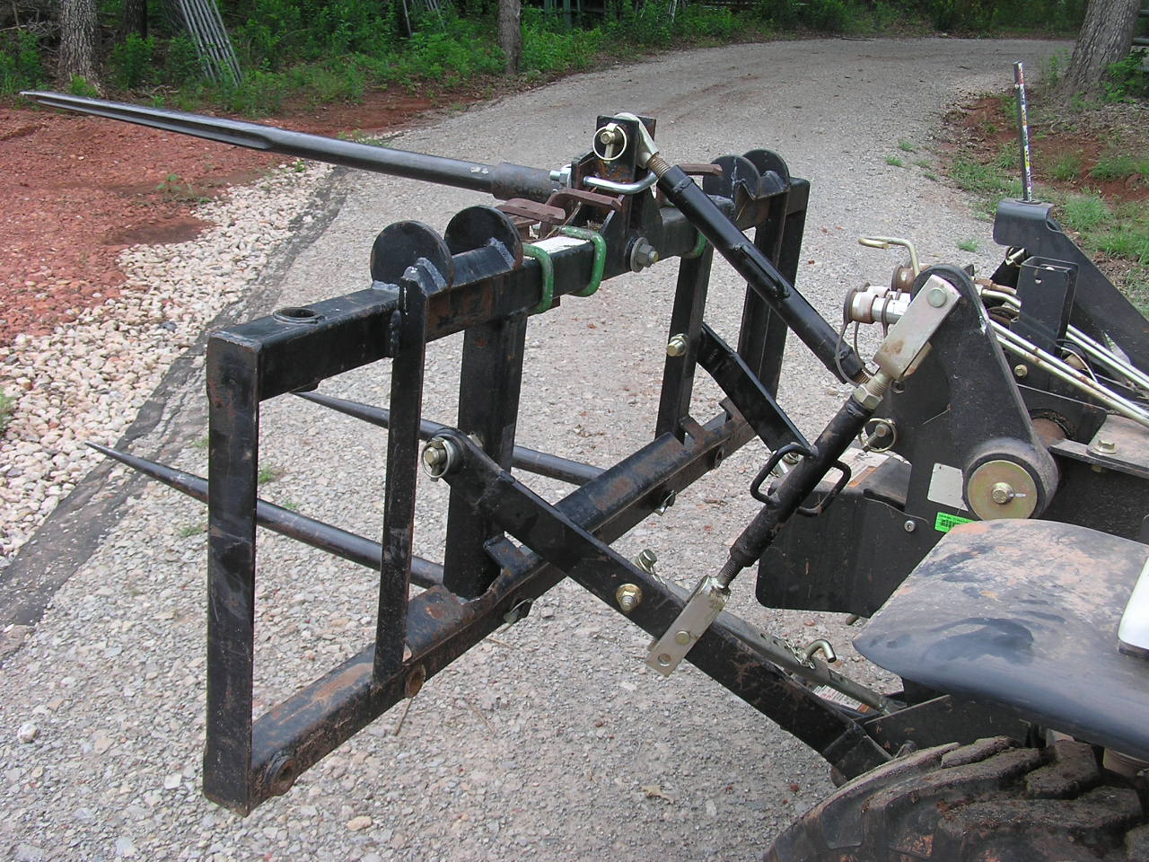

A Howse 3 point fork lift came with the used tractor I recently bought. It is a model SXFLPF. The tractor has a quick release bucket (LS 3104). What I would like to do is have it mounted on the FEL. I have been looking at a number of references for these forks but don't see how I can convert them to the FEL without welding to a quick detach plate. I would like to retain the option of using the 3 point if I choose at a later date. The 3 point lift pins are held on by 4 really stout Ubolts. Could the same Ubolts be used to secure to a quick detach plate? I've looked at the Howse web site and could'nt find a method to do this conversion. Thanks for any ideas.

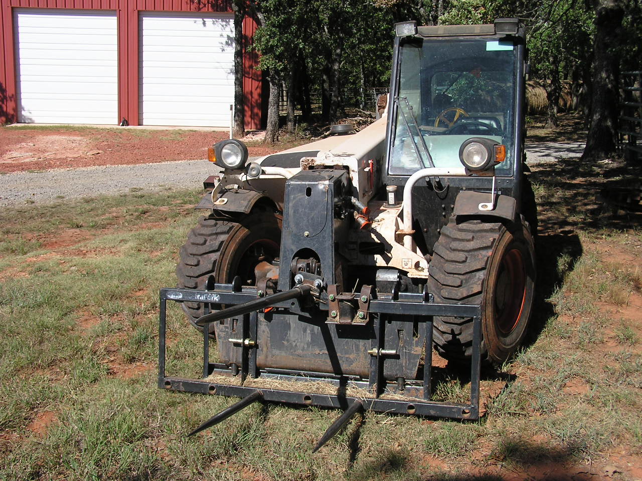

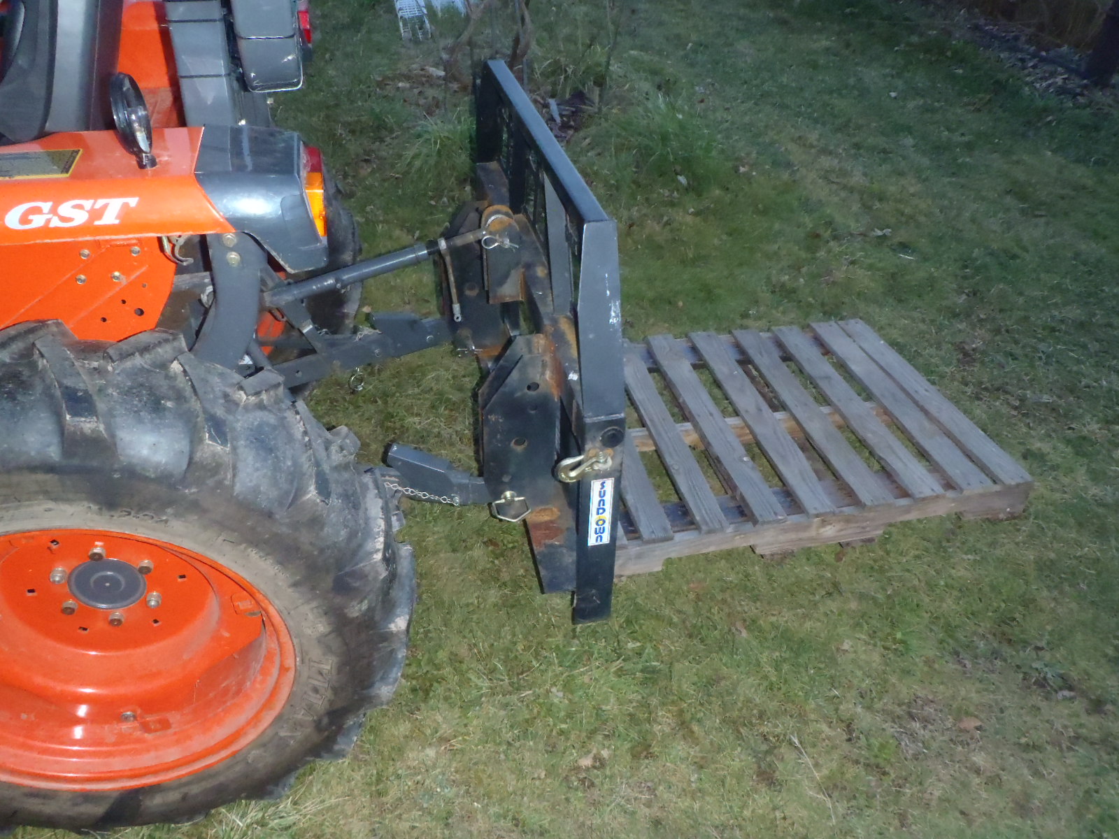

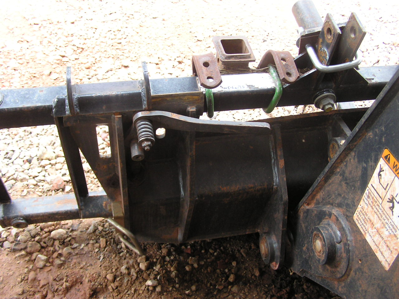

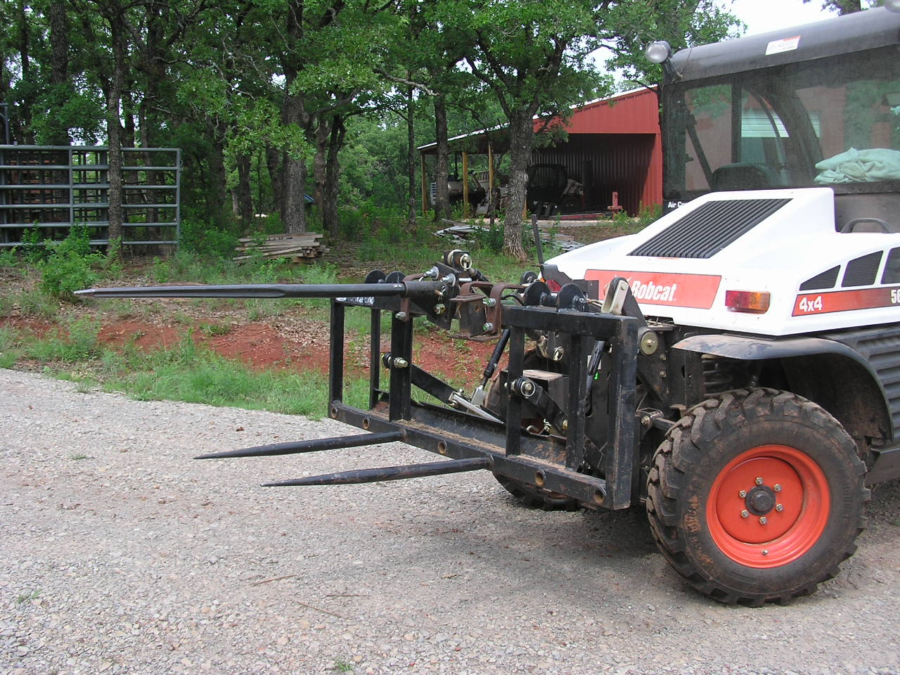

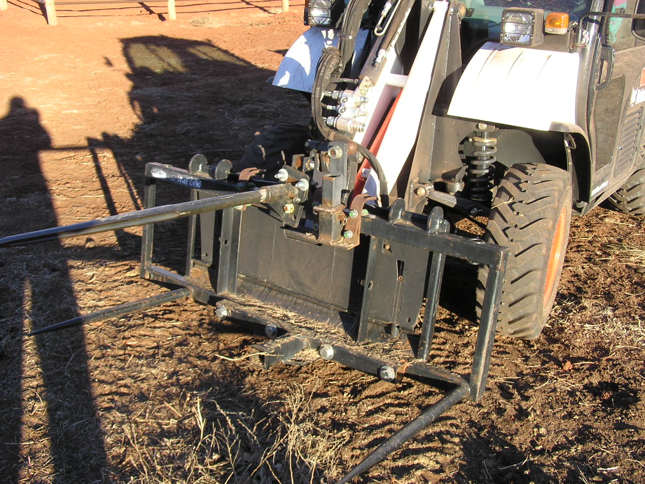

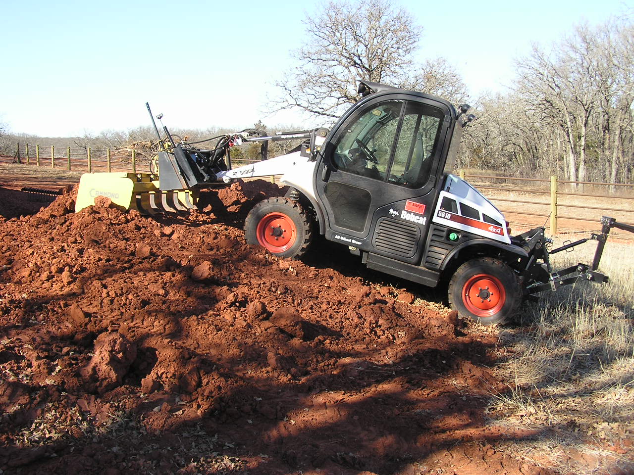

Or you might be able to make it work like the Speeco Ultra Fork, that mounts front or rear.
On the 3 point
On the Quick Attach.

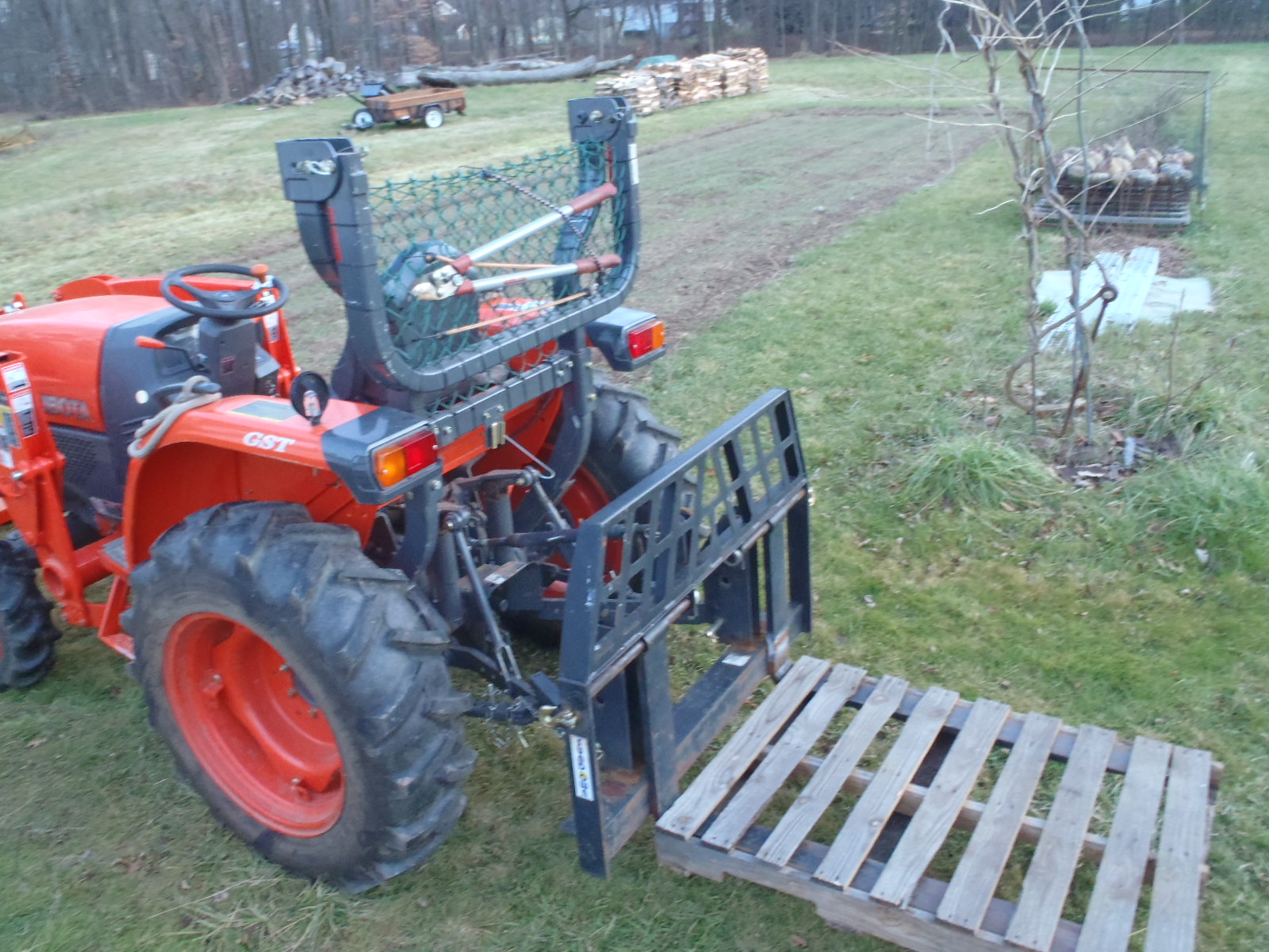

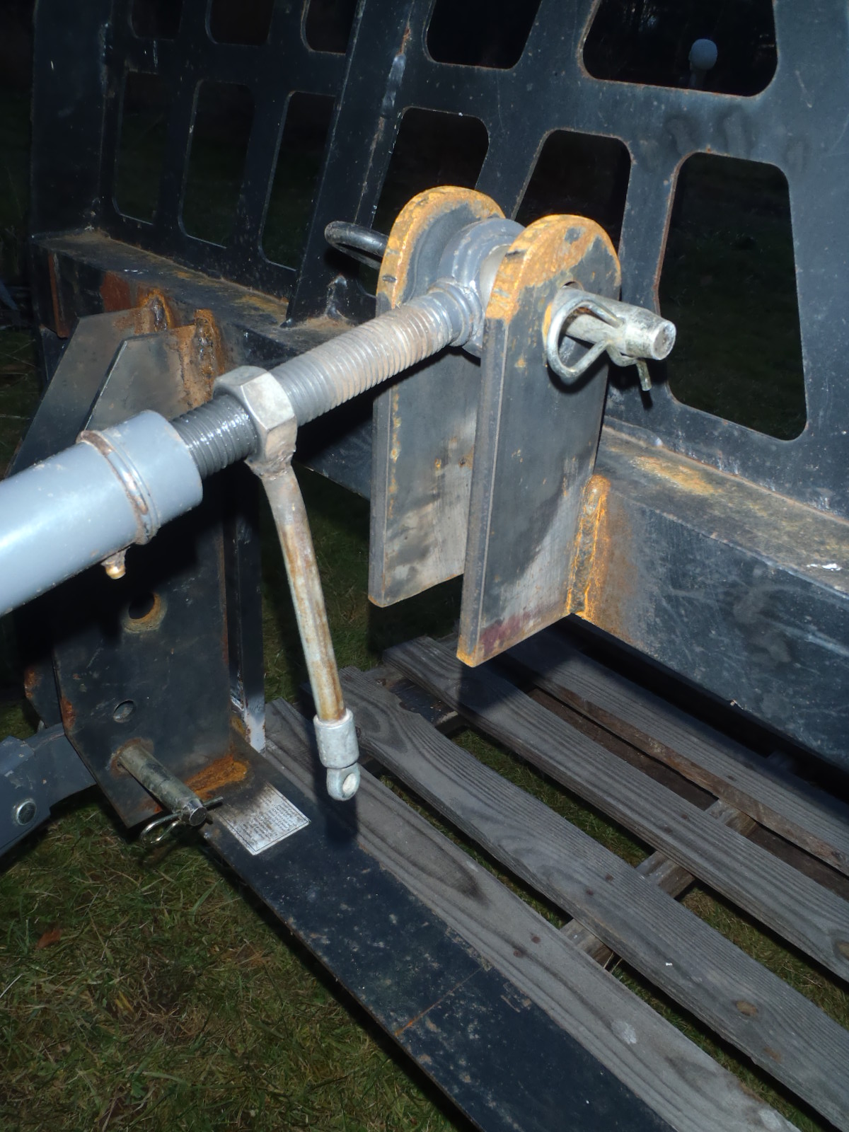

I adapted a pair of used FEL forks for 3pt firewood service:
Amazing how much weight they can lift and the traction gets better as the weight goes up!
Conversion was easy - just added a clevis for the top link and bought some long hitch pins
for the lift arms:
