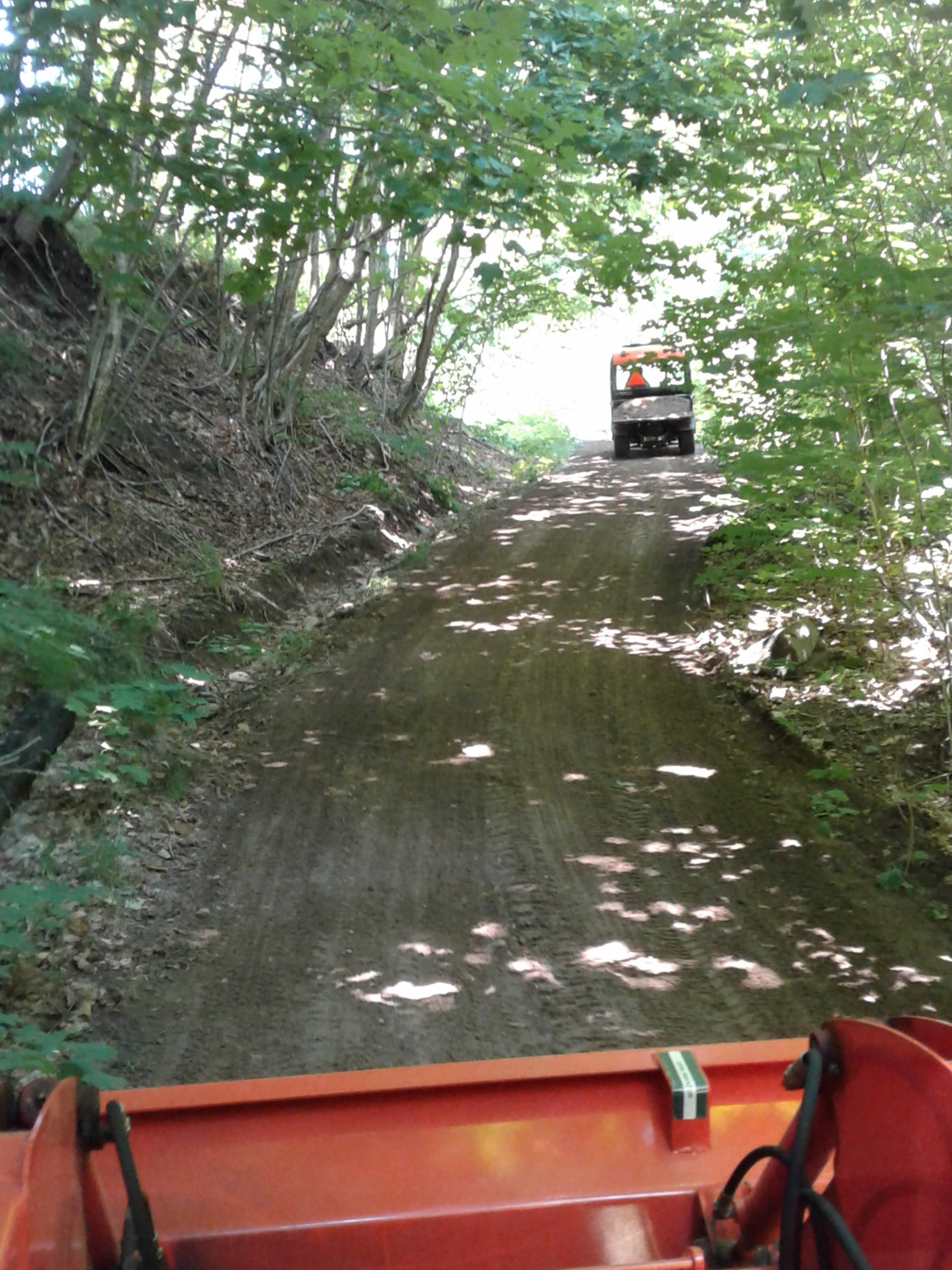

I'm only at 620 feet above sea level, but as far as power.....just know they will lose lots of speed, but they never quit pulling. Even when it bogs down, it will still climb idling.
It's hard to tell the steepness in a pic, but my RTV will run 25/26 MPH on the road, verified with my Garmin GPS.
On this hill in my back yard it will run drop to 10 MPH empty, 9 with AC on, or as low as 7 with 2 buckets of pit run gravel from my B2620 in the bed and AC on high. But as soon as it drops if I lift on throttle pedal it picks right back up.
So if you are an ATV trail rider that likes to go fast, you will be disappointed. But me, having done all that and having gone fast racing motorcycles until 2003, I now take the RTV before I ever get on my atv's. I go cruising the trails, I get to see the scenery at lower speeds, it climbs any hill at idle without having to rev and attack the hill, I'm comfortable and clean in the cab, and what burns half a tank of fuel in my atv's, the RTV doesn't even move off full on same loop.
Last weekend I did a test too. I ran up this same hill again with my Boss vee plow on (400 pounds) and a full load of maple hardwood blocks in the bed, and again.....9 MPH up hill. I think it will do ok for me plowing this winter.
But as happy as I am.......if it could top out at 30 MPH, it would be absolutely perfect to me.
   / HP Rating for D1105 engine #17
I can add also....in this pic where I haul gravel up my bush roads, it will make trips WAY faster than I can make one bucket at a time with my B2620 tractor.
