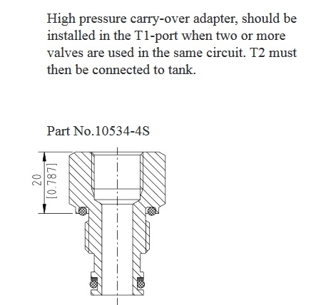

I need a HPCO (Power-Beyond) sleeve for my MF 1528 with Nimco Valve
  • Valve model: 10338-2S
  • Serial: 04-42
  • why is this so difficult
  • Can someone help me find the correct part

Hey, I actually got a reply with a schematic and I am able to order a part. It is a crazy price, but what are you going to do. Unless you know of an alternative.

If he had a lathe, it would be simple. Having the valve in your hand and a few measuring tools, the required insert could be made.
Lots of dimensions missing. Need skill in grinding tools. Boring. Knowledge of gland sizing and compression. IOW, experience.
/ HPCO (Power-Beyond) sleeve #7
The image wasn't meant to be a dimensional drawing. Only showing the shape. You need to be competent with your measuring tools.
No grinding necessary for this.
Yes, but simple as drilling and boring to thread size.
Available in charts.
IOW, experience.
If you own a lathe, you should be able to use it.
No need to make it sound complicated or expensive. These could be run off in a CNC machine in less than five minutes. I could probably make it in less than an hour
Grinding : Lathe tools for groove and chamfer.
Boring : Counterbore with chamfer.
Charts : Research.
Expensive: Overhead - How much does a CNC machine with automated accoutrements cost? Even a good standard lathe is $thousands from china.
Time : Yeah I could too, starting from a sample part. Maybe even two of them manually in just a few more minutes. The thing is weve got experience and some prepaid overhead.
