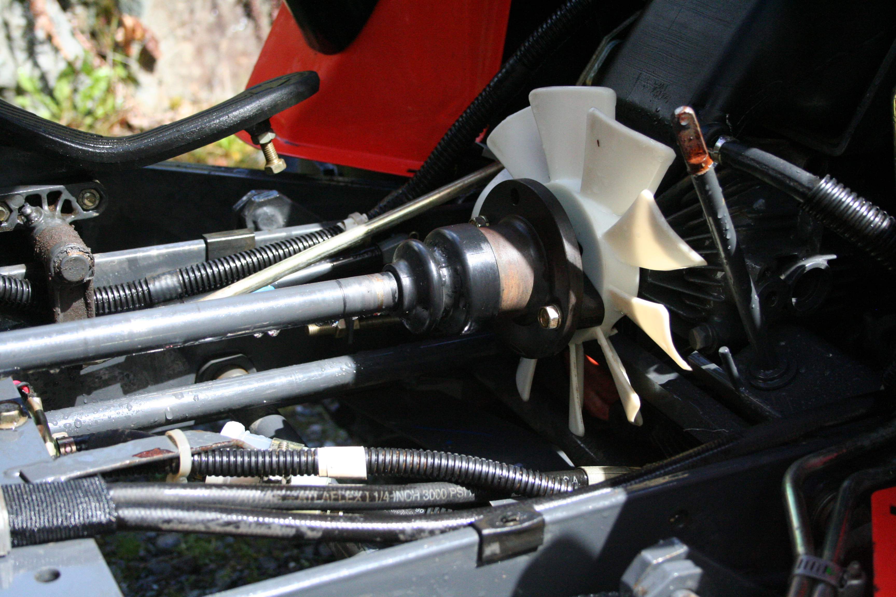

I noticed my front boot was torn during a fan belt replacement. This BX has only 52 hours on it and there has been no time when we drove it over something that would have gotten up there and torn it. I noticed that the rubber is very thin where the tear occurred. My fix was some black RTV for now. The boot itself is only 4 bucks from Kubota but the hassle to get the driveshaft out is a whole different story. :eek:
   / hst boots #18
I just got through replacing both drive line boots on my BX23. After looking at it for a while, I found that I didn't need to remove the fenders or the ROPS. By unbolting the floor pan from the fenders, and some careful manipulation, was able remove the floor pan to get to the drive shaft Removal of 5 bolts and I had the shaft in hand. Replacing the boots was a simple process of removing a couple of snap rings, and removing the CV joints. With the drive shaft out, replacing the fan would have taken an additional 5 minutes. The total job took me about two hours at a leisurely pace.
I guess I don't understand why Kubota would make this task so difficult in later models.
