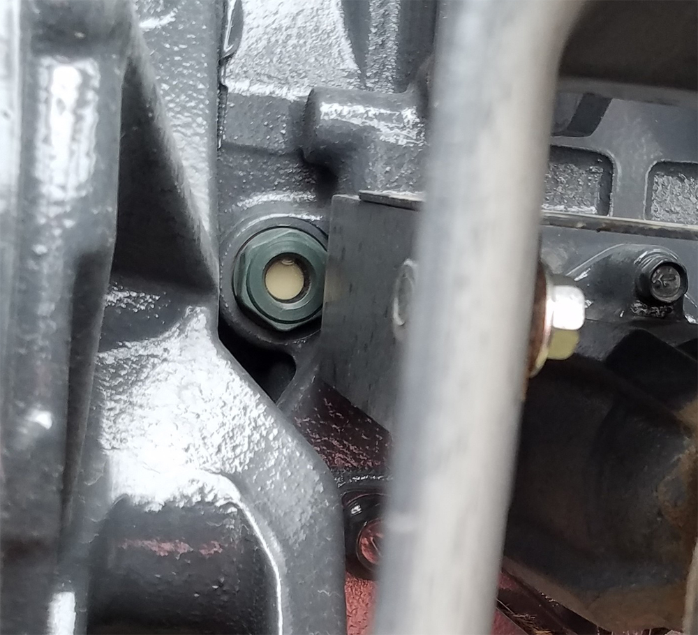

I took this photo this morning and was going to say that I don't seem to have a problem determining if the hydraulic oil is at the right level, but it occurred to me that I might have a problem if it weren't for the bubble at the top of the sight glass. There might be some red dye in my future. On a related topic, I have 30 hours on my MX6000 now and the engine oil is still pristine. Looking forward to the first service in a month or two.
   / HST fluid level (Sightglass) location MX5400 #32
I bought the JD hydraulic dye through Walmart.com. Got it within a week and added the entire contents (< 2 oz) as the instructions stated.
Definitely made a difference in visually seeing the hydraulic level through the sight glas.
If the unit is level front to back and side to side, it's overfilled. Should only be 1/2 up in the window.
In reality you only want the fluid to be just below the PTO seal and no more. Fluid against the seal constantly will cause it to eventually leak.

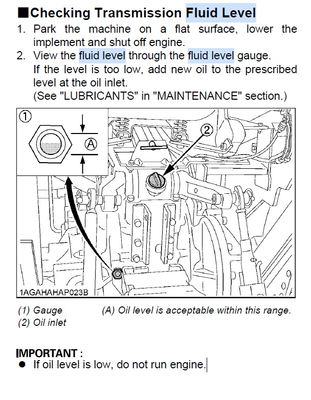

So your Kubota tech made it up. 😄 I would recommend being careful of what this tech advises you as the Kubota owners manual is clear on how to check fluid level.
In my owners manual it gives you the fluid level range that is acceptable.

Checked my hydraulic fluid sight glass yesterday. I had put red dye in it last year.
I see nothing. I added the remaining jug of hydraulic fluid (1 qt) but still nothing.
The tractor has 30 hrs and I see no leaks anywhere on the tractor.
