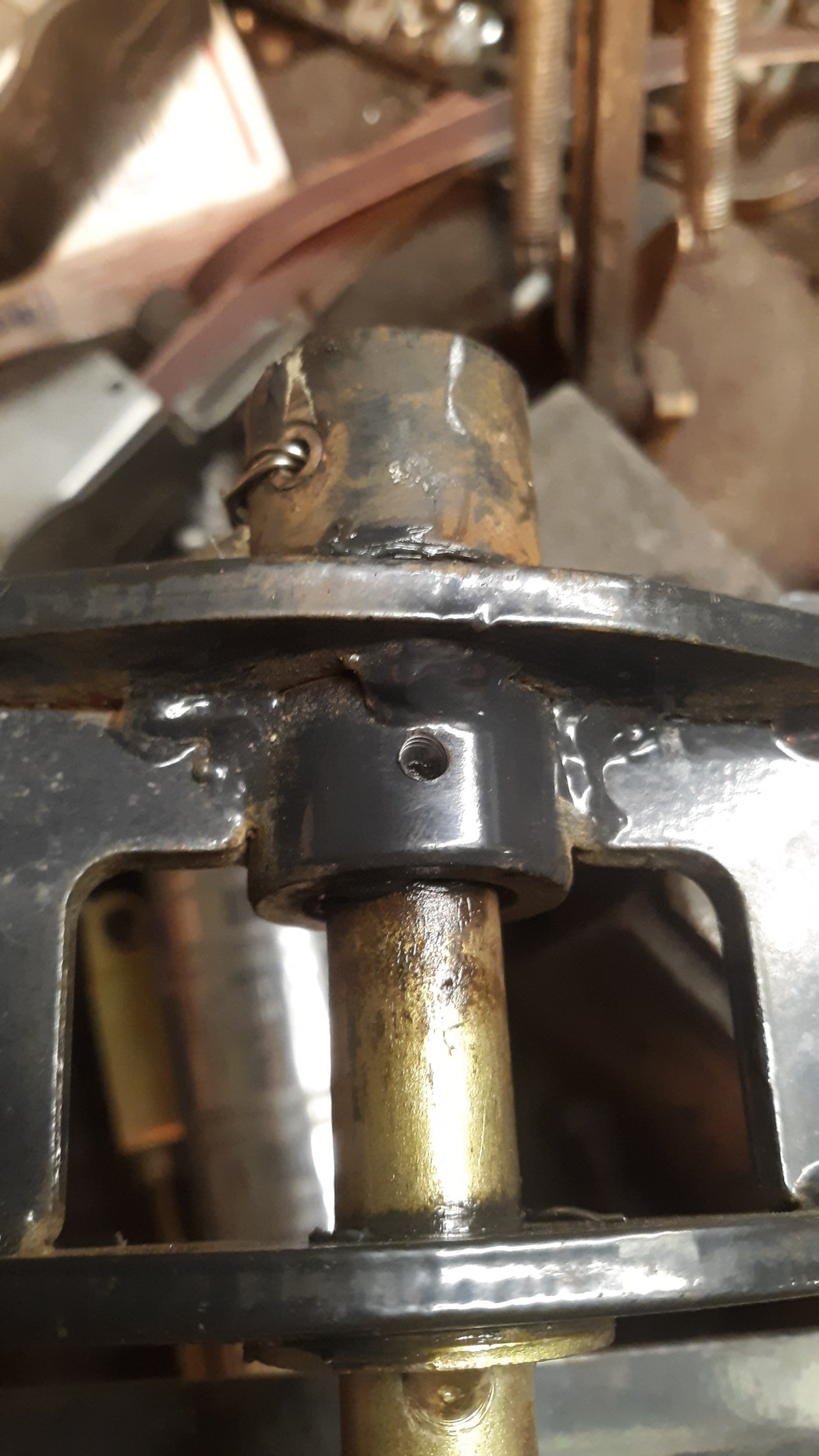

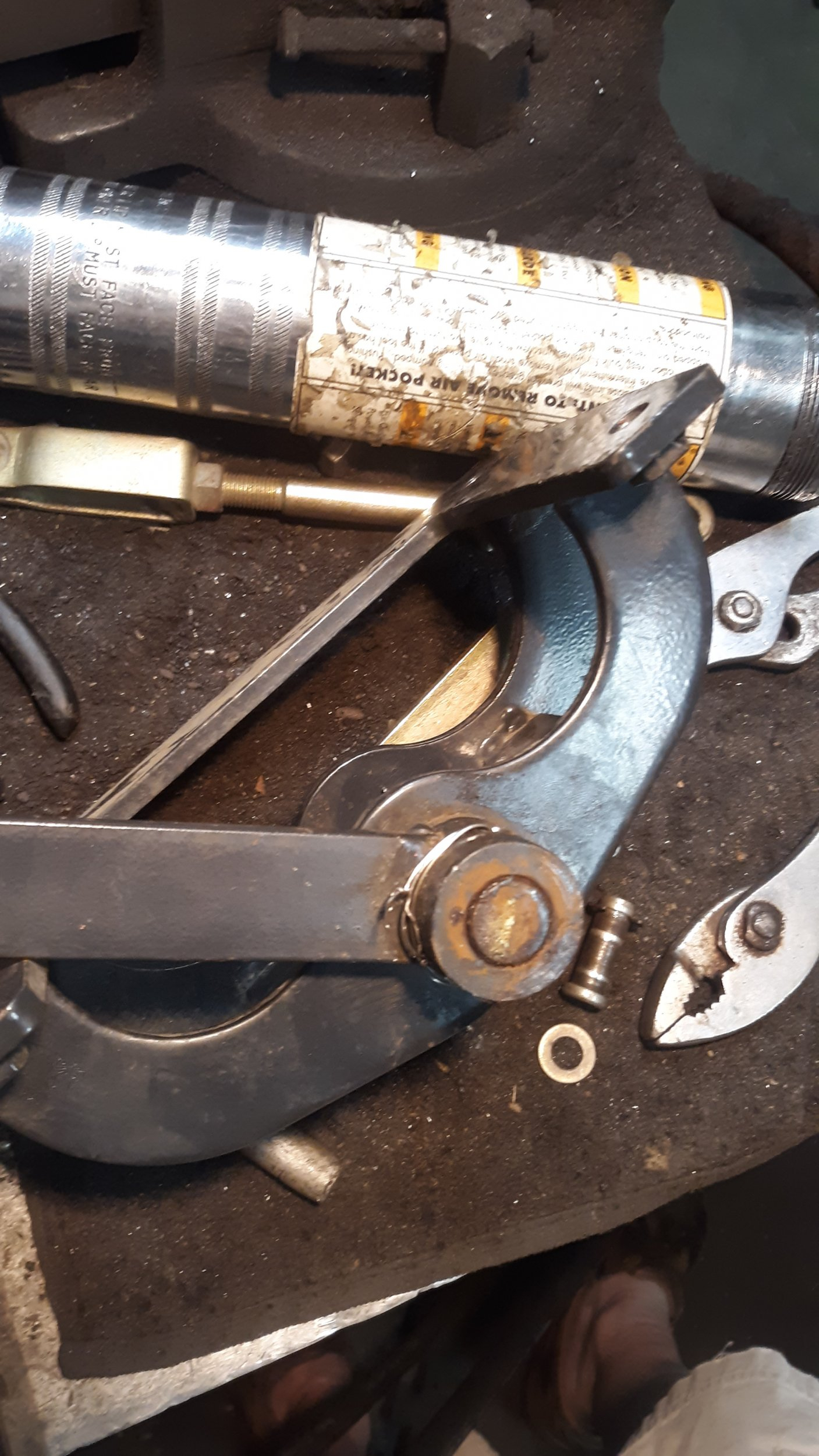

When my tractor was fairly new I had an issue with the shifting lever attachment roll pin working its way out. I put it back in and wired it with stainless steel wire. Over the past few years it has gotten very loose. Today I pulled the shifter assembly out. I drilled the roll pin hole to 1/4 inch and installed a new roll pin and wired it to keep it from falling out should it get loose. Before installing it I drilled an 1/8 inch hole on the underside of the bushing section so that I can grease this with a rubber tip on a grease gun. Hopefully this will stay put and not loosen up again. I had at least an inch os slop in the shifter handle.

How sloppy is the shifter? Look down inside and see if the arm where the lever attaches to is loose as a goose where the pin goes thru it.

I drilled mined out slightly and ditched the cheesy roll pin setup for a shoulder bolt with a nylok nut after the oem roll pin worked its way out the first time.

It has a little more play now than when I put the bolt in it a couple of years ago, but nothing like it had with the roll pin. It's not an ideal design; welding it solid did occur to me, but then you'd be in a real pickle if you ever actually needed it to come off for any reason.

That was why I didn't weld mine and went with a 1/4 pin. I can still go bigger if I ever have to.
