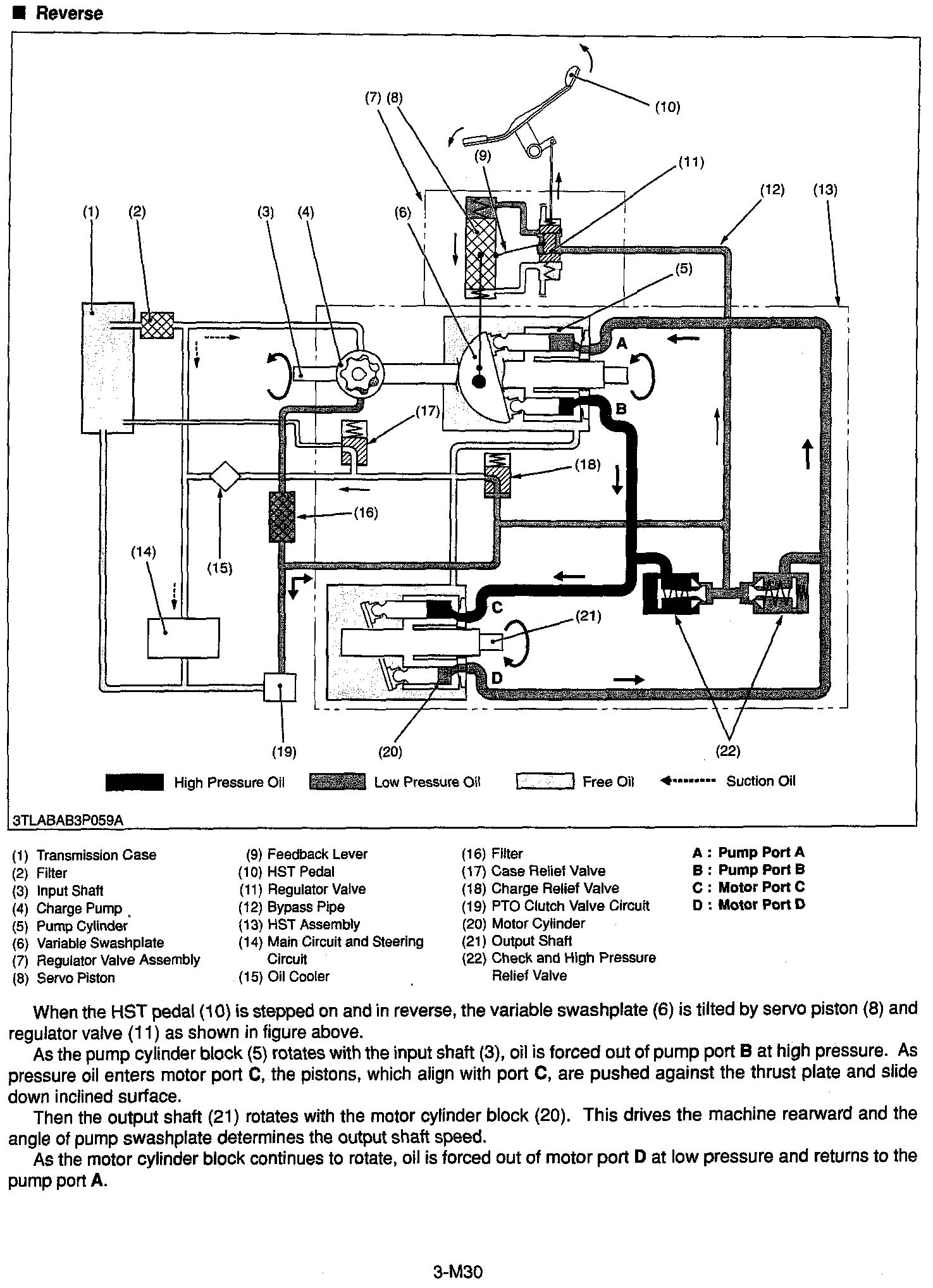

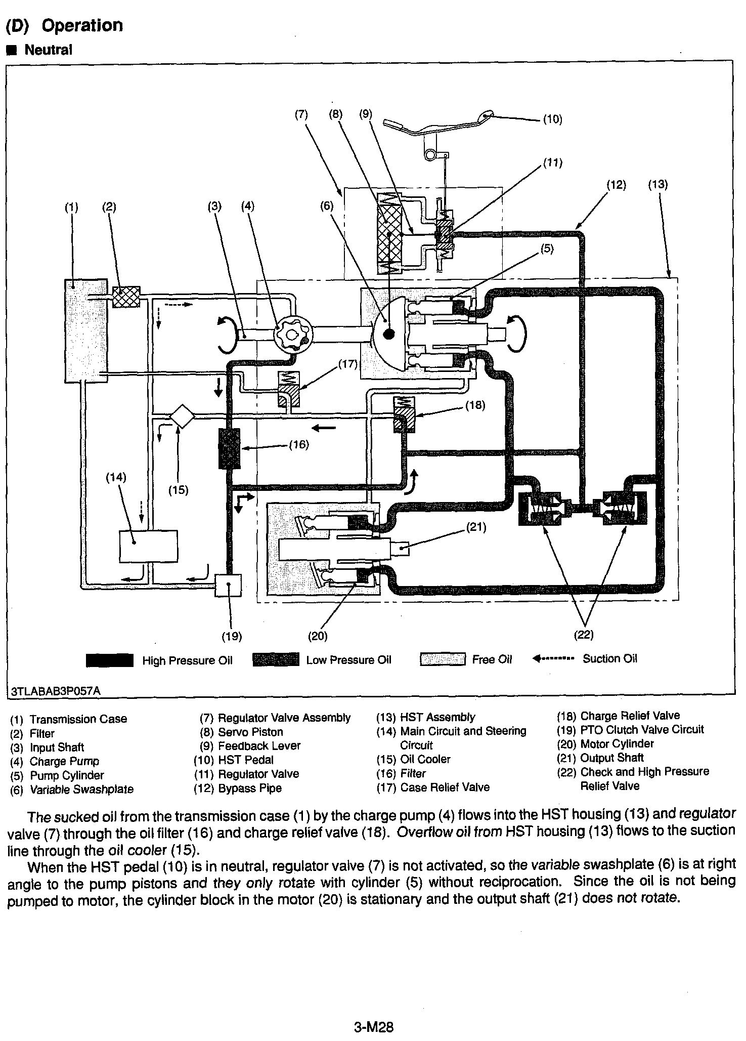

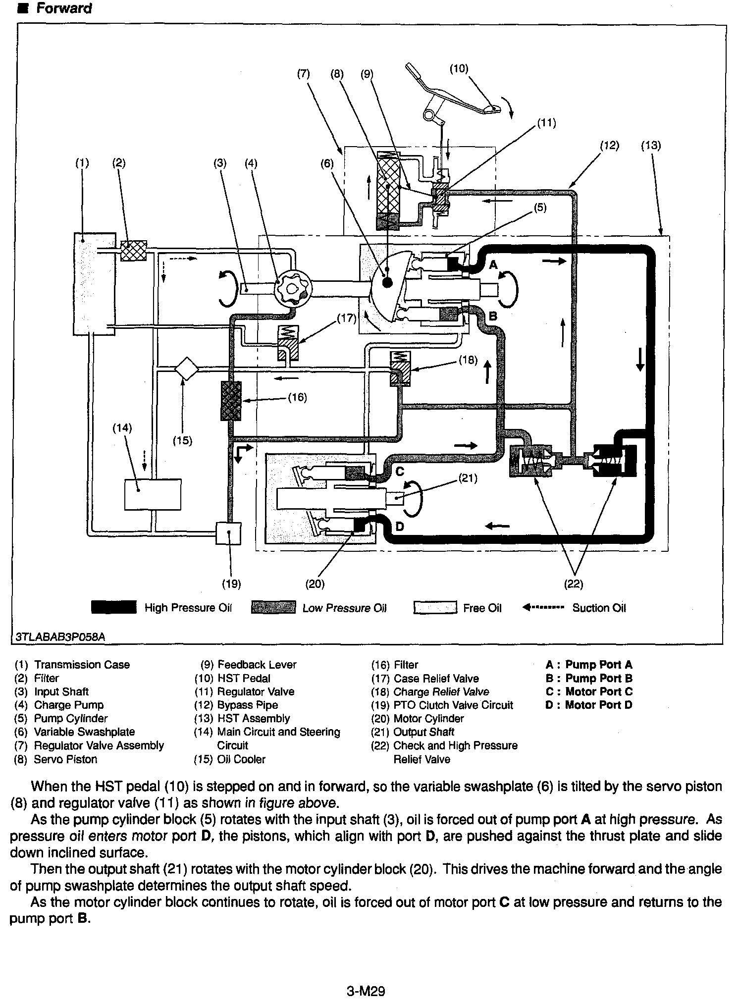

/ HST problem L4330 #8
Perhaps these pics will help ...shows operation in neutral, forward and reverse ...per the legend, the filter is at #2

#9
I have the shop manual and seen what you are posting.. There seem to be a few solenoids. one of them could be bad.. I don't see a screen so I will check the filter if not it will go to the shop..Thanks
