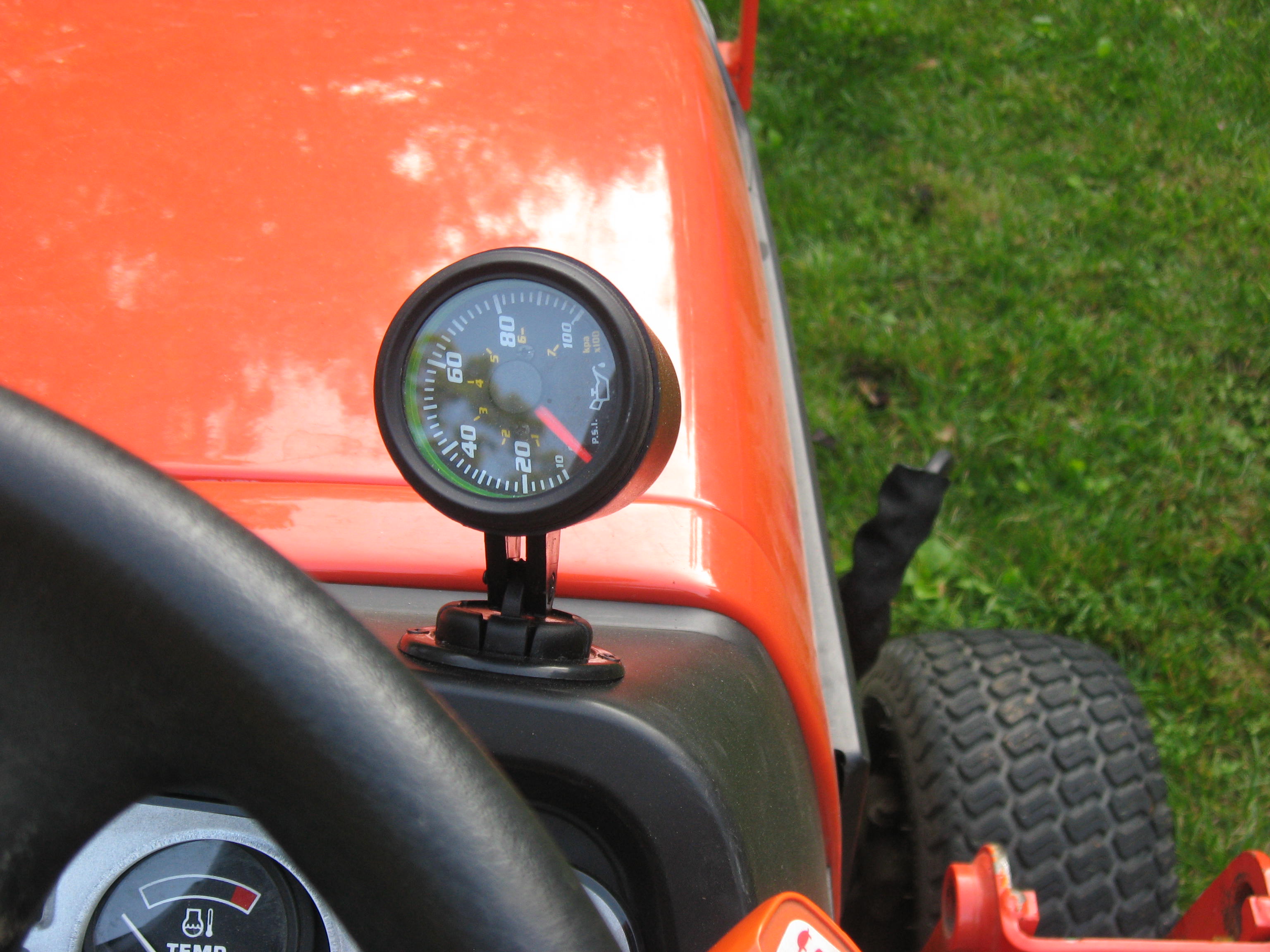

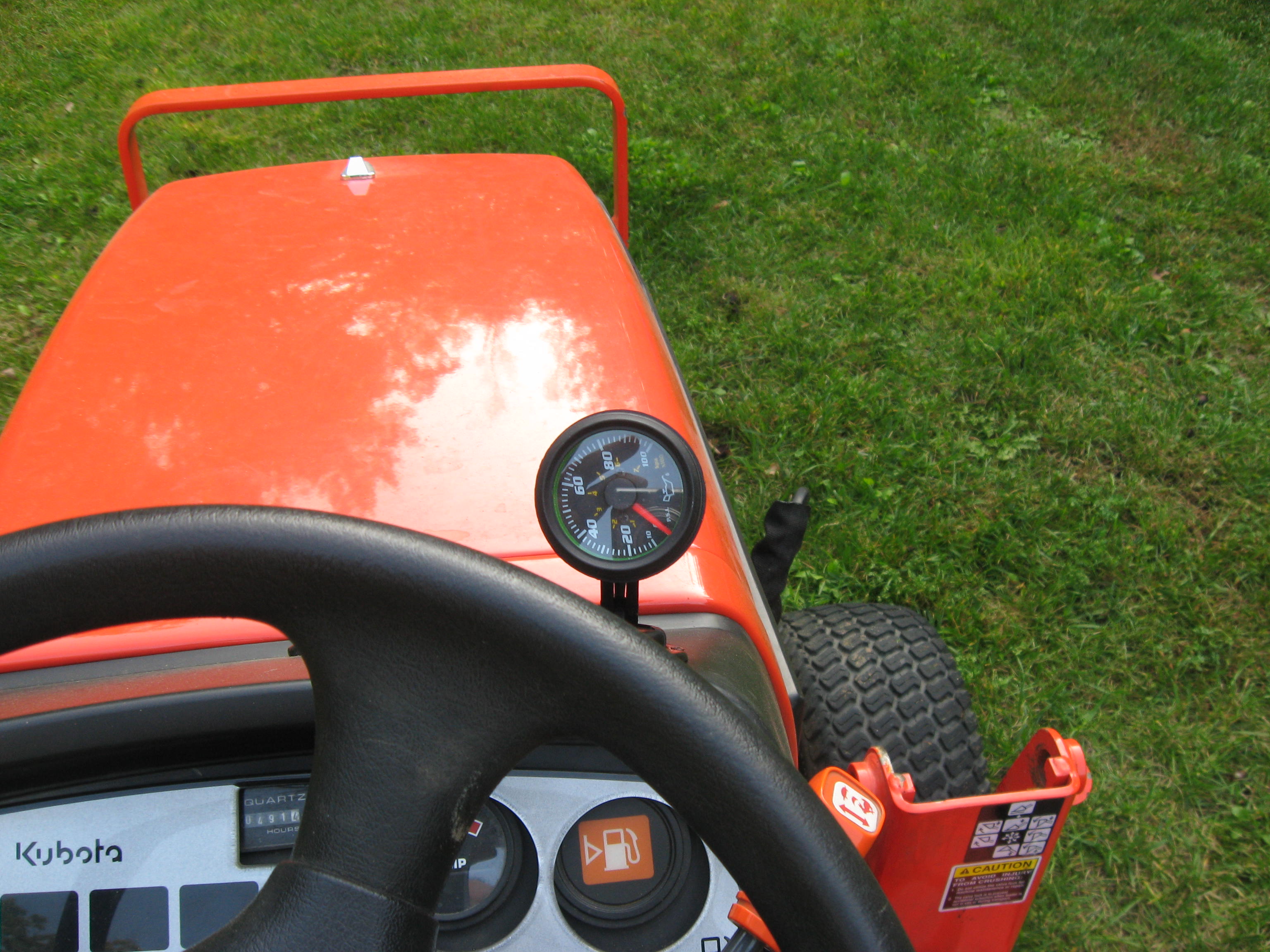

All done with my HST repair. Replaced the unit with a new one and tested it this weekend. Moved 11 yards or topsoil with the FEL and mowed my lawn; new HST is working flawlessly. I did like Matt J and installed an oil pressure gauge to monitor my charge pressure, which stayed consistent during the latest workout.
If anyone is attempting a similar repair, I would highly recommend taking a lot of pics and being very patient.....it's totally doable for the average DIY'er.
FYI, here's a couple pictures of my gauge install.
