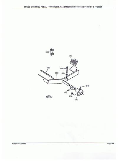

My Kubota B7100 has an adjustable bolt and locknut that will limit the travel of the pedal in reverse mode.:D:D
Others may be different.
