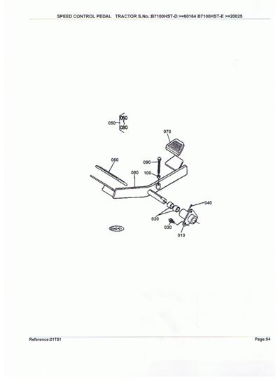

Reverse speed control on a B7100 HST.:D
Parts # 90 and 100, bolt and locknut are all there is to it.
