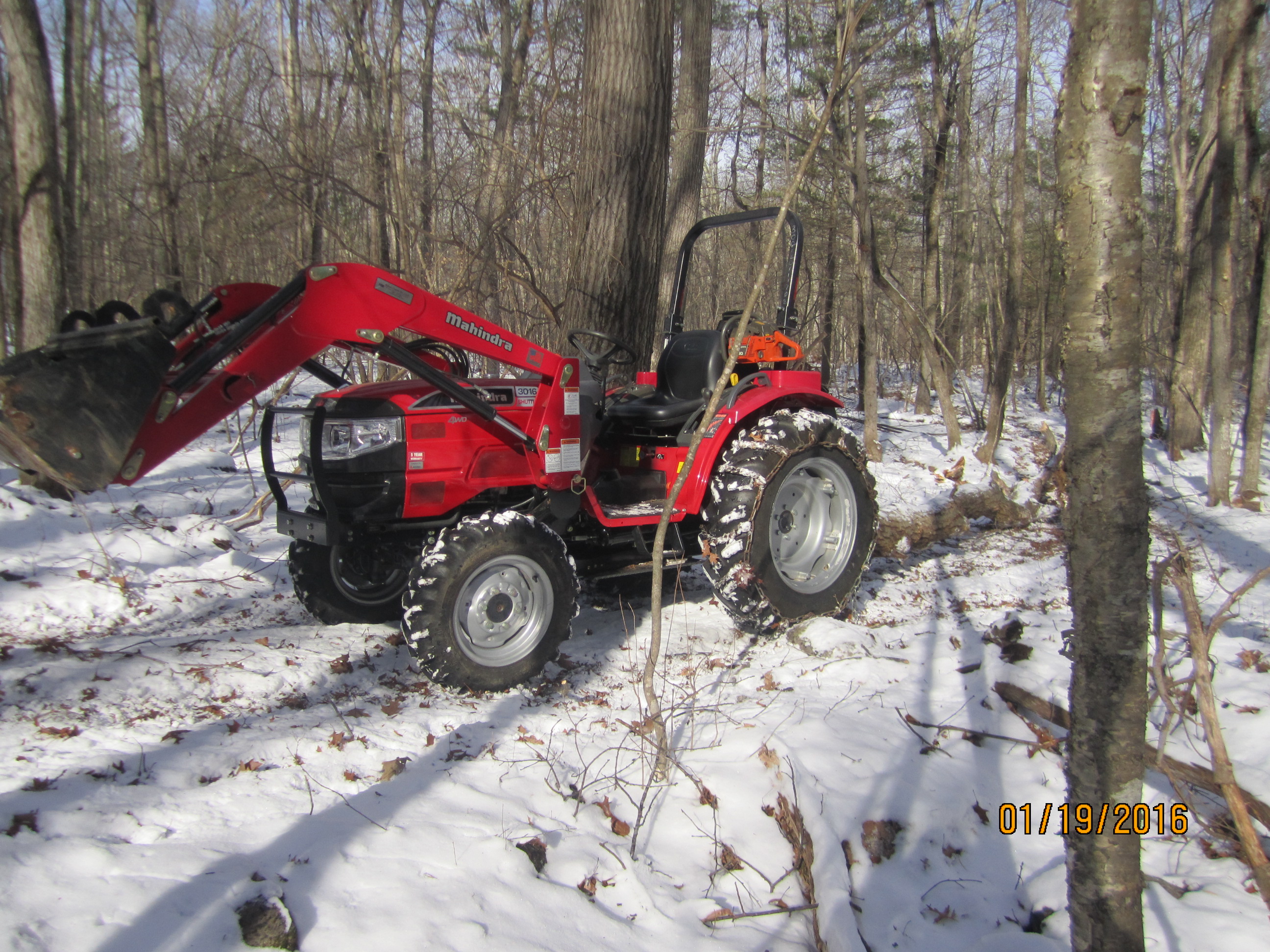

I was a die-hard gear guy. I still am but less hard so I will preface "was". What I have learned operating both are several things:
1. Hydro seems more effective to me for heavy tasks if you have larger framed tractors of 40-45 hp or more.
2. I am "wired" for the intuitive "pressing the pedal down makes more power". This is not always true for a hydro where sometimes you need to "let up" on the go pedal. I am coming from a drag racing background but this is enough to make me nuts. How are you wired?
3. Hydro is infinitely easier to operate and much more efficient for back and forth work imo. I wish I had one by a long shot this past fall when I was leveling my bil's indoor arena.
4. Try out your tractor you are looking at first. 34 hp may be insufficient for your needs with hydro. I tried out the same tractor in geared and hydro. Both of lower hp of under 30. For the work I do mostly (skidding and plowing snow), the geared acquisition was a no brainer for me. The hydro was screaming its guts out to do the same work the gear was loafing with in 3rd gear. The pic shows the tractor pulling a 30' oak stem up an incline in 3rd and about half throttle. The hydro version had no chance of doing this wasting more fuel and much noisier.
5. If I had to buy a tractor today and for what I do, I'd get a 45-50 hp machine with hydro. Hydro does come with a premium price tag but that evens out in convenience.
6..This site has a few of what I call "sheriffs" telling you when to shut up and how to think. Regard these personalities as needed.
