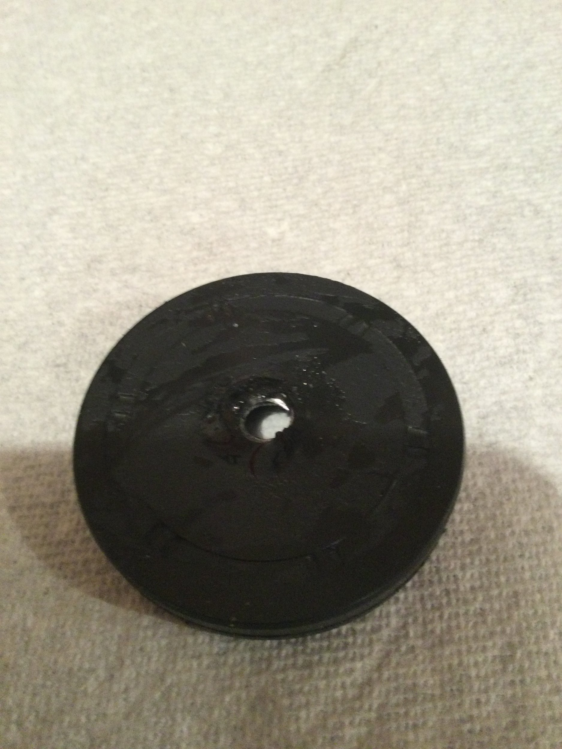

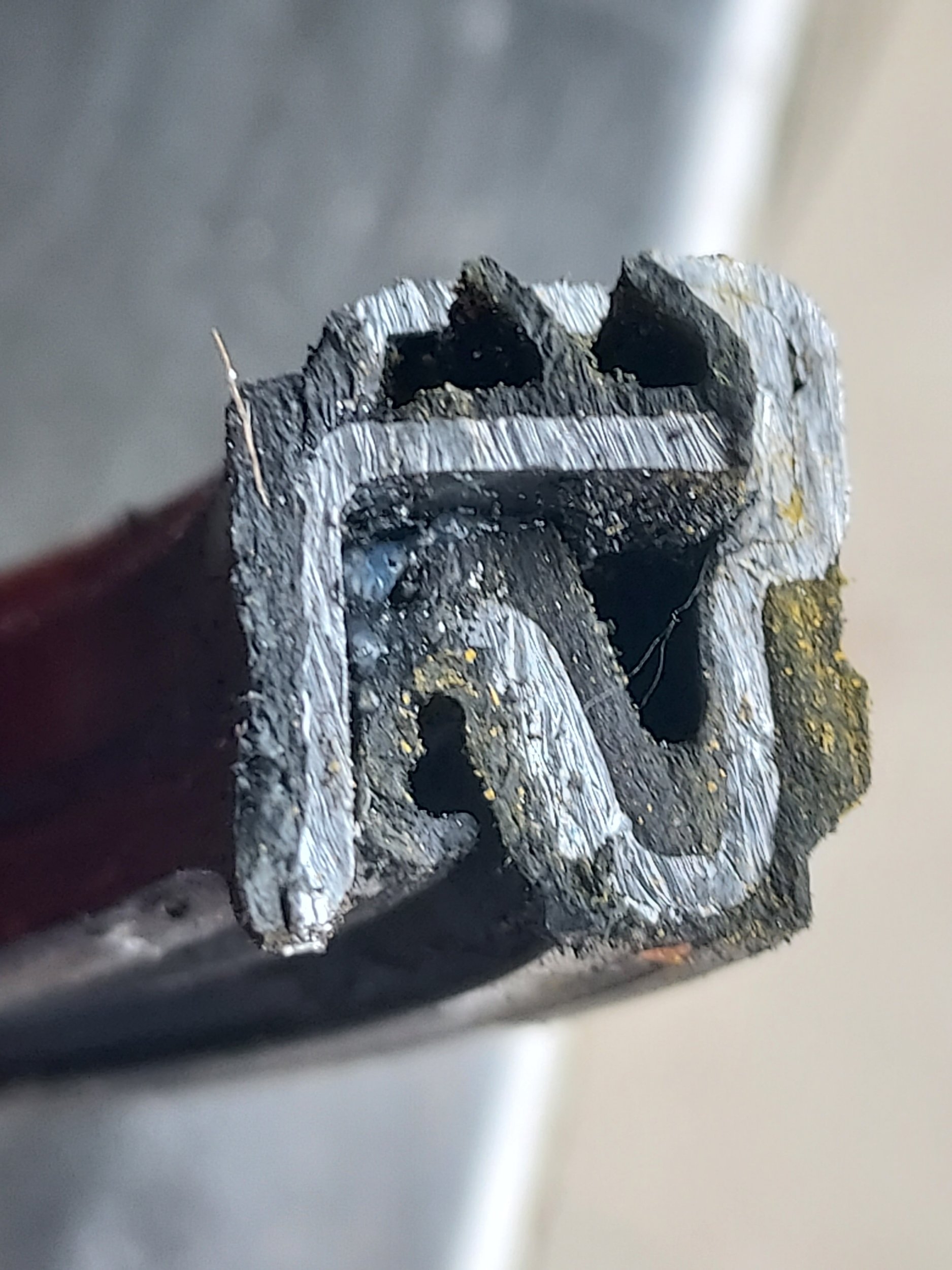

Please see new pictures for this post. The left picture shows the metal sleeve that is part of the seal assembly. The complete seal is shown on the right.
The second picture shows the rubber coated plug from the bottom of the spindle. The plug has a hole drilled into it and then a 5/16 X 1 1/4 sheet metal screw is installed to push the plug out, this ruins the plug but gets it out quickly. Cheers, this is on a MF 1528 tractor.

Thanks Torch... The photos I am sure will help people out to understand the type of seal/what it should look like. Not sure why I never took a photo of the new seal.

I followed the excellent directions on taking the axle apart but got to the step of sliding the housing off of the fixed axle. After repeated attempts using a pry bar i tried to get the new seal apart which I ended up damaging, and then cutting apart . If your tractor calls for a 6240892M93, this is a two piece seal which doesn't come apart. The inner piece has a rubber liner that replaces the "speedy sleeve" but it must slide off of the axle to remove the housing.
