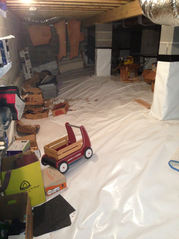

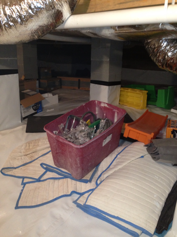

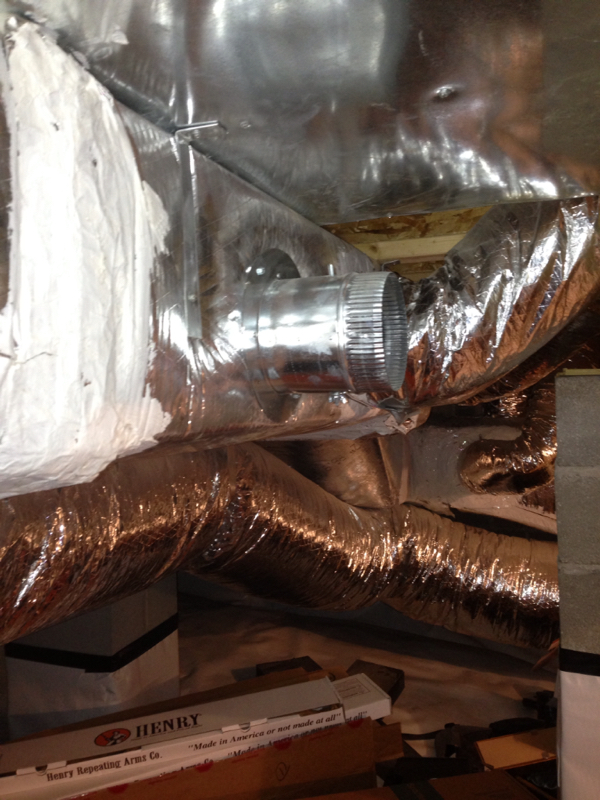

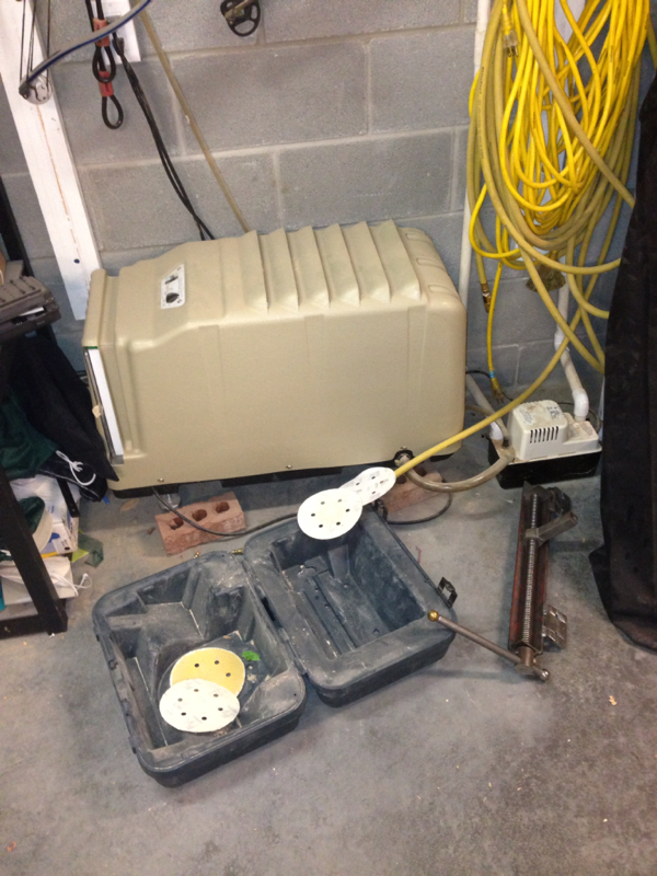

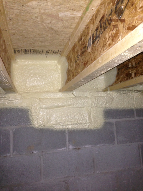

   / Humidity in crawl space #9
The brick on the outside is solid, but they did put vent holes in the block. I insulated the joist and vent holes, and put in two air vents. Before we did it the joist were starting to mold because the humidity was so high. Now it is probably drier than the rest of the house. image-4130872612.jpg image-3298831808.jpg image-3841319994.jpg image-2415404756.jpg image-202925585.jpg
