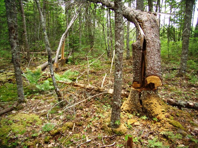

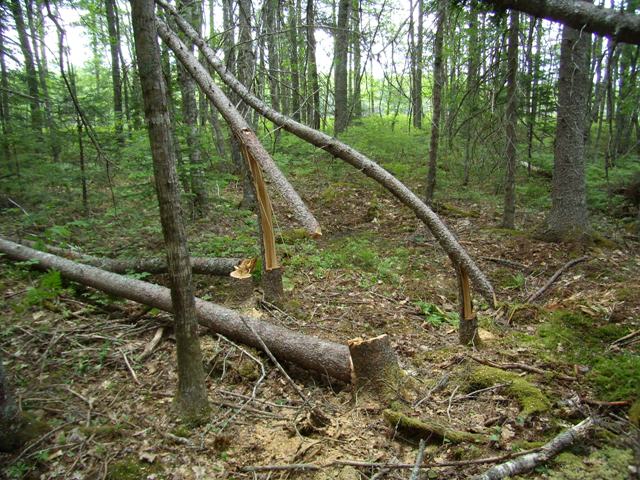

So I find about 5 or 6 windblown trees that have been that way for ??? as I didn't see them fall in a location that is quite inaccessible to a bucket truck without a doing few days road building.
They get notched and are down by next morning. Thats faster than the bucket truck gets there.
It's also faster than getting in other proper equipment.
So, do I let them hang for longer or get them on the ground in a manner that I figured was the safest??
Or???:D
