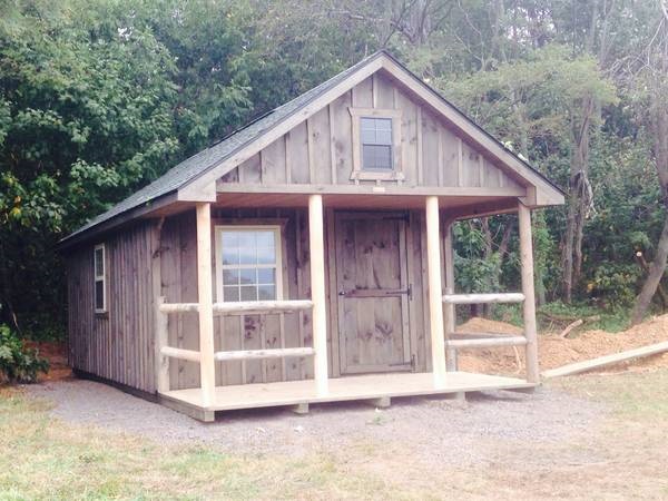

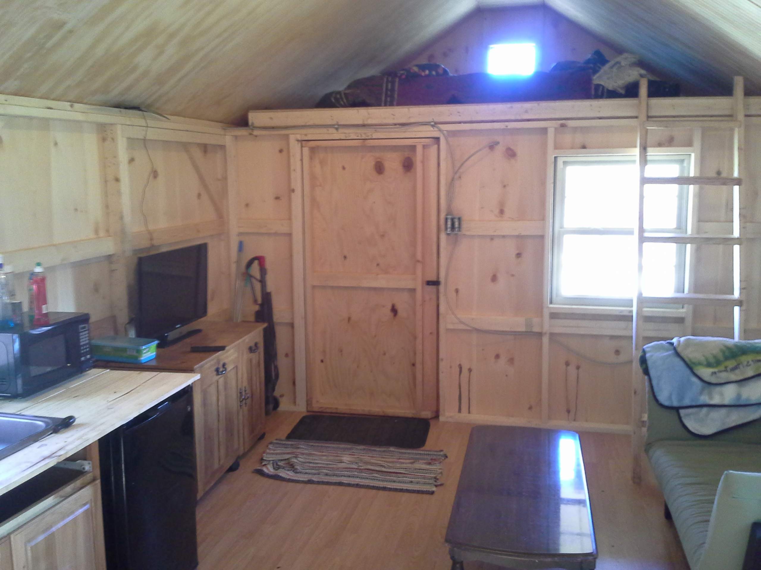

I agree with coobie and the ceramic plate LP heater. We recently bought a 12x26 pre-fab hunting cabin that we rent to hunters. I added a bathroom, shower, kitchenette and heat. I started out with a few different electric heaters but quickly found out they just didnt have the BTU's to heat the cabin when it got below freezing outside.
We kicked around the idea of a woodstove but we were concerned that a novice woodstove user could easily burn down the cabin rather quickly. So we finally went with a 12,000BTU Kozy World LP wall mounted heater. It works great and no worries of the place burning down.

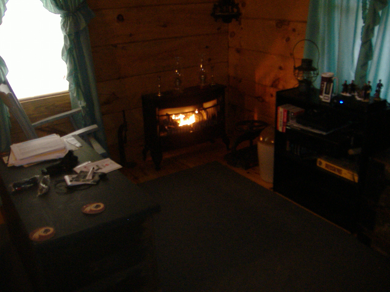

Our cabin has standard HVAC that provides A/C in summer and heat (when not present during fall/winter. When I'm there in the fall and winter, I use a propane heater that really keeps the place comfortable. It is ventless, so very efficient and comfortable. DSCF0340.JPG
