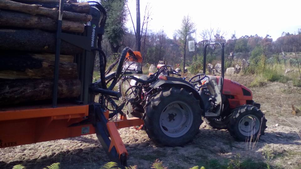

Now imagine having a front + rear locking diff + ground PTO powering a logging trailer with traction to the wheels and a crane on the woods? Makes an awesome combo. Used to be a very common setup, now they are all changing to hydraulic powered wheels on the logging trailers and using the PTO to power a big PTO pump.
   / Hurlimann Loader valve #12
Nice. It's humbling what some designers come up with. Does the ground speed driven trailer also need to sync with each tractor's tire size?
   / Hurlimann Loader valve #13
Yes they usually have a gearbox on the trailer where they will change gears to match the tractor.

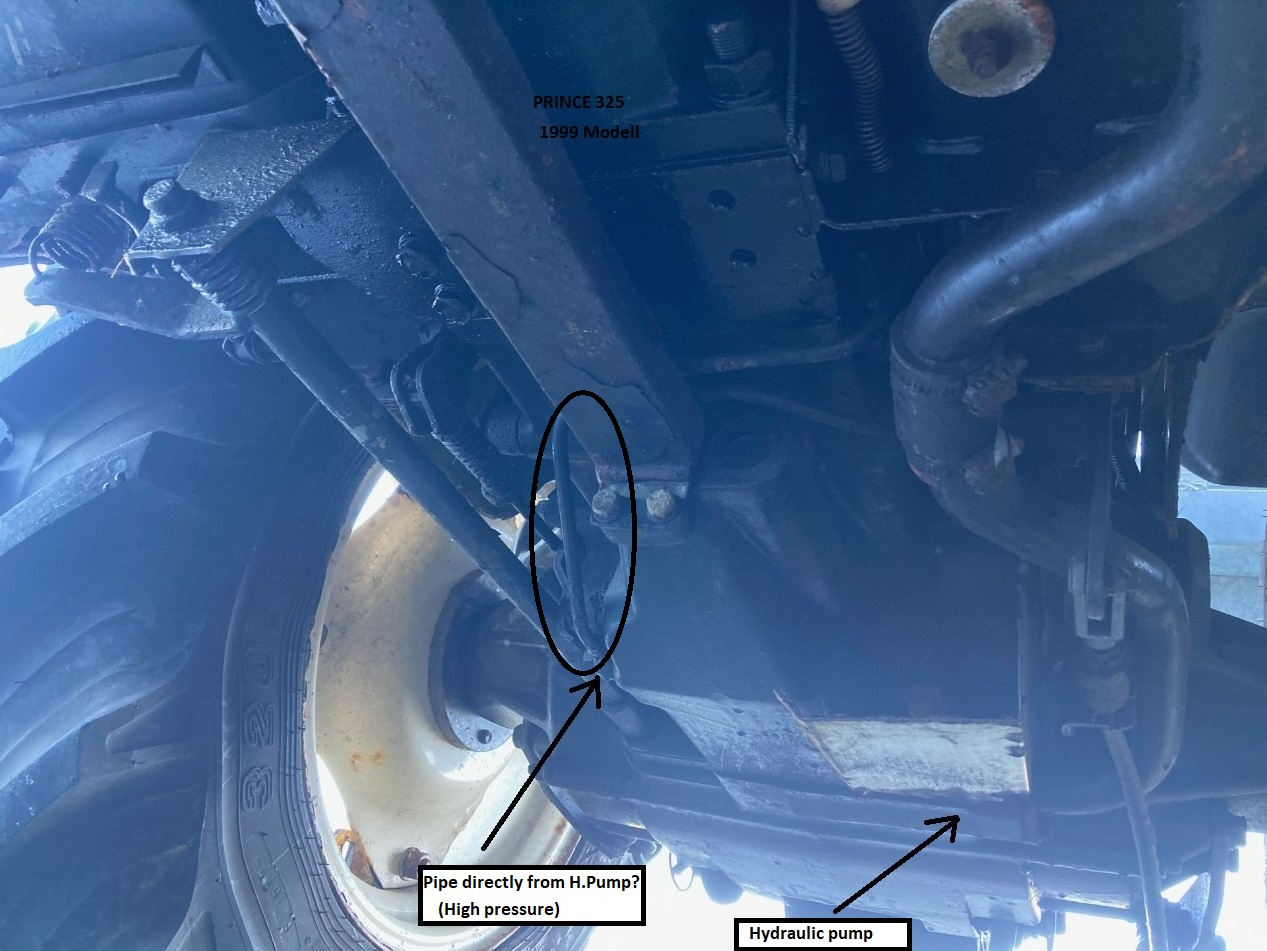

Hi!
I have a Hurliman Prince 325. 1999 model.
The tractor has only one hydraulic outlet.
I find this post very helpful, but I wish to ask some questions about the installation if you, or someone else remembered the answer to.
Im looking for the main supply from the hydraulic pump? Underneath the tractor i have found a pipe from the same area that the hydraulic pump got it oil supply. Can this be the main pipe from the hydraulic pump? (see last picture)?
Im looking for a place to drop inn and get hi pressure to a new control valve.

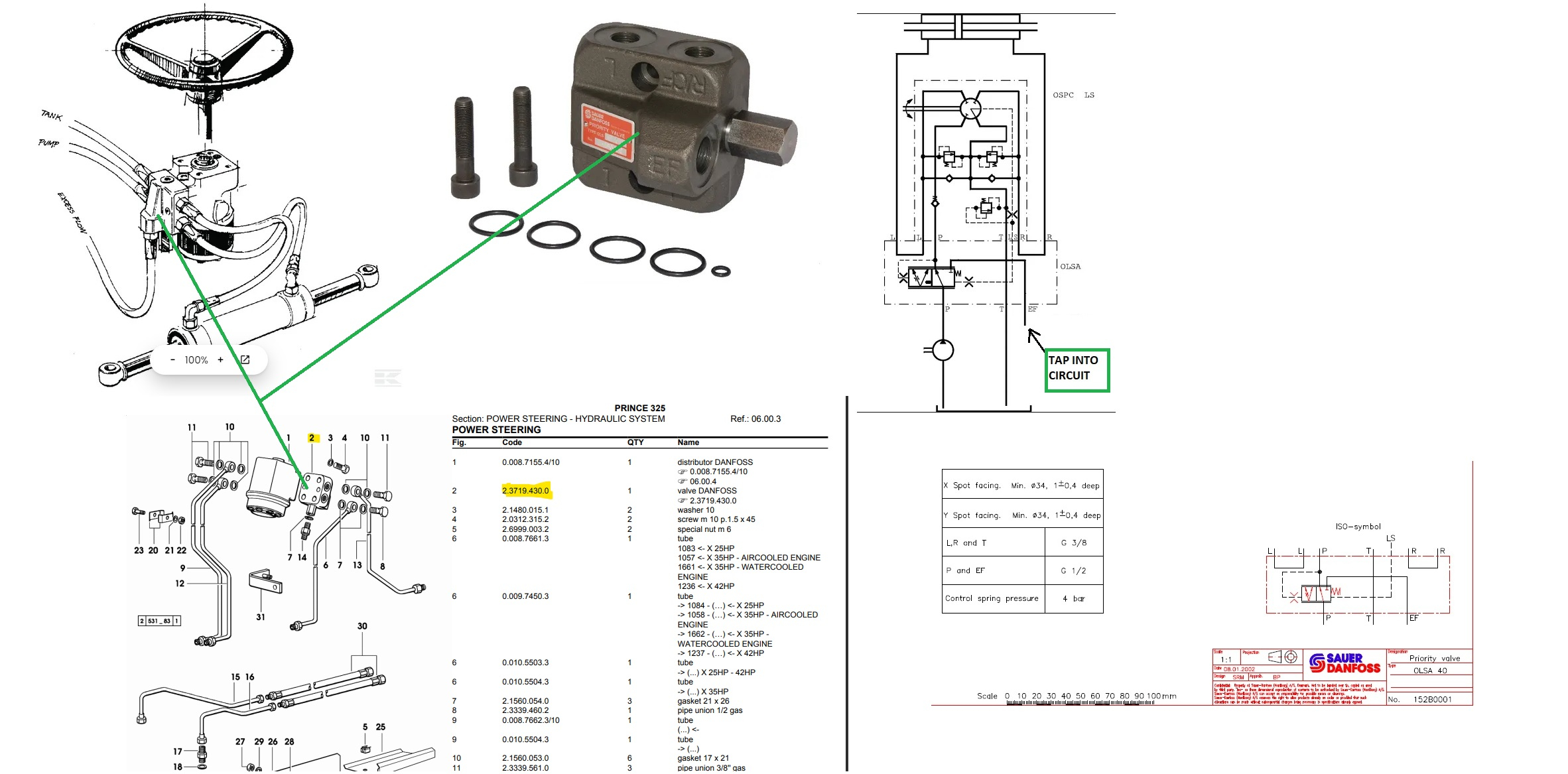

Amasonic
I tapped into the Power Steering priority valve as the high pressure source.
One could follow the output line from the pump and tee off of that, but then the steering would not be prioritized.

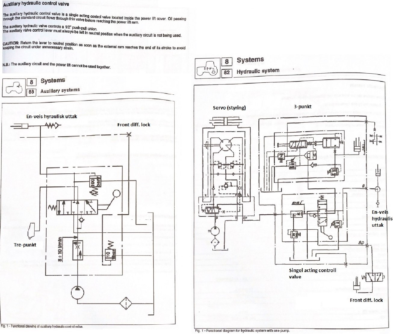

Thanks for quick answer CalG.
The Power Steering priority valve is located together with the Hydraulic steering control.
Now I know how to connect my future external hydraulic control valve (open centre) in serie with the rest of the hydraulic system. I will also drop in the "T" connection at the power steering priority valve for the "pressure relief valve" who is build-in the new valve-block.
Thanks for good answers! My work with the HJurlimann will proparly start in the summer. I will upload photos :)
