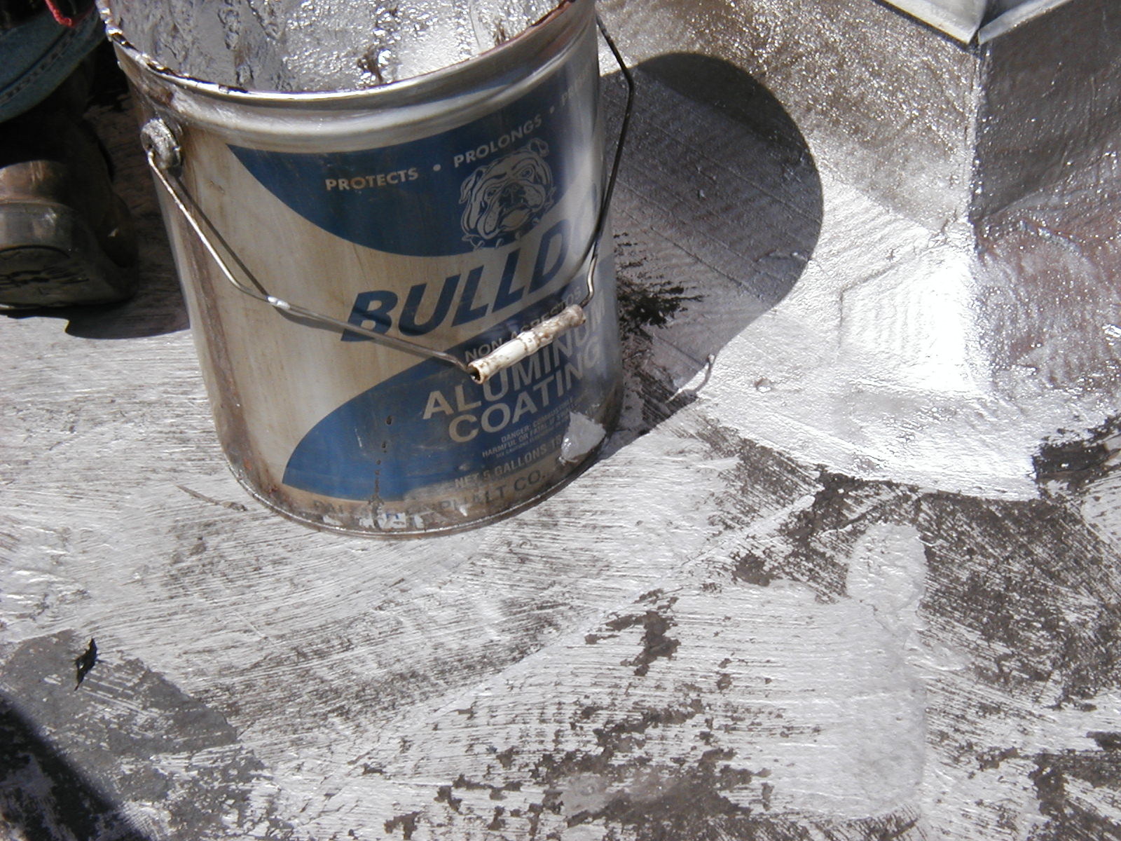

Will this Bull Dog coating seal the metal roof where nails are fastening it down on my pole barn?? It was constucted several years ago and the rubber washers are all but gone and it is showing small rust areas. Would this product be ideal for coating the whole roof or is there a better product??
John
It's not going to fill holes per say, you'd want to seal any holes or open seams with heavy body roof cement and fiberglass membrane first then it would be ideal for coating the whole roof.
The alum coating is a premium oil based product, when you start mixing it you will see the aluminum "solid particles" come up from the bottom, the higher quality stuff has more aluminum. some cheap stuff is more like just paint, the aluminum helps reflect the sun which is the greatest threat to any roof surface, the oil base helps preserve the metal and resaturate asphalt based surfaces.
Will need redoing every 5 years or so, whatever you choose, do something don't let that metal roof go away on you, I hate to see a metal roof neglected when a little coating would go a long way at preserving it.
I thought you'd get more response from agri type experience, my roof experience comes from commercial/ institutional, some residential.

After rereading your question if you only have "small rust areas" showing, I'm assuming you have a galvanized metal, no prob using aluminum coating on galvanized, but if it's only small areas around the fasteners then maybe you just need to seal those fasteners and touch up the other small areas of rust with a spray on galvanized coating which is also a premium product just for that application.
Might not need to coat the entire roof at this time.
I'm not up on those exposed fastener type applications so I'm not sure but maybe it would be worth it to replace the screws with new sealing washers?

My barn was built in the early 50's. When I moved here in the 70's it had some signs of rust. Coated with Aluminum Fiber Roof Coating. It has been done 2 more times since then. Last time a year ago. Seems to need it about every 15 years. Got it from HD. I think it was about $30 for 5 gallon.
Wear old cloths, boots and gloves. Plan on throwing them away after putting on roof. Your climate may require a different coating.<br>

Asphalt based aluminum coatings do little for a rusting metal roof and absolutely nothing for leaks and will often cause them to develop. They are simple products developed in the 1940s that did an adequate job on the heavier gauge corrugated metal roofs available at the time. They are good UV shields for modified and asphalt but that's it. They are made from an asphalt base, leafing aluminum pigments, a dessicant and cellulose (paper) fibers. More modern (1970s) metal panels are much lighter and more flexible. The fibered aluminum coating will eventually crack and trapped moisture will cause rust to grow underneath, gradually delaminating the coating and causing the rust to develop even faster. Worse, if there are loose fasteners, and there always are, the coating will crack sooner at those points because of fastener movement and cause the panel to rust out at the point of attachment.
Better to locate a modern metal roof restoration system. The most common is water-based acrylic (there are many quality levels) which requires a seam sealer, primer and two coats of acrylic. Water-based is permeable so in northern climates it will rust through eventually unless the primer is an oil based alkyd. Karnak and Palmer offer these but sell a water based primer which is inferior.
Better is a solvent based elastomeric coating like this one: http://rmlucas.com/TPS5000Mailer.pdf if there is already aluminum coating on the roof you'd need to use this one: http://rmlucas.com/6000.pdf
Stronger and more elastic than acrylic with near zero permeability. Seal seams & fasteners then 2 coats. It prevents moisture and oxygen from reaching the roof surface so there can be no rust reaction. You can use a phosphoric acid type rust converter if you wish for added protection.
Karnak has similar to the first but they don't have the second. It will turn yellow or brown if applied to asphalt or aluminum coating. Palmer Asphalt (Bulldog) doesn't. Kool Seal and the like for the trailer market is garbage.
If you want cheap use an alkyd metal primer (like rustoleum) the use the non-fibered aluminum coating. It goes on thin and doesn't last as long but it also doesn't delaminate in "plates" that trap moisture and kill you roof. If you go this waay Karnak or Palmer are fine.
I should disclose that (if you haven't noticed my screen name) R.M. Lucas Co. is my Company. Feel free to contact me with any questions.
