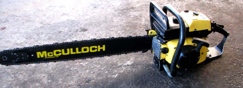

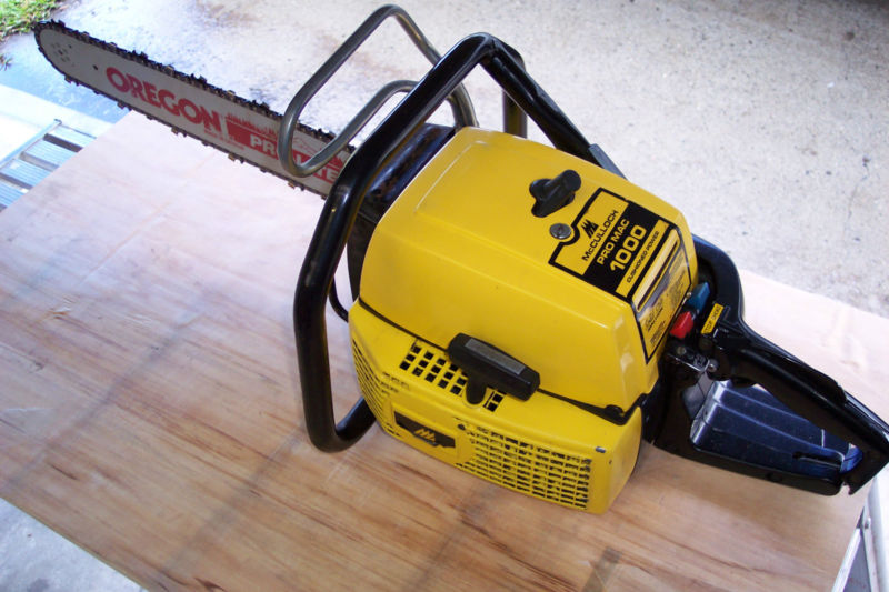

We own/operate all the above saws & more on our farms, & with 35yr+ professional rural chainsaw use & logging experience, like most I have favourite saws - unfortunately the US McCulloch PM850's/1000's became extinct in the early 80's, but then I'm not quite as fit as in the late 70's/80's to operate a .c10kgs/20lbs saw all day long...but I still keep a few in running order for occassional use like the PM1000 & PM805 below........
