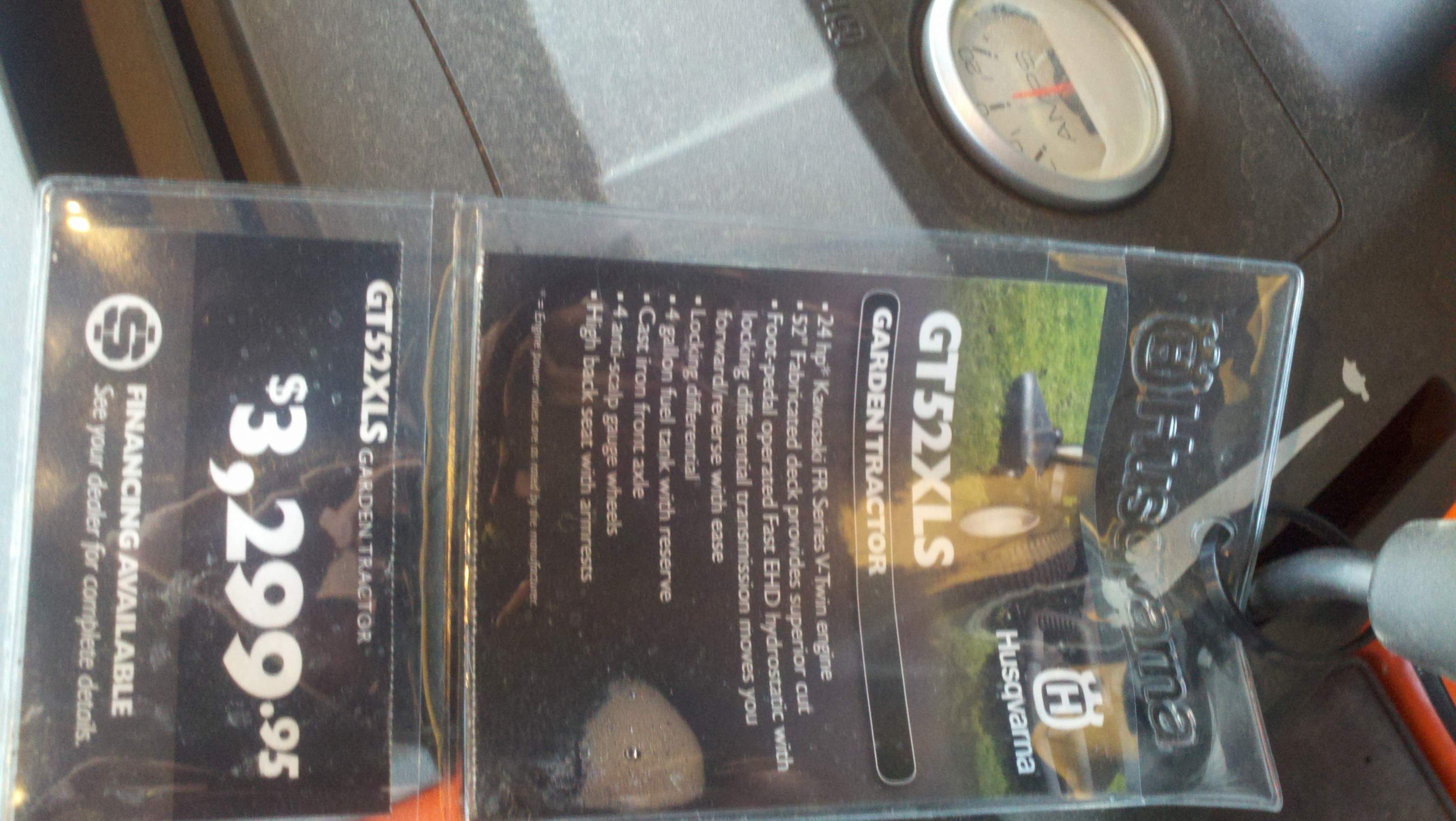

I know this is an old thread, but it discusses something I've been trying to figure out and that is whether or not the GT52XLS actually has a locking differential. I've seen conflicting information. Many sources on the internet, including those in this thread, maintain that the GT52XLS does not have the locking differential. But, I was at a local dealer the other day and took a look at one of those machines and snapped the picture that is attached. As you can see, the tag pictured (which was attached to a GT52XLS) claims it does have a locking differential. Does anyone have any insight? I'm truly trying to get to the bottom of this.
   / Husqvarna garden tractor - mass confusion. #8
It does not. All of them have an unlocked diff. Sorrily
