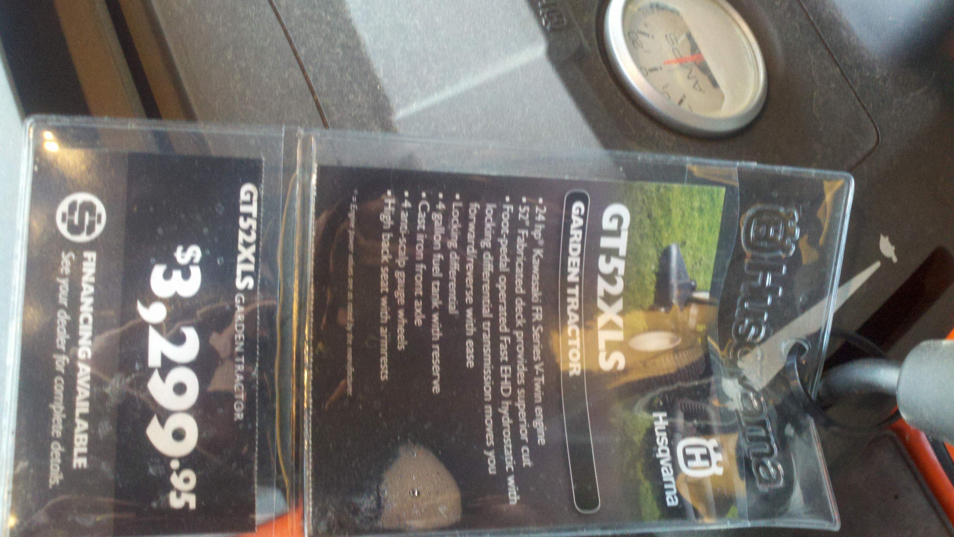

I know this is an old thread, but it discusses something I've been trying to figure out and that is whether or not the GT52XLS actually has a locking differential. I've seen conflicting information. Many sources on the internet, including those in this thread, maintain that the GT52XLS does not have the locking differential. But, I was at a local dealer the other day and took a look at one of those machines and snapped the picture that is attached. As you can see, the tag pictured (which was attached to a GT52XLS) claims it does have a locking differential. Does anyone have any insight? I'm truly trying to get to the bottom of this.
I am in the process of purchasing a GT52XLS also, and I noticed the same tag that mac2411 posted hanging on the tractor. It states twice right on the tag along with the actual model number that it has a differential lock... is it possible that it is a new feature for 2014? The Husqvarna website is still dated 2013... maybe that's why it isn't listed?
If not, I guess wishful thinking can't hurt!
-Greg
   / Husqvarna garden tractor - mass confusion. #13
The 2014 models that have the locking differential are the GT48/52xlsi. I have personally seen them both at a local dealer here. They also have the new keyless smart pad. The diff lock switch on both units is on the dash above the smart pad. The GT52xls does NOT have a locking differential, but it does have the higher speed tranny.
   / Husqvarna garden tractor - mass confusion. #14
Thanks for the info, blueJ, I saw the GT48xlsi at the dealer and saw what you are talking about. He now had the 2014 catalog that states no diff lock, yet the tag hanging on the tractor says it does. Must be just a misprint. Thanks again for the reply.
