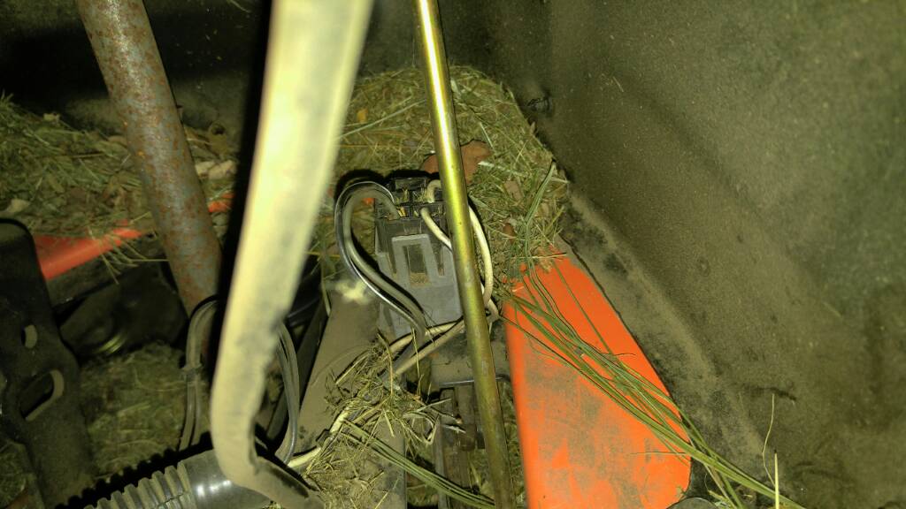

There is a wiring harness plug in left side under the dash. Take that apart and you might see that all ate up.
I just replaced the key switch, and it didn't change anything. The wiring harness that the key ignition switch plugs into looked good as new.
And how/why would the harness be "all ate up"? The mower is less than a year old. None of my other vehicles, tractor, or my 10-year-old riding mower ever had problems with wiring getting eaten by rodents. We have a lot of farm cats that live/hang around our back porch, so as soon as a mouse gets within 200 feet of our house, it's dinner.

I didn't say the harness all ate up, I said the plug in. I should of worded that a little different and said burnt up on the end side. The plug in I'm talking about is down close to the frame not the plug in for the switch.

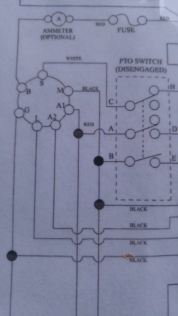

I looked at my electric schematic, in the manual, and put a jumper wire that basically shorts the brake switch. Went from one of the switch terminals to somewhere, will have to look tomorrow.
   / Husqvarna GT52XLS won't turn over - battery is good #17
I jumpered from my pto switch to solenoid white wire and bypassed.
   / Husqvarna GT52XLS won't turn over - battery is good #18

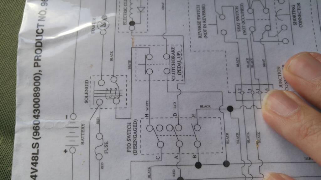

Heres how mine is. When key is held in start, you have power on switch S terminal (only hot during start) to the Pto switch (shorted when off) and rhen in series to brake switch (shorted with brake on) then to white on solenoid. I jumpered from pto switch H side (so i still have pto safety) to white on solenoid, basically jumpering the two white wires on brake switch.
   / Husqvarna GT52XLS won't turn over - battery is good #19
FYI The seat switch is not in the start circuit. White wire from key switch (start trigger wire) goes to the pto switch (pto switch must be pulled out) from there to the brake/clutch switch ( brake /clutch pushed down) then it goes to one of the small spade connector on the starter solenoid. The other small spade must be grounded for it to start.
