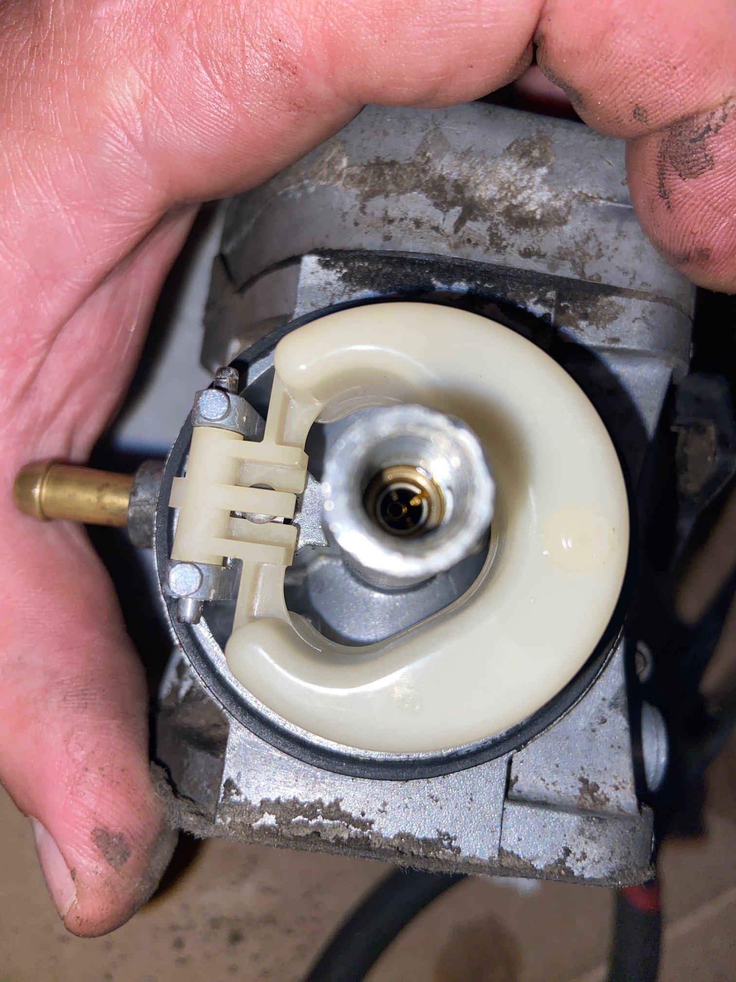

I did. Getting 120psi on both, and for a machine with 500+ hours, I think that's pretty good. Brand new NGK plugs and new coils...

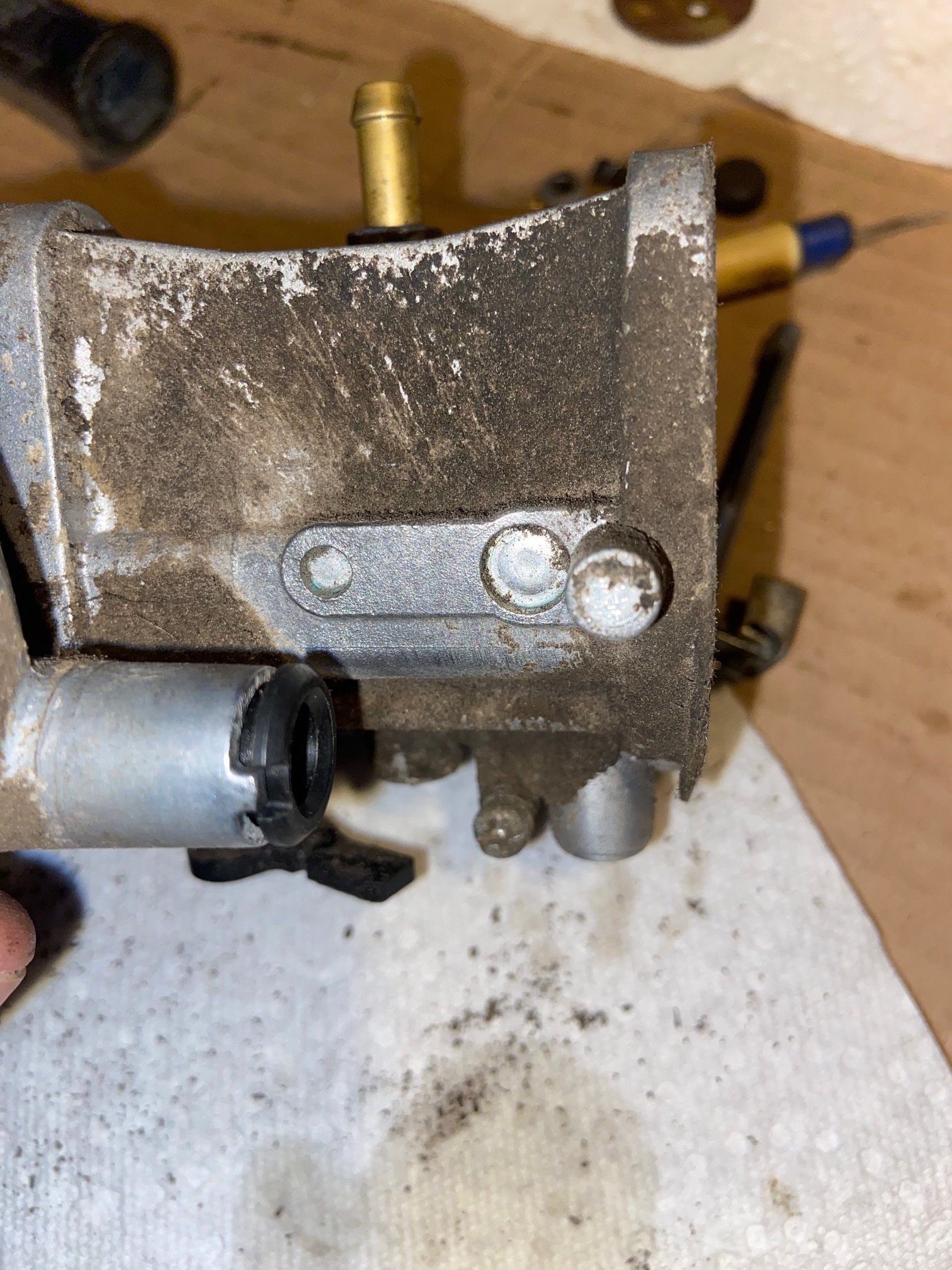

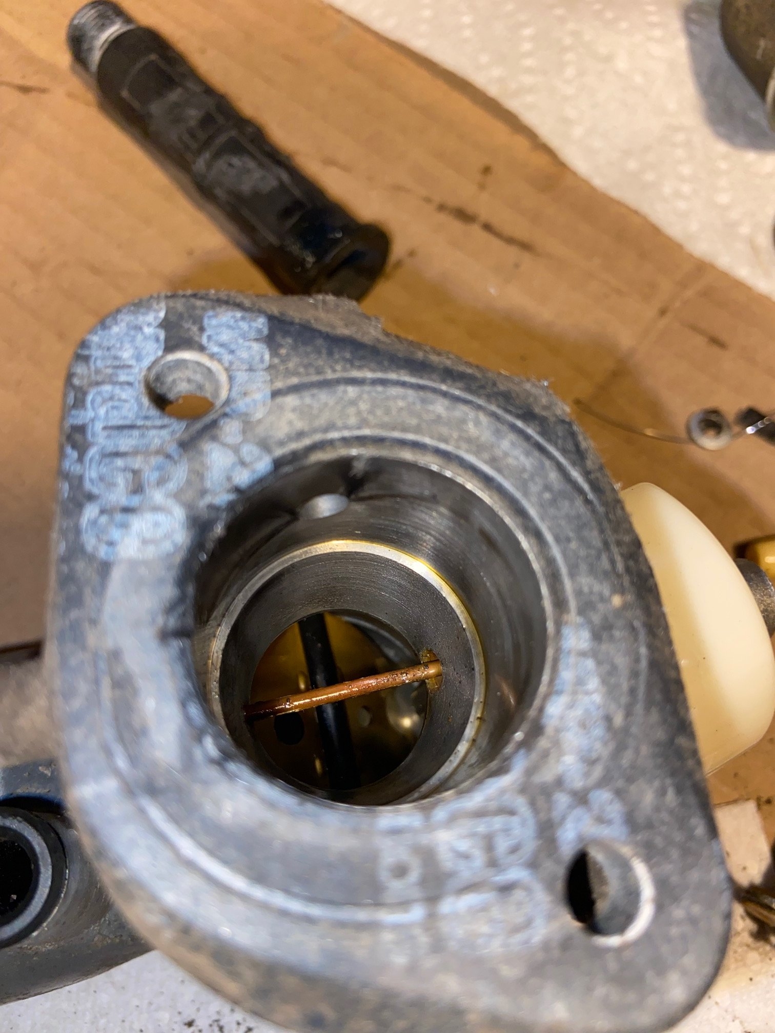

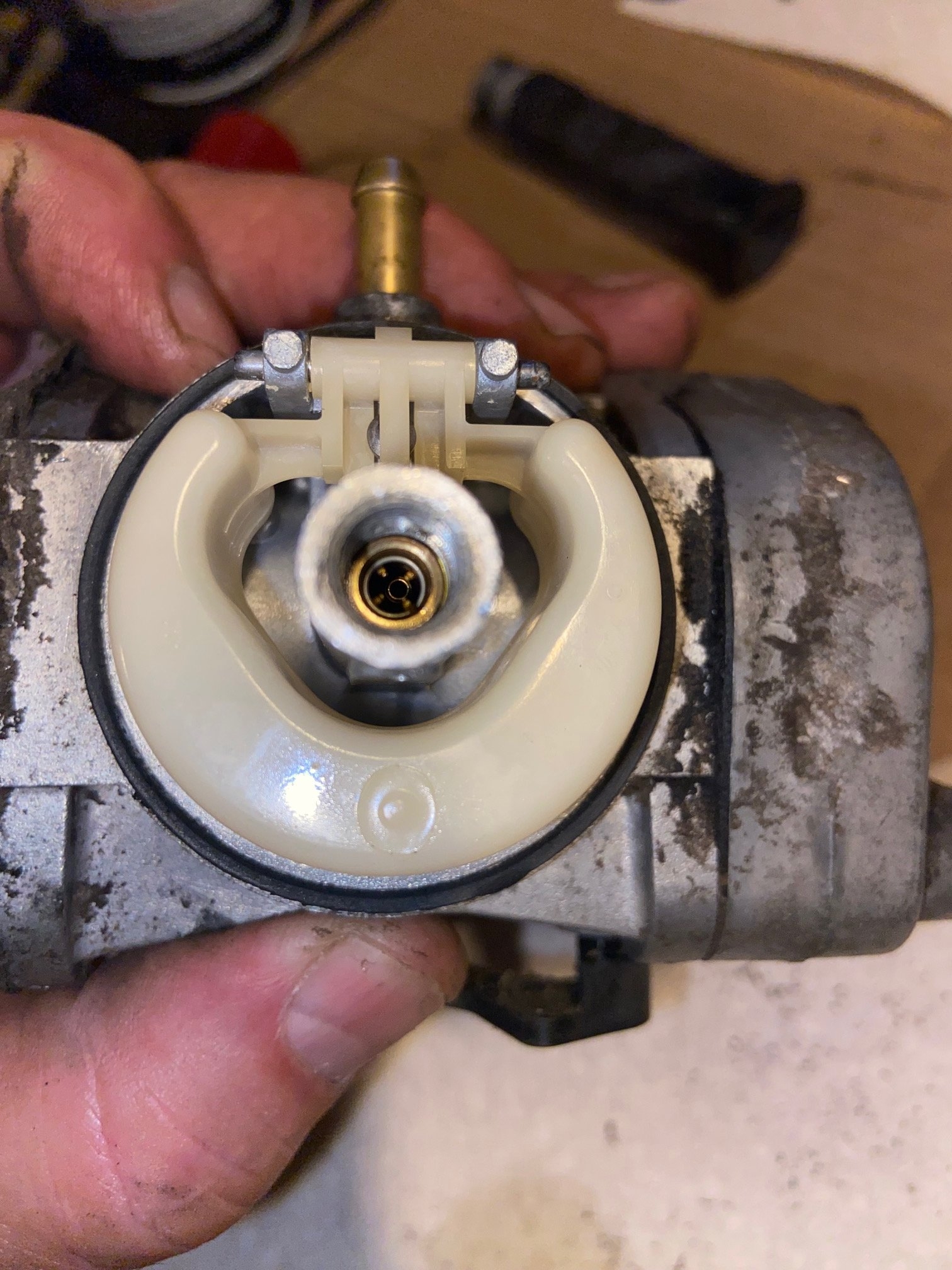

I believe my issue is the carb, specifically the main jet Nozzle. But this is the first kind I've seen that doesn't just protrude about 1/4" into the venturi tube, it goes all the way to the roof of the tube. And I can't get it out. I think I can see tiny holes in it that I'd like to clean out ...just not sure how I'm going to get at them. Anyone know how to get this nozzel all the way down through main jet tube. I can get it down about 1/4" but can't grab onto it to force it down/out.

Where is the float level in all of this? The tip of the float valve may be sharp, but is it fatigued? On your style carb, the best you can hope for is the pull the emulsion tube out with a hook. Have you dropped a piece of fuel line in a supply can from the filter and checked if it will run ?

Looking at the photos in post #12, I hope those are before cleaning, that carb is filthy.
Have you checked the intake manifold ?
The symptoms you are describing sounds like a loose intake manifold screw or a bad gasket.
