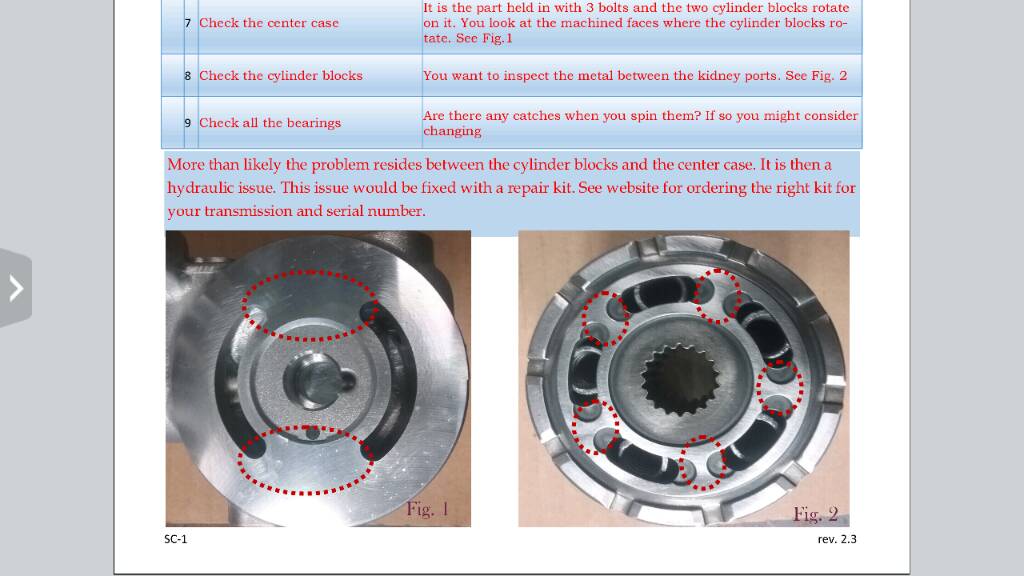

Tender Torq K46 trans is failing.
   / Husqvarna LGT 24K54 loses ability to go up hill #3
Exact same thing mine does, won't climb hill after it warms up. Needs transmission work.

Yaks! Quick search shows new Tuff Torq K46 units for $600 or so. I see rebuild kits for $225.

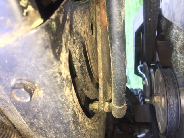

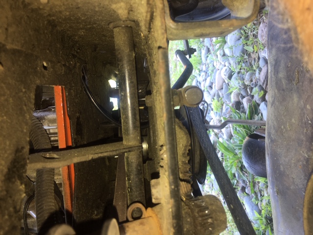

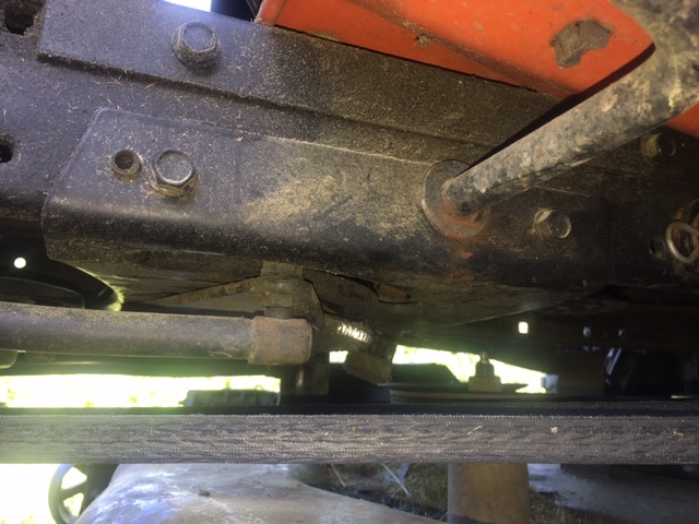

I'm not sure if your mower had the big lower steering shaft support plate. If it does,they collect a lot of grass and sometimes prevent the clutch / brake pedal from fully retracting, so it is like "riding the clutch". A good thing to check first.

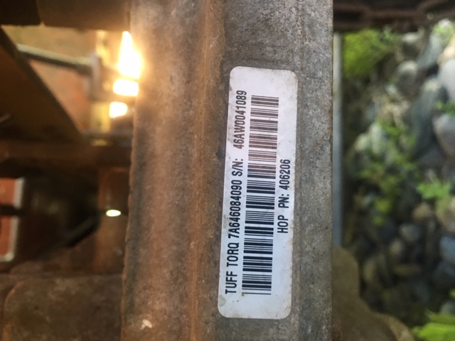

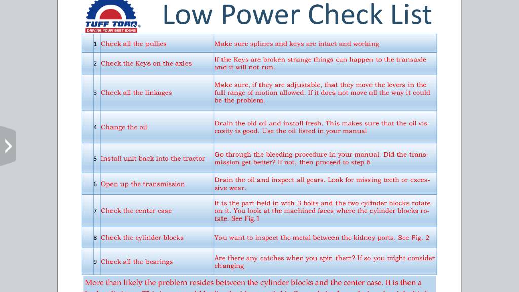

I think a new tuff torq is over $1000. I recently emailed tuff torq about mine, they gave me a list of things to check, attached.
I just replaced a broken axle in mine last yr, and posted pics somewhere on TBN of it opened up.
There is a serial number tag on the back of the K46 that identifies which k46 version. You need this when talking to tuff torq about parts, or you can go to website and look up parts.

Gator, great link - very detailed. Tom, not sure what size steering mechanism I have, but, it looked pretty clean in there. It doesn't feel like brake is engaged at all. Not sure if I mentioned, but, not only does getting up hills get tough once warmed up, but, backing up is pretty beat. (see pics)

So, it looks like I have a 46A?
