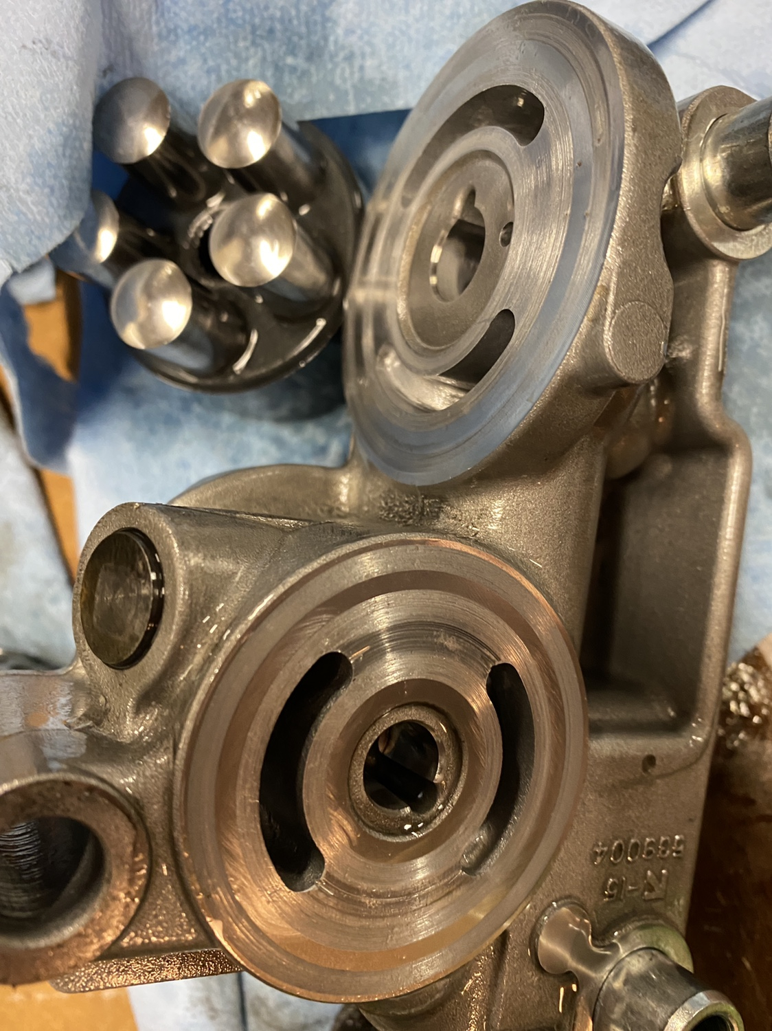

I am finally ready to do the repair/rebuild of my K46 and wondering if anyone has seen this package:
Seems like a better price than direct from Tuff Torq, but, curious if it has everything I'll need.
   / Husqvarna LGT 24K54 loses ability to go up hill #14
Don’t know if I mentioned it in this thread, but last year I rebuilt my k46 with a kit direct from TT. Kit looks like what you posted, however, with all the variations in k46 models I would not trust an eBay kit. Repair kit was in $500 price range, included new hydraulic pump and motor, the block they attach to, (the damage happens on the surface between pump, motor and block),
new oil, seals, etc. everything needed.

So, I rebuilt the tranny, with the kit I bought mentioned above from "Timberturf" on Amazon/ebay - Genuine OEM Tuff Torq Transmission Repair Kit 1A646099571 K46 L, M, W, AW | eBay . Pretty sure I followed the "directions" on all the videos I watched and reading "LotsofGreenGrass"s detailed post, filled tranny reservoir with the Tuff Torq fluid all the way up to about 3/4" from the top, capped it, reinstalled and ....NOTHING.
Didn't bolt wheels back on as I wanted to test it while up on jack stands. Actually, the wheels turned once, a revolution or two, but, nothing really. Wonder what I missed? I watched an hour and 13 minute long video that was incredibly detailed on a JD with a K46. Almost everything was 1:1 to my K46, (except for the IDS - mine doesn't have it). Interestingly, at the end of the video, the guy got a drill with a large socket and spun the shaft (that is what the drive belt spins when installed in machine). He did this a few minutes, forward and reverse. His axles spun immediately, but, did say this helps bleed out air. He made the "test spin" sound more like it was just interesting to see while it was on the bench. Wondering if that's what I didn't do.
When I spin the end of the axle(s) by hand, where the wheel bolts on, it just spins free & easy, on both sides. Virtually no resistance.
Any help is greatly appreciated. Thank you,
Jay
#20
I'm wondering if I screwed up when re-installing the motor cylinder block with that little metal "pin" that is actuated when you pull the release lever from the rear of the mower, so that you can "free wheel"? I did put a dab of grease on the pin so it would 'stick' in place and it was protruding slightly when I put the motor (with washer) back in against the Motor Housing, on that axle with the brake rotor on it... But, just where it seems like actuating the release lever, and re-engaging it - while spinning the wheel hubs - makes no difference.
Could it do this if it was low on oil? I did fill, as mentioned, to within 3/4" from top of fill-hole. But didn't bleed any air, didn't test spin the pulley shaft. Maybe, as the oil circulated through the internals of the tranny, the oil level dropped??
Sounds like I need to take the tranny out of the machine and back to the bench to figure things out - just hoping I'm overlooking something simple.
Thank you,
Jay
