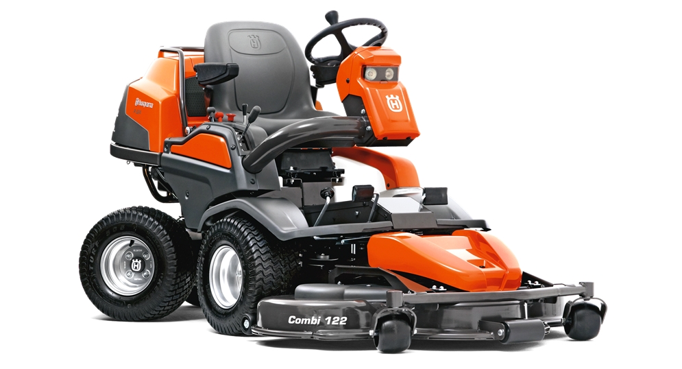

Was at the husky dealer and noticed a new mower in the showroom. Its a Husky R322T articulated. HUSQVARNA R 322T AWD - Riders Looks pretty interesting. Has the ability to add various attachments to the front like a sweaper, snowblower and a FLAIL!!!! mower.
AWD looks sweet. Seen a few videos online and they look quite stable on hills and pretty much unstopable.
Not sure on the deck. Metal looks pretty thin (well thin compared to my BX). .
Also not sure on the Briggs 22Hp Endurance engine. I know briggs has improved, BUT... And i think Ive been spoiled by my Diesel on the BX and the Kawi L/C I had on my X540.
Price was $5900 including the 3 bladed 48" side discharge. I think a rear discharge is available which might be better for mowing around obstacles.
Ironically, in Europe they offer a "Pro" series that has stronger components and Kawasaki power, with Diesel as an option... To bad they arent offered here, Id be interested.HUSQVARNA P 524 - Front mowers

I'm getting mine delivered tomorrow and I ordered it about a month ago.
They had some delivered stateside but it's been "stuck" getting modified / approved for emissions.
As a Swede coming to the US I was surprised to find that there's hardly any tractors with a front mounted deck,
(counts for +70% of sales in Swe) so when Husky launched theirs over here I jumped at the chance.
The engine in the 322 is the same as in the Euro 422 which is a commercial grade machine whith a $14K
price tag so I'm not worried about lifespan around my yard.
What is disappointing is the side discharge, most data online seem to indicate that you'd get a bioclip/rear discharge deck
and that's what I'm used to.... so if the deck doesn't convert into a bio/rear deck then I'd be forced to complain as their
datasheet says otherwise.

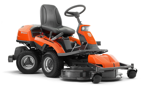

I've had mine for a bit over a month and used it a couple of times by now
so I'm feeling comfortable giving an relatively unbiased "review".
First off... if you're about to order one, don't make the same mistake I did
and just tell the store to go ahead and order one assuming you'll get the one
that all the information online is talking about (bioclip that is). You'll get the
side discharge deck which is the standard deck and apparently the only one
you can order (at least the only one with a part number in their sales material).
Yet none of the "features" listed online are optional except the combi deck....
http://www.husqvarnaretailer.com/PrintCreator/PCProductSheet/hq/451145/HEN2012-451145.pdf
Apart from the ordering mishap and an issue where the "brake" for the blades
fell off after the first time I used it, it's a very nice machine. Traction is
phenomenal, stability is great, feels very solid. A bit rough to start but I have a
Honda engine fetish so I guess I'm just spoiled.
I wish they had put on some kind of steering damper or servo because it's direct-wire
system is a bit rough on your wrists if you're using it on an uneven surface
as it tends to twist / yank the steering wheel as you go over bumps and rots.
Blades seem a bit "soft", I haven't tried to mow a gravel driveway and they still look
like I just did after only a months usage (probably cut the grass 5-6 times during that time).
//M
